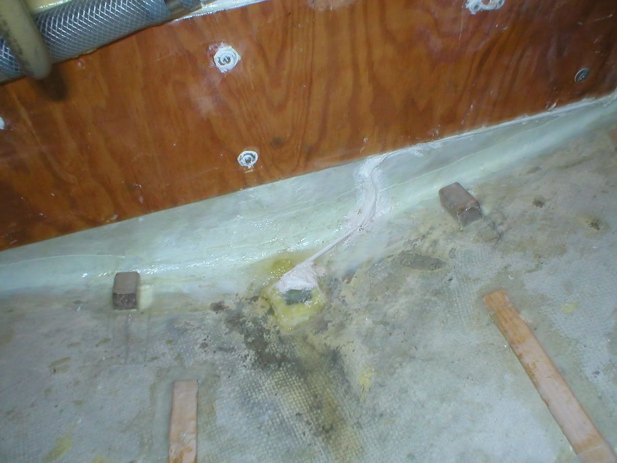

what are you doing again? sealing off the lazarette and adding an inspection port (from cabin into laz?)
On my boat I put some thickened epoxy fillets on the bulkhead, but I didn't glass off the rest of the bulkhead to the top, (but now wish I had). I used some 'great stuff' expanding foam insulation.

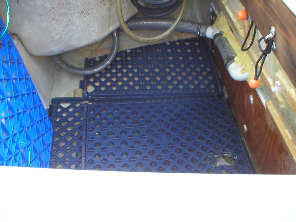

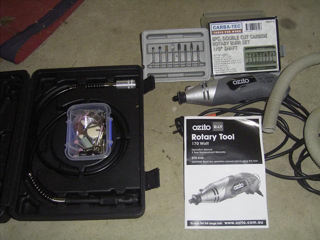

This is the final Dremel type tool I settled on. The tool itself is an Ozitio 170W with flexible cable attachment. In addition I purchased a set of CarbaTec carbide rotary burrs (with 1/8" spindles to fit the Ozito) and these have been ideal for cutting out the sections in my lazarette bulkhead to enable the insertion of gussets to block off the opening up near the coaming. The Ozito and burr set was half the price of going with a Dremel and one Dremel burr + the Dremel was only 140W.
The cutting of the fiibreglass only took a couple of minutes - the big job was cleaning up the fibreglass dust afterwards. In the attached photo you can see the end of the suction hose I had attached to the vaccum cleaner - it was a hose I have for the dust extractor on my RUPES rotary vibrating sander.
