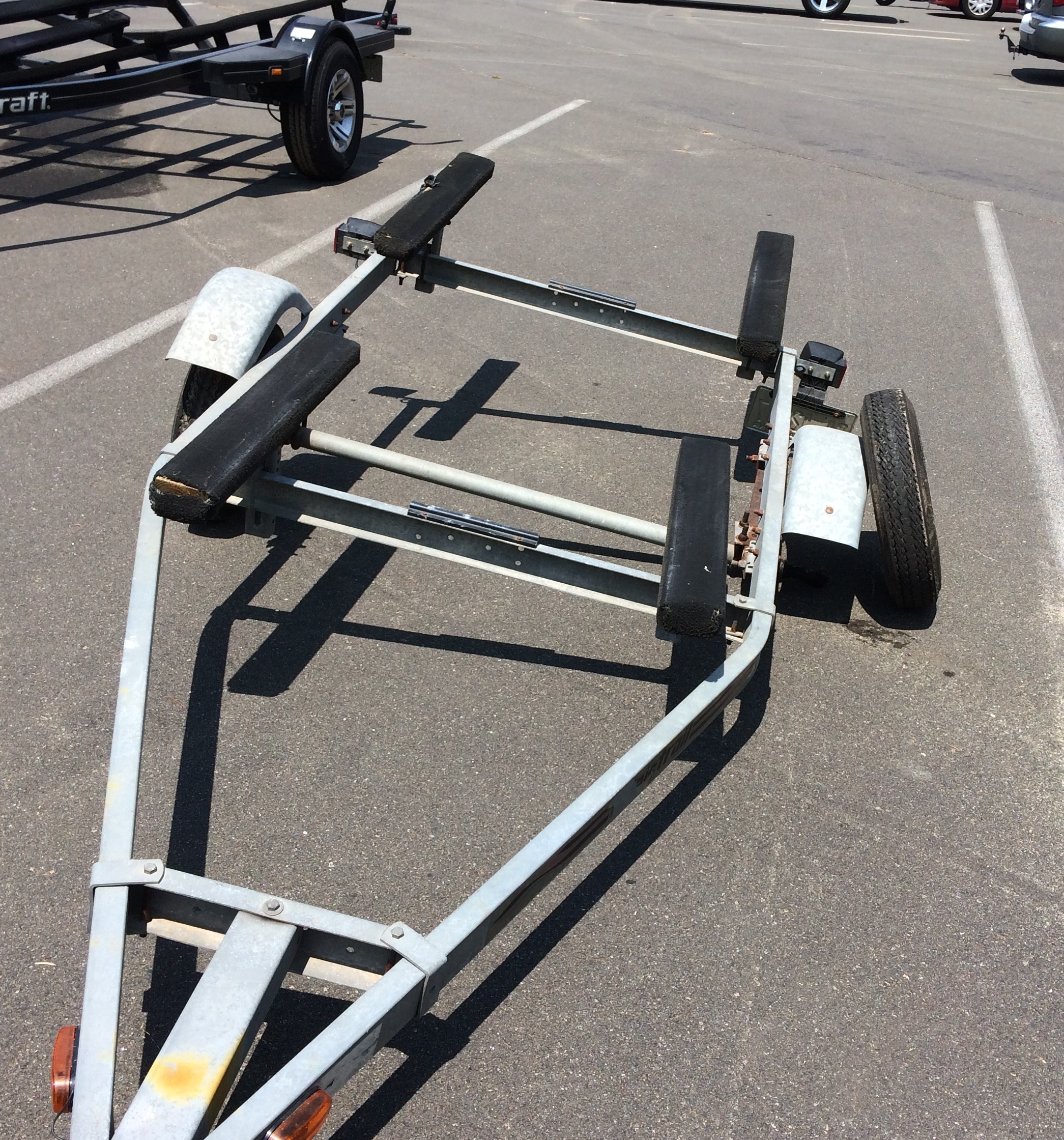

Been hearing some noise from our H170 trailer wheels for a while, never worried too much. Until this past weekend. Towed the boat on the highway for a few miles, pulled into a state park, launched the boat and parked the trailer. That is when the wheel literally fell off the trailer, right there in the parking space. If that had happened just a bit sooner it could have been a disaster, I hate to think what would have happened on the highway...
Check your trailer wheels today!
