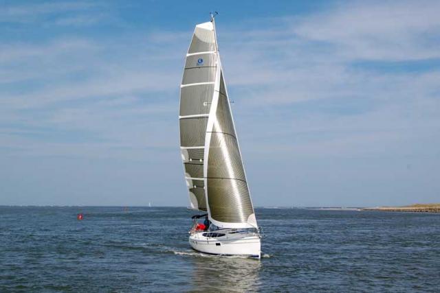

From your explanation it could be that your 16y/o sails may be blown out?? Hope not but the new sail package on the 336 is pretty impressive.

That's the new e36 in the picture. Nice looking boat. Not sure how long laminate sails last in the Florida sun though, think we'll stick with good ole Dacron :) Anyway, our sails aren't the best, but they're not the originals (as in 16 years old) either. Had them in the loft this past winter for a tuneup, and our sailmaker says the jib is pretty tired, but the main has a lot of life left. So at twenty knots apparant, I'm dumping the main like a mad fiend. I did ask the loft about a deep third reef, but I didn't know I'd need it just to handle blustery spring days, I thought it would be more of a storm at sea kind of feature. I hate the fact that once I take in a reef, I have no outhaul or cunningham to use to flatten the sail more, only the halyard and vang to tighten and twist off. One time last week in gust in the low twenties, our speed instrument read 8.34 kts. That's with a double reefed main, no jib, and a 7.2 kt hull speed. Wild times.
