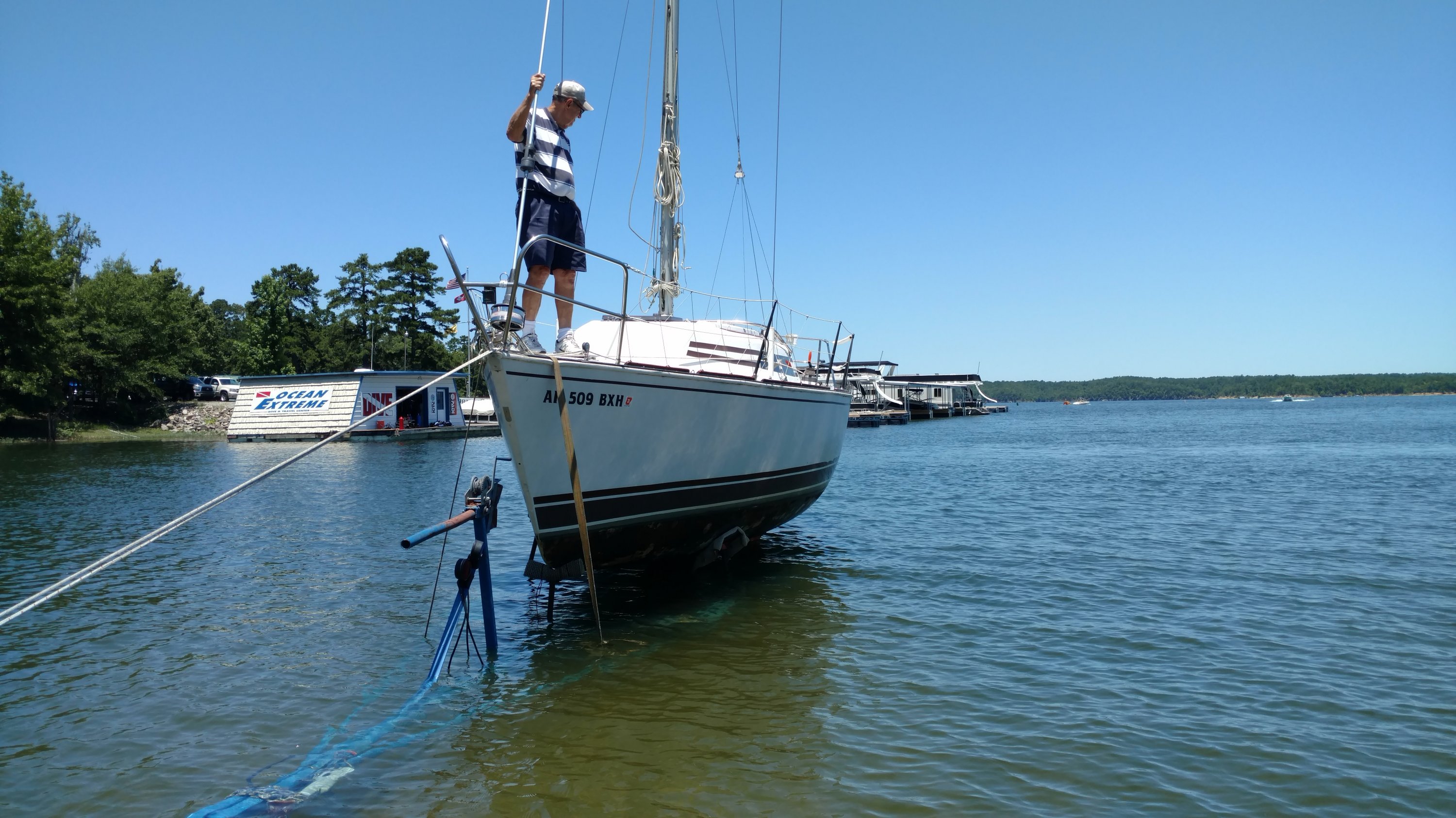

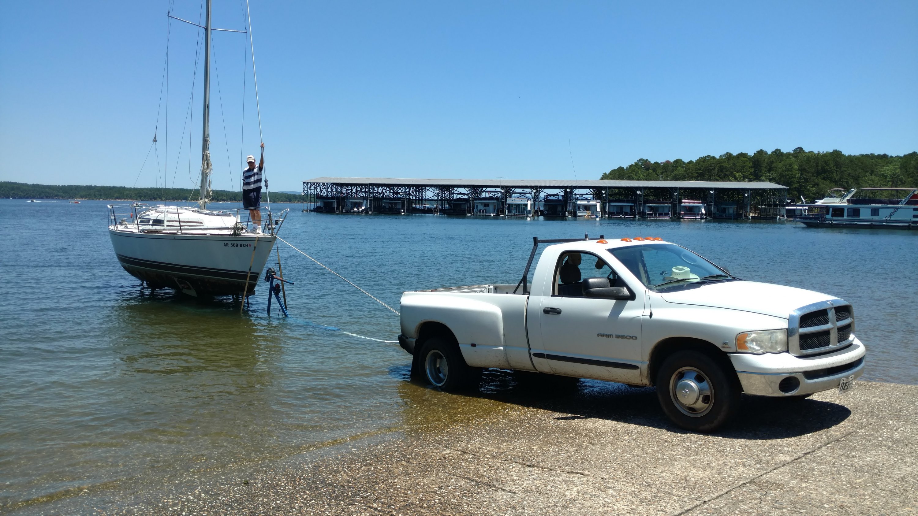

I finally got the boat on the trailer!!!
Randy that idea of using the winches with lines tied off to the tongue extension worked really well. We were able to pull the boat up onto the trailer. Saved backing the truck any further into the water.
We did have to get another truck to pull me past this point because of the algae growth on the ramp.
I was really surprised by this...
As you could see in the previous pic, the boat was level when we put it on the trailer.

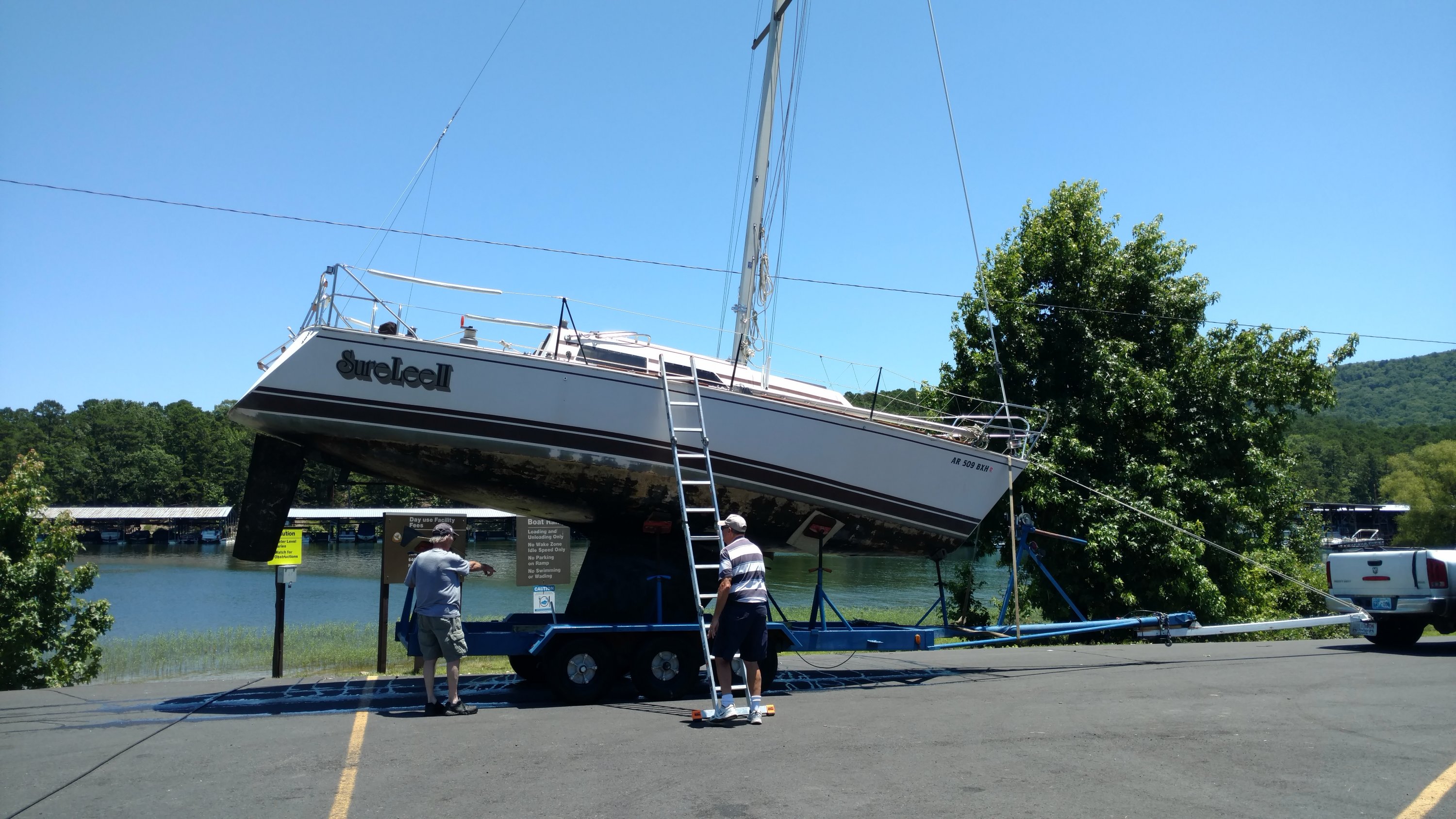

Now that I have the jacks adjusted to the boat, the next time I load it from the water can I leave them adjusted as they currently are? I imagine the boat will come to rest on only the forward jacks until I start to pull out. Then will it settle down on the keel and remaining stands?
May 6, 2004
196
- - Potomac
Yes, in theory it will work, as long as the trailer is on an incline before the boat. You may have to back it off once or twice to get it seated properly.
