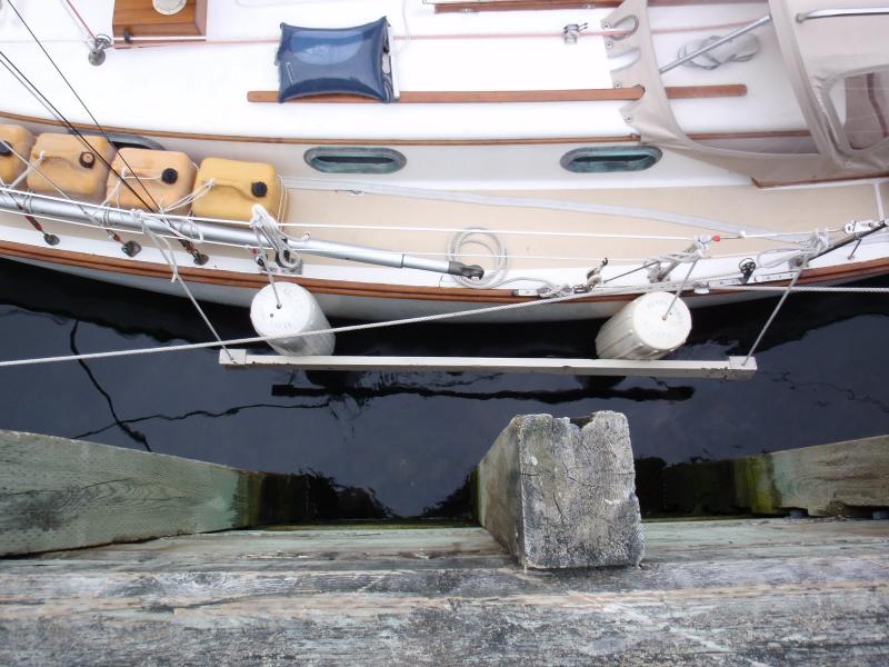

I think what u r asking about r called monkey boards or pinrails, they r usually, a really nice, piece of hardwood, and loose running rigging and haylards are held on them, very nautical, what u need is a pile-on dock board, between the stantions, I seen them made from 4 or 6" pvc pipe also and are deployed over fenders hangin from the rail. It depends on how fancy u want them... Red

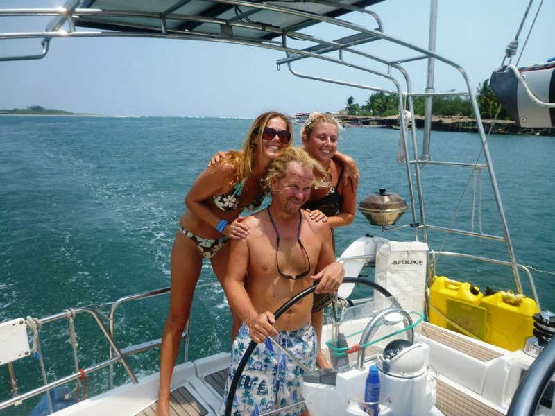

I lash mine to a nice sized space next to my arch.
That's four jerrycans with diesel. An extra 80 litres.
I am considering adding some more capacity for a couple of petrol jerrycans and maybe even additional water. But I am concerned about that additional weight against my stanchions. Especially if I get breaking water across my deck.
Anyway here is a picture showing the lashing, my jack stays were too long for my boat. I delayed cutting them to size and glad I did because the tails are just right to tie down the jerrycans with.
