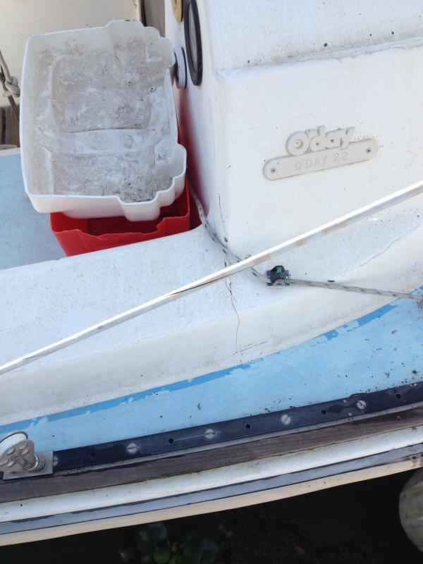

I have just recently purchased an o'day 22. She is in decent shape. Top side she is a little weather worn.
I have attached some pictures. (Hopefully) and I am not sure of what I should do to remove the dinginess and brighten back up
Do I just do a good remove oxidation (help on this) or a complete sand down and paint.
Also in one of the photos there isa small stress crack.
Advice please.

The white looks like it will clean up
The blue non-skid looks like it already has a coat of paint and will take a bit more effort

Before you do anything exotic, first try a solution of 1 pint bleach & 1/2 cup Spic-N-Span in 4 or 5 gallons of water. It has worked miracles for me.

I would be very careful using an abrasive like Comet on anything. A far better powdered cleaner is Bon Ami. It does not leave scratches like Comet does.
I second following Maine Sail's advice on gel oat care.;)

Yes... go at the topsides with Mainesails how-to. My 84 Pearson now looks brand new (short of scratches and dings the buffer will not take out). You might have to clean/degrease the non-skid and repaint.

As mentioned, the nonskid looks to have been painted before as you can see the original gelcoat blue nonskid beneath. To repaint this area, you need to completely sand off the old blue paint, clean it, tape the edges to make a crisp, nice edge and paint it with a nonskid paint. A simple paint to use is Interlux' Deck paint, which comes in blue as well as white, beige, gray, etc. It has grit in it, has a satin finish (you don't want a gloss finish as it is slippery when wet - even if it has grit in it) and it holds up very well under traffic. There are more exotic paints, but you have an older boat, not worth spending an arm and leg on. As far as the cracks are concerned, the only way to remove them is go grind them out, glass them up, smooth the repair with sandpaper or grinder, fair with fiberglass putty and spray gelcoat on the area, wet sand and buff out. Do not use epoxy resin, but use polyester resin. The gelcoat can be sprayed on with a Preval sprayer. The rest of the deck needs to be cleaned very well and then you can use fiberglass rubbing compound on the smooth parts to try to get a shine back. Then wax so the sun chews on the wax instead of the gelcoat. This will slow the return of the oxidation process down.
