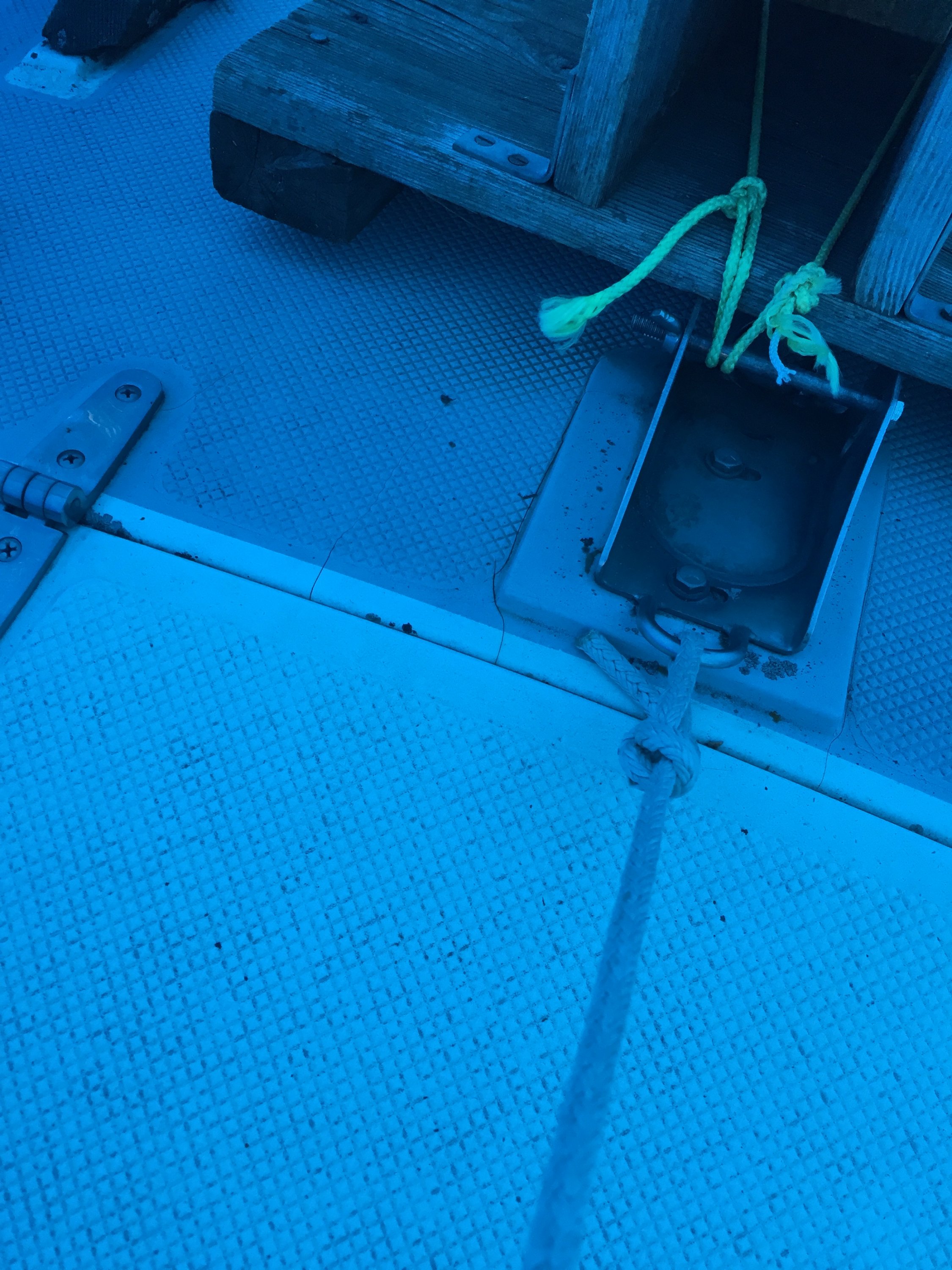

My questions: while inspecting this weekend, the hull seemed to be in good shape. No obvious patches or damage. No soft spots. Keel looks pristine. However, I did notice a couple of fiberglass issues that I need help with. Near the forward hatch I saw some cracking in the deck (pics attached). How bad is this? Is it safe to assume some water is working its way inside? Does this require immediate attention? How is this repaired?

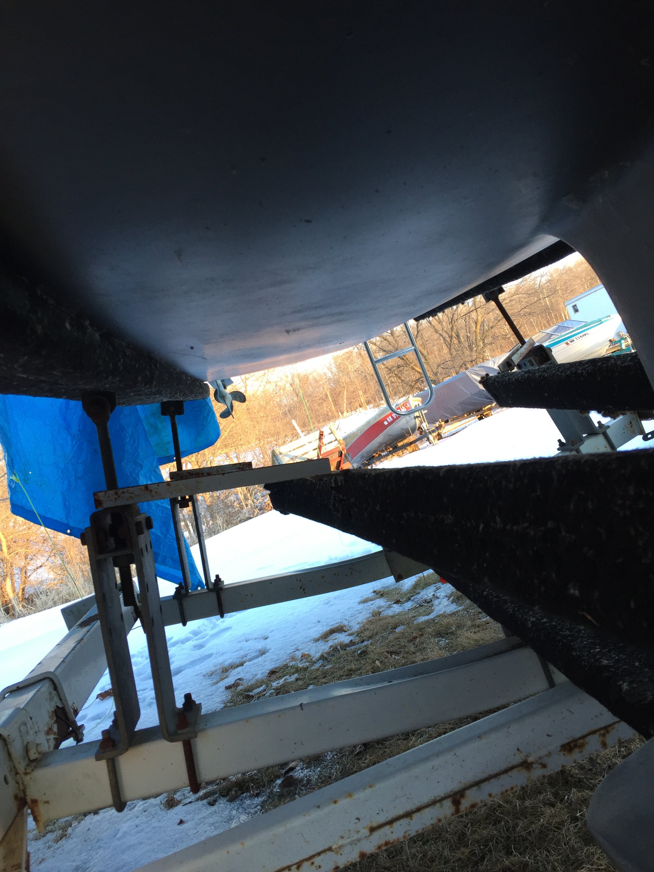

Also, while looking at the hull, I noticed at small amount “wavering” in the fiberglass on the starboard side, behind the keel (pic attached but you need to look closely). Is this common and just a reflection of the build quality or something more?

The cracks along both sides of the mast step could mean nothing significant, but they could mean a repair job is needed. Check the compression post and the structure of the boat on both ends of the compression post. Often, the compression post is sitting on a block of wood. If that wood gets water-logged, it can lose its compressive strength. The compression post sinks down, transferring some of the weight onto the deck. If that is the case, then reseat the compression post. You'll want to seal the cracks in the deck, too.

I'm not experienced with that boat, but those cracks look like fairly large stress cracks caused by movement and pressure on the step. As the potential buyer, I would assume those cracks go thru to the core.
$4000 for a 22' seems high. However, a good motor could be worth half that. The ripple along the bottom may never be any issue unless you plan to race. It could also indicate a cracked or rotted stringer or rib. If you tap the hull and deck area with a plastic screwdriver handle, you can listen for hollow and delaminated areas.

I had a crack on my 1986 Catalina 22 (which is a close cousin of the Capri you're looking at) that from what I can tell looks like it was worse than what I can see in the pictures you posted... seeing what the crack looks like going down into the hatch would be helpful... and important I would think in your purchase decision.
Anyway, the thread below should give a sense of what mine looked like when I opened it up, and what I did to fix it. Fortunately there was no evidence of damage to the core; and my epoxy repair has held up well. I ended up replacing the hatch gasket as well. https://forums.sailboatowners.com/index.php?threads/crack-between-mast-hatch-on-86-c-22.161299/

I have a 1989 Capri 22, so have some familiarity. The 1990 is also a first generation boat with stainless steel compression posts offset to either side of center, with a wood beam which bridges the area under the mast step (later, 2nd generation boats had a single center mounted compression post). From the cracks in the deck, it appears that the deck is flexing under the load of the rig. This would suggest the need to check the compression posts and wood beam, although it could be due to the standing rigging being mis-adjusted. If the mast step isn't sealed water can enter potentially causing rot in the wood beam, which in turn would allow the deck to flex. I would likely want to determine if the stress cracks are thru the laminate, or simply in the gelcoat. If thru the laminate you could have water in the core, which should also be addressed. Not a huge job, and certainly within the capability of the average DIY owner. It would definitely be a negotiating point.

I had to check my 1985 model because I didn't think the mast step was on a raised platform, but I see it is. Those cracks are a bit concerning, my boat has been well used but that's one area on it that's ok fortunately.
