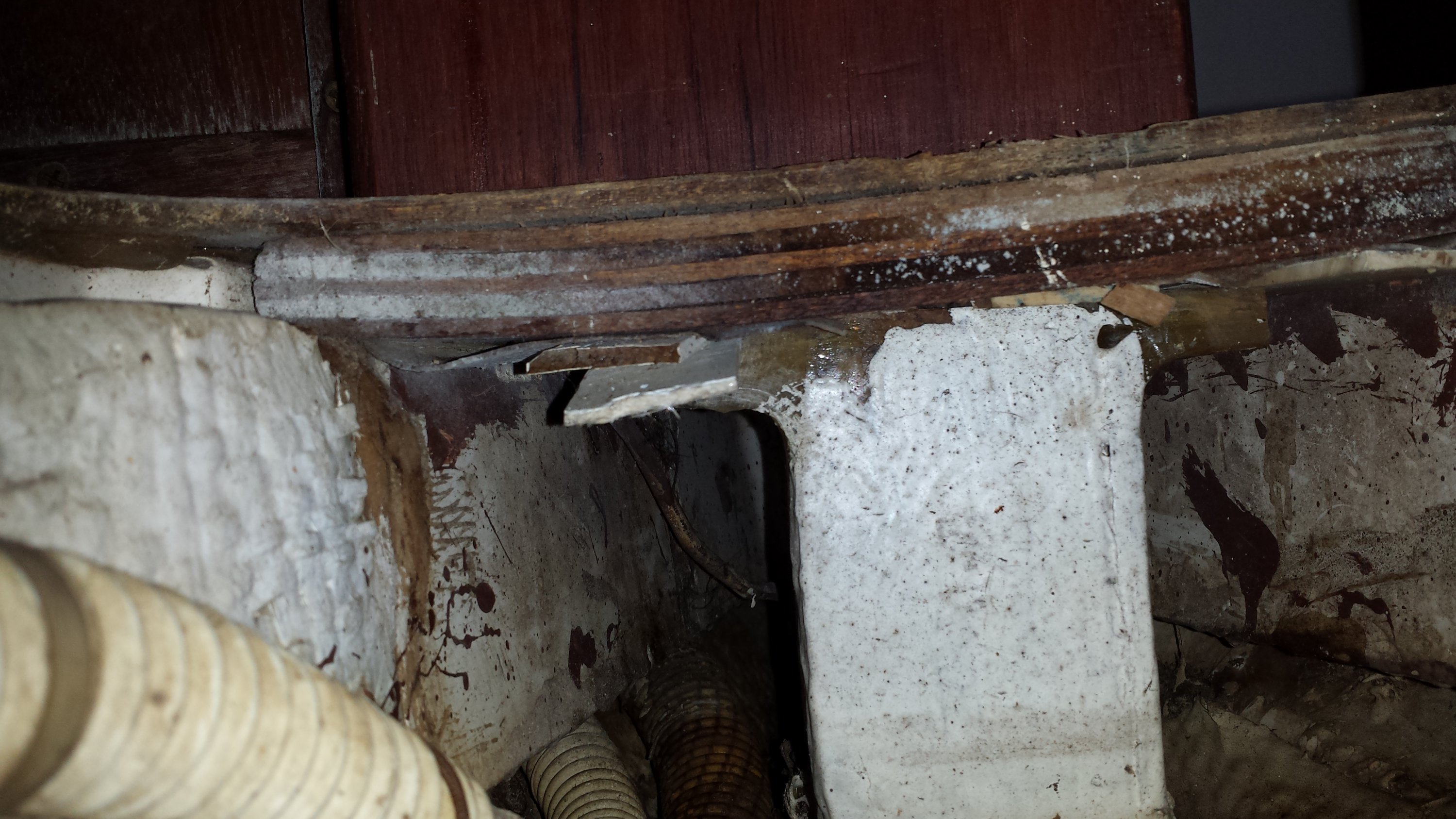

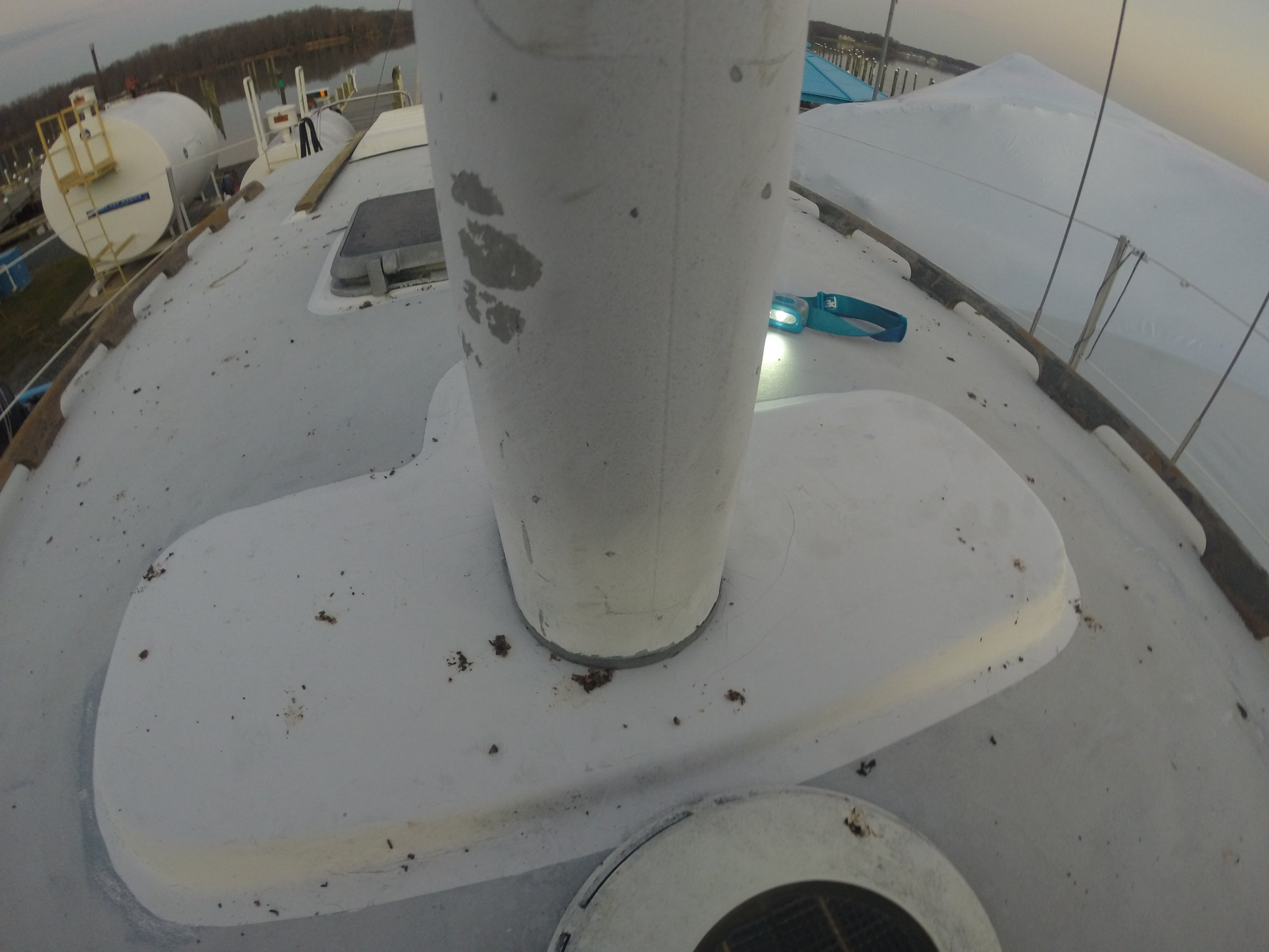

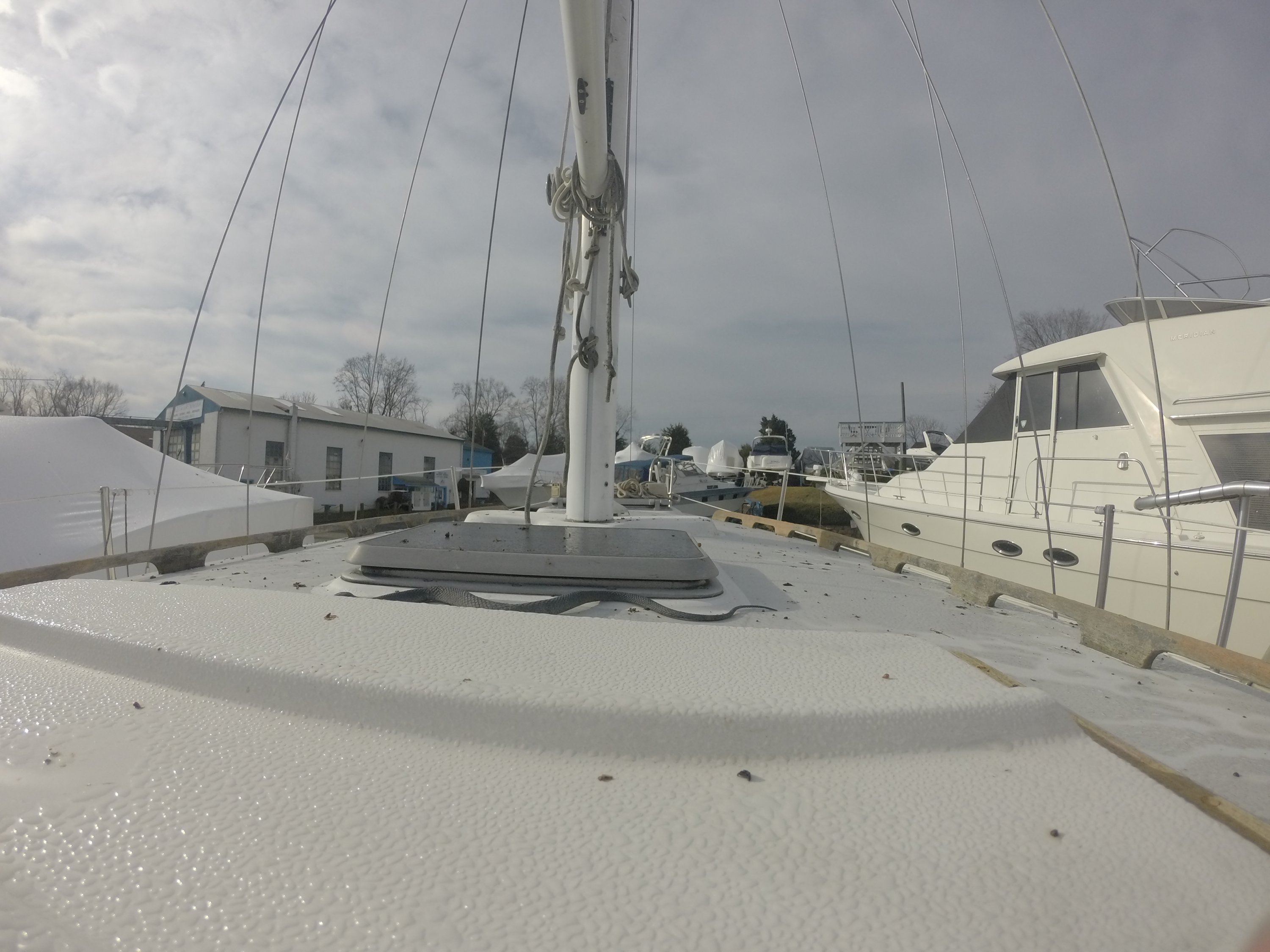

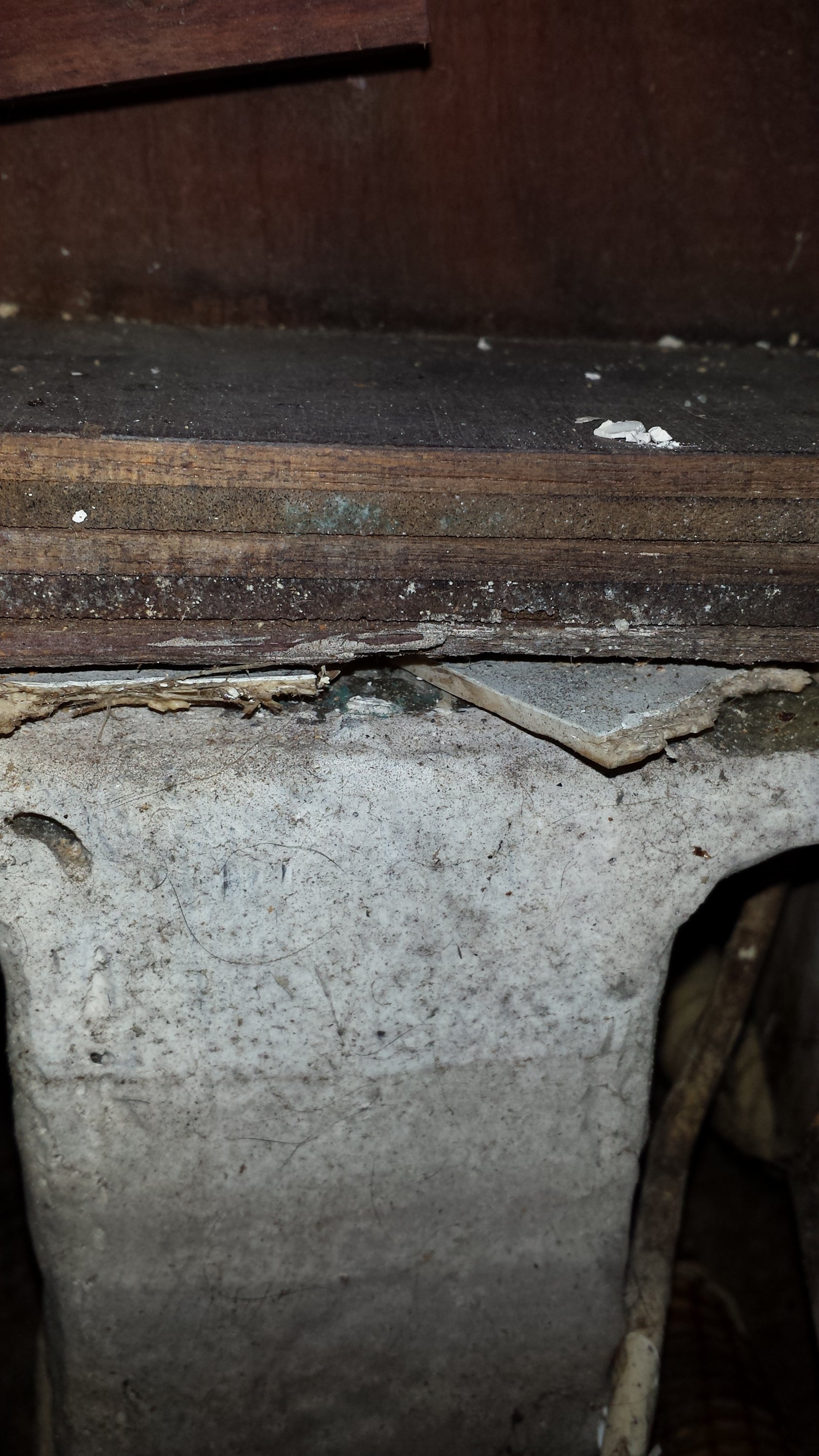

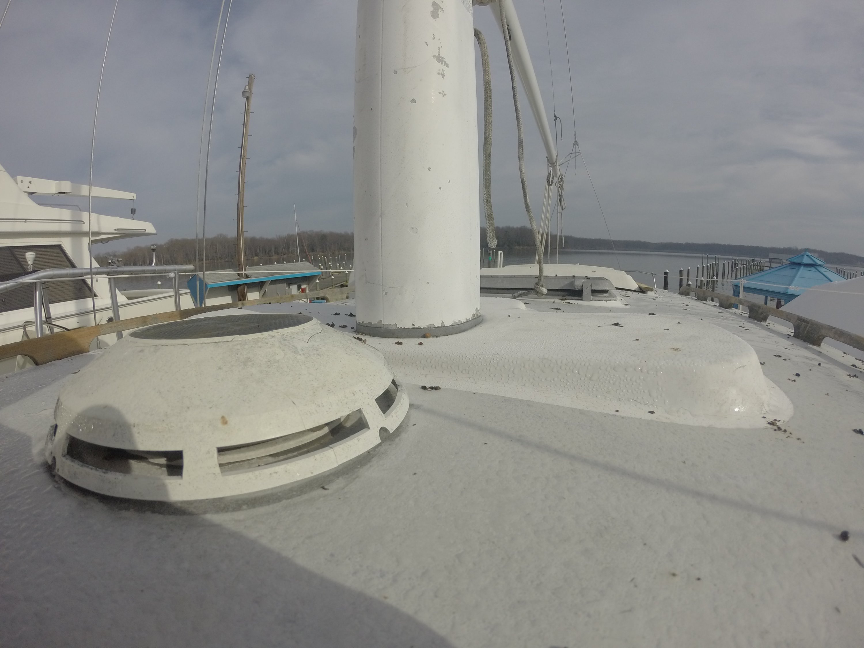

I purchased a 1979 Hunter 30 a few months ago with plans of learning how to sail. I have always had power boats but finally realized the gas bill for cruising was just too much. My new, to me, sailboat has plenty of cosmetic work that needs to be done but so far I haven't found any real issues of concern. I sailed the boat down the Potomac for about 15 miles to a Marina that is letting me do my own work. Sails worked and didn't notice any obvious issues with standing rigging or mast. Running rigging will need to be replaced and I will probably have someone inspect the mast step as it does look like there is a depression around the base of the mast (not sure if that is normal or if that is a symptom of a soggy core). Amazingly I was able to get the old Yanmar running with an oil change and a fresh set of fuel filters after not running for at least 7 years. With the boat out of the water and several hours of pressure washing (this thing was covered in mold) I have yet to find more than a few small blister..and none below the waterline. I have pulled out the old head and will be putting in new proper seacocks. I am going to; sand the bottom and re-apply bottom paint, prime and paint the deck and hull, rewire basic safety systems (bilge, nav lights, vhf radio).
