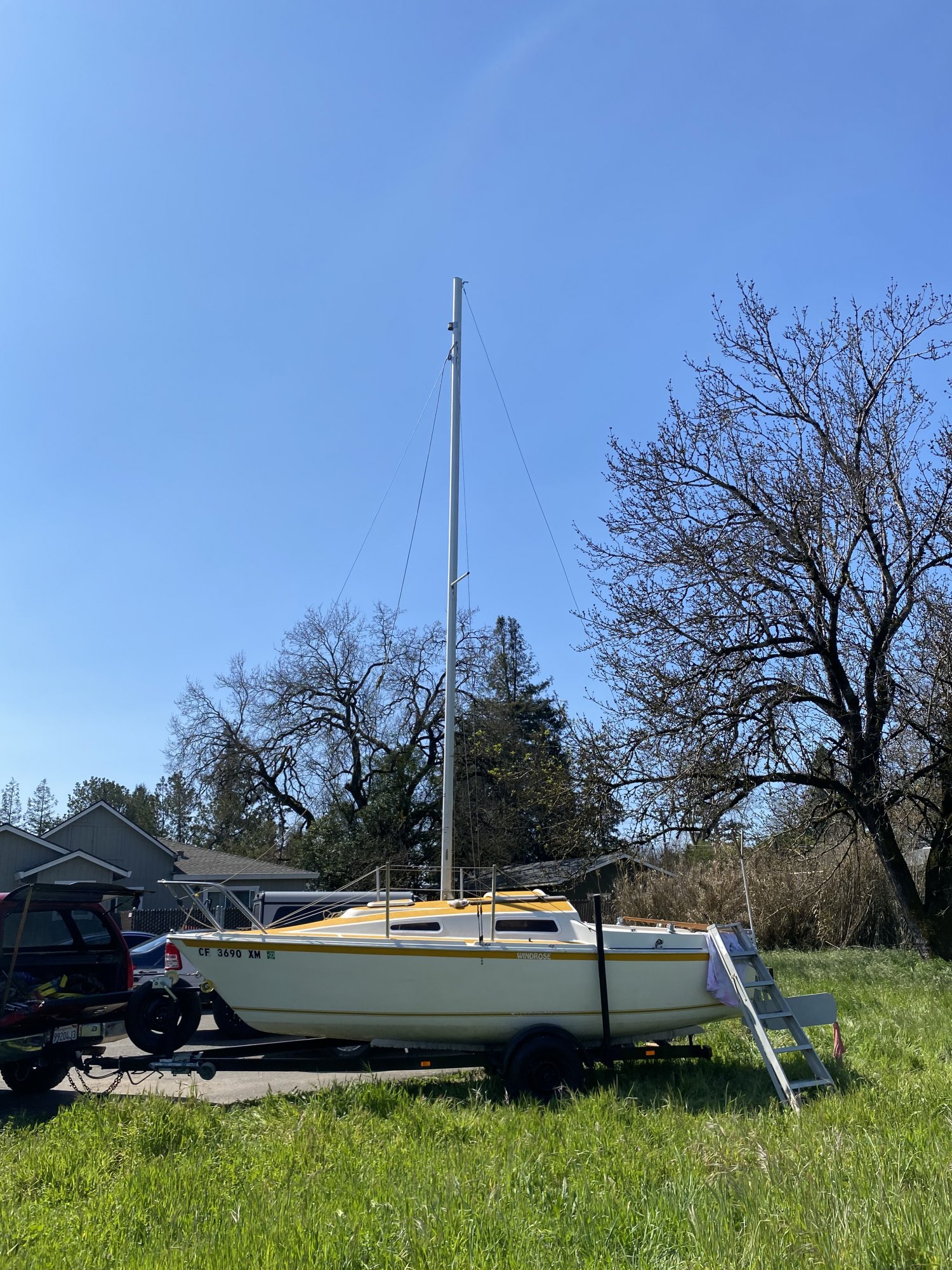

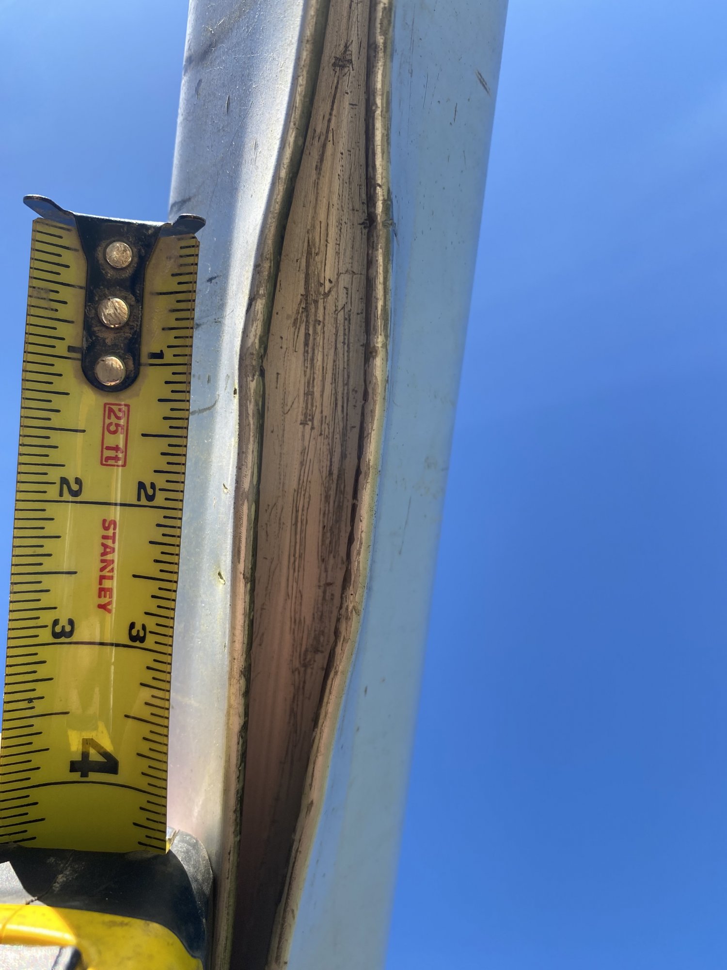

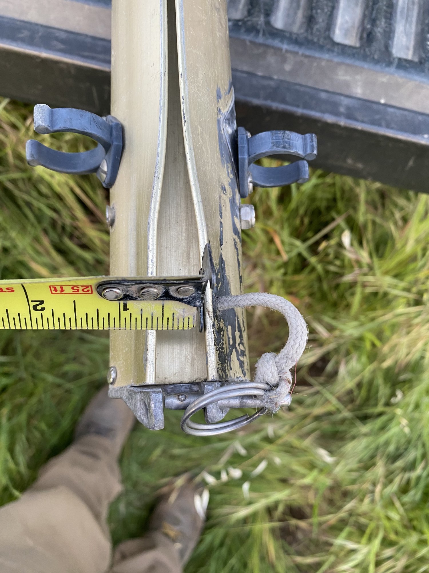

I just made the leap a few weeks ago and purchased an 18 foot Laguna Windrose 18. The hull seems to be in decent shape and the trailer is solid. Im not great with money so the price was right and ill be able purchase the rest at reasonable intervals avoiding wallet shock (probably not). The boat came without a boom or main sail. The mast from what I can tell is the original and is around 23.2 ft. in length. I went to a local yachting store and purchased a boom that is 8ft (roughly same shape 2.5''x3'' Elipse or teardrop), original would have been 7.5ft if my research is correct. My question (thank you if you have read until this point) is what are my options for buying a sail? does the foot of sail need to be all of the 8ft boom or can it be shorter? I found a website that leads me to believe I can purchase a brand new main for my exact boat windrose 18 see link here
Windrose 18 - MZC Cruising Mainsail - Charter | MAURIPRO Sails alternatively I found some used sails but the dimensions arent very close to the E= 7ft and P=20.What type of things can I do to run A shorter sail? say like a 16.5 by 7.5? Im as green as it gets when it come to sailing but I have been in and around water my entire life and have been fascinated by sailing. Any help would or advice would be much appreciated. I am going to attach a few pictures.

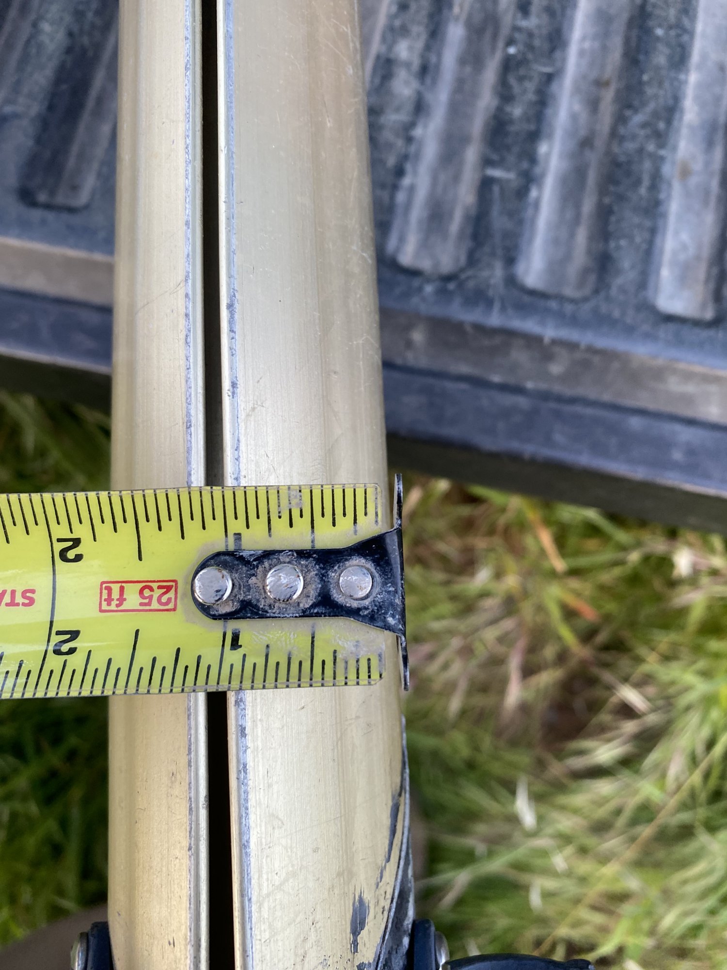

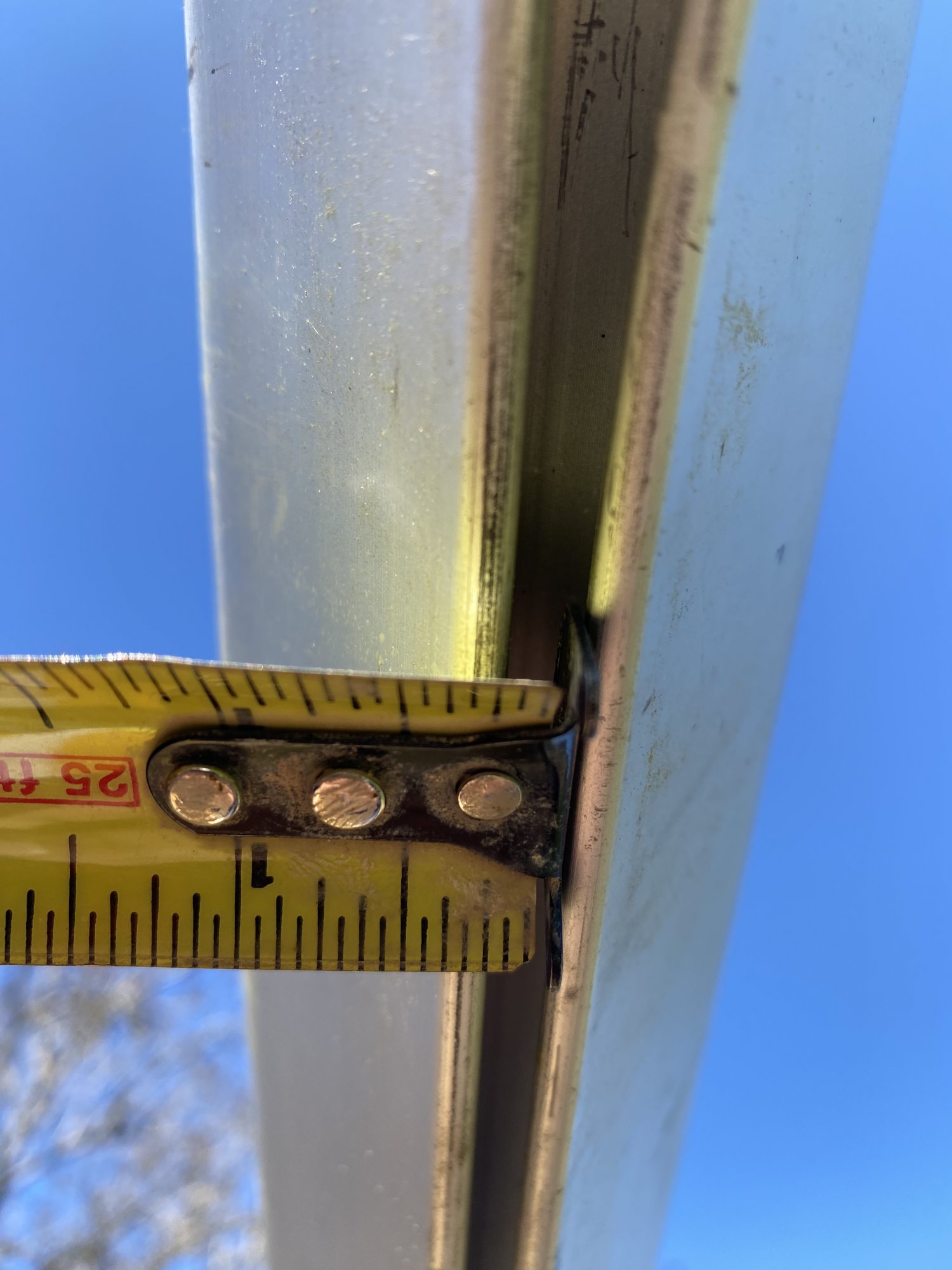

Slide opening in Mast= 3/16 or 1/4 see photo Mast is 23.2 ft Main Halyard block/pulley is mounted just below the top im guessing its at 23.0
Slide opening in Boom= 1/8 Boom is 8 feet long

Have you tried rigging the boom yet? I would be worried that the longer boom is going to hit the back stay when you tack. If it turns out the boom is too long you can most likely drill out the rivets on the end cap of the boom and hacksaw off a few inches of the boom until it clears the back stay.. put the cap back in the boom and re-rivet it in place.

Thank you Don and Thank you Rgranger. I have not tried rigging the boom yet(picked up today), waiting for the gooseneck(ordered online today RL 252 Luff Groove Roller Reefing Gooseneck) I was told at the shop this one would get me pretty close. I think ill need to find or fabricate the small cube piece that goes inside the coupling joint on the gooseneck. I will check clearance of the boom from the stern stay tomorrow, any excuse to step the mast is fine with me im still in awe when I look at it with the mast up. If the boom doesnt need to be cut down I think ill take your advice don and try and get my hands on this sail (specs below). how much space to spare is normal on a boom? if boom is 8 can the foot of sail be 7'11'' ? Thanks very much for any input.

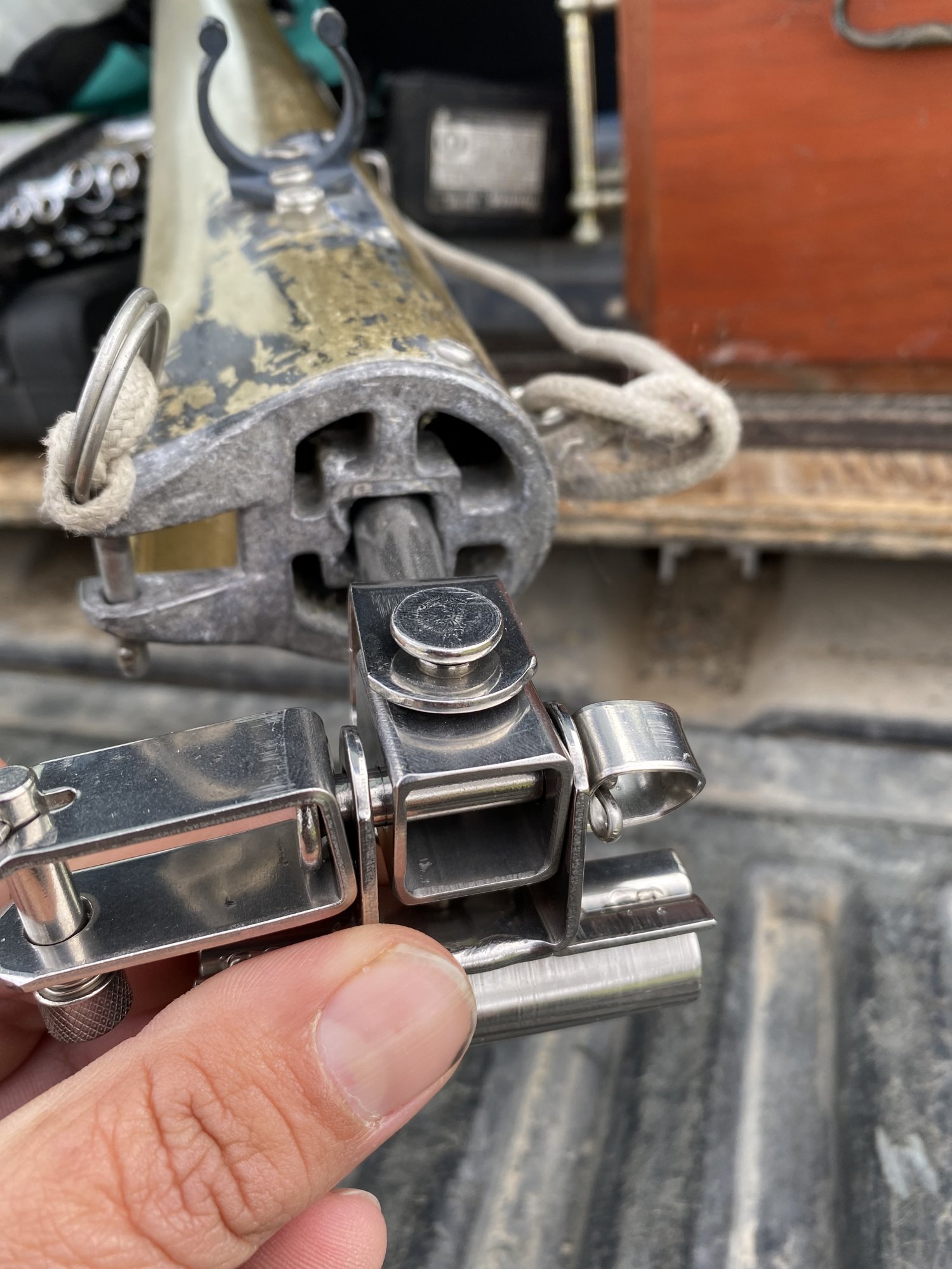

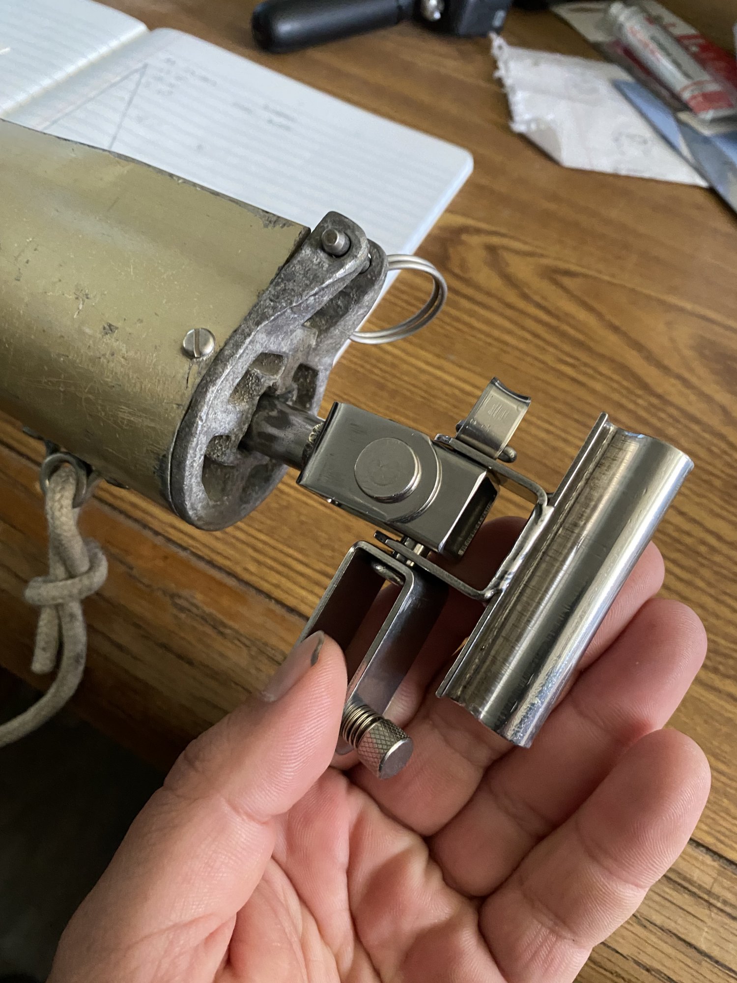

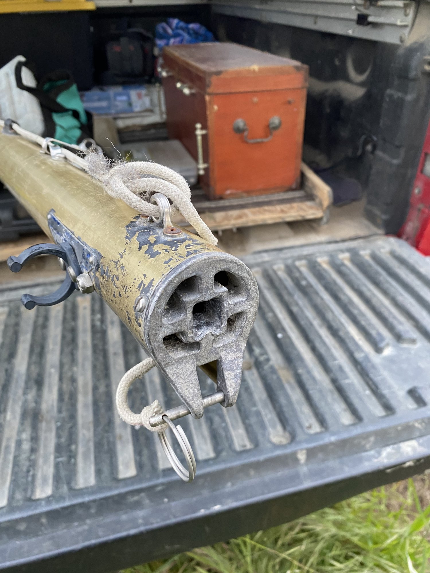

Wow, thank you all for commenting. So I do need to cut the boom down, which means that sail with E 7'11'' is too long. I'm gonna cut the boom to 7'5'' or 90'' which is what the boat would have had when it was new and it looks like that's all the clearance I really have from the back stay. So that being said, when sail searching I should probably be looking for a sail with an E of about 7'2'' or shorter? I seem to be getting in the range where a lot of the sails are intended for windsurfing which is interesting.
I'm attaching a few photos of the hardware on my boom. let me know what you guys think about how to make that gooseneck work with what I've got. RL 252 Luff Groove Roller Reefing Gooseneck
13,088

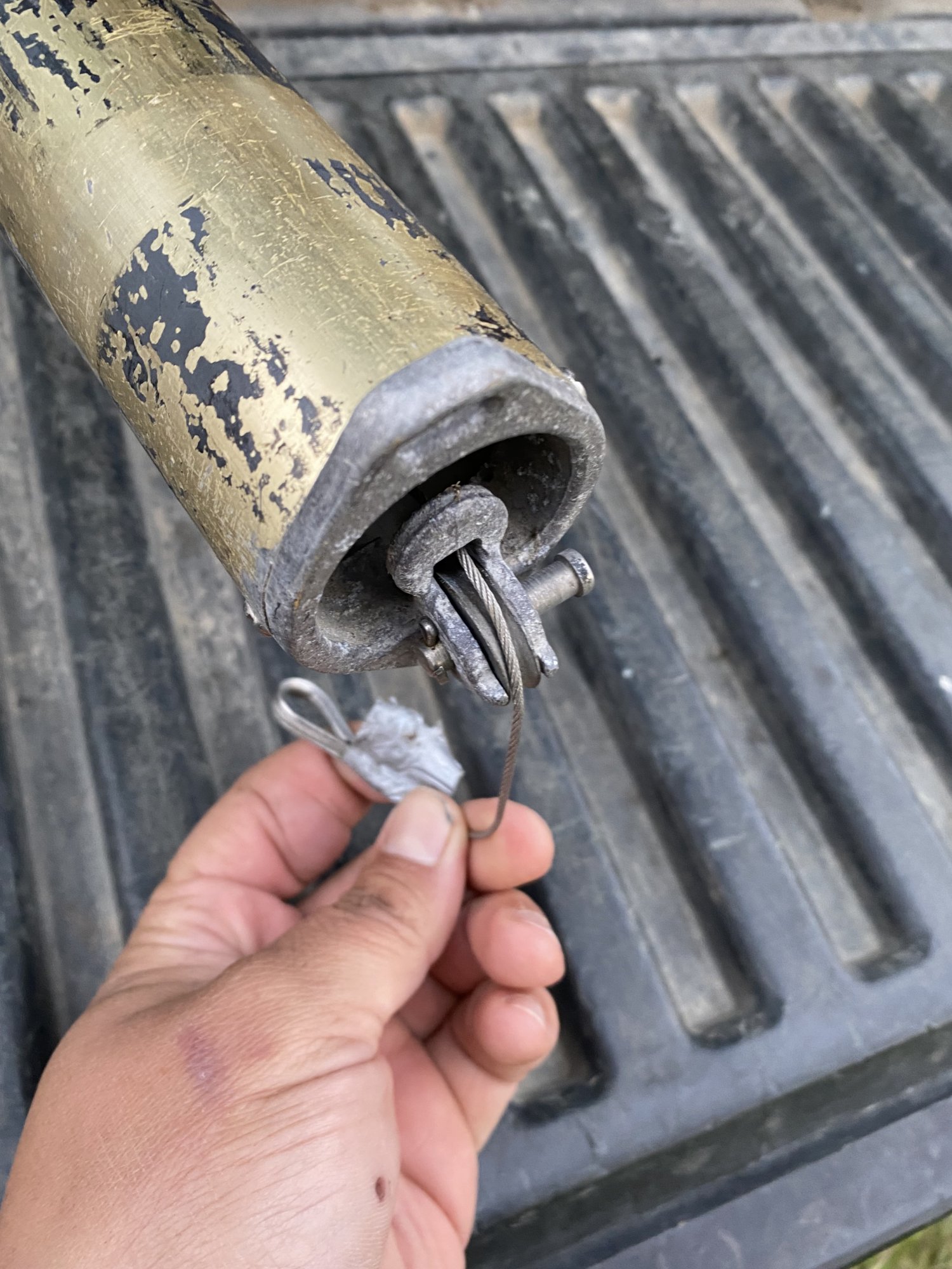

You will want to save and reuse this end cap...
It contains an internal outhaul. Remove the two machine screws seen on either side and the cap should slide out. After cutting down the boom, I'd reinsert the cap using pop rivets.
The other end of that wire will exit the boom someplace near the gooseneck... I could not tell from your picture how your goosneck attaches to the mast. It kind of looks busted to me.... You may need to order a new one from Dweyr.

Great info, many thanks. I'm still waiting for my gooseneck in the mail before i move foward with cutting the boom. I think I am going to have a new main made, probably BaconSails. How can I confirm what luff hardware I need? Theres a couple pictures at the beginning of my post that show my mast (first post third picture). I think I have round rope style track? 3/8 or maybe 5/16. Looks like those come standard with a loose foot so I'm good on that.
Thanks everyone
13,088
Thanks everyone
You can PM me an address and I'll send you a 3/8 sail slide. I have a bunch of old ones sitting in a box. You can then see if it fits in the slot. I'm not a fan of bolt rope... slides go up and down much easier.

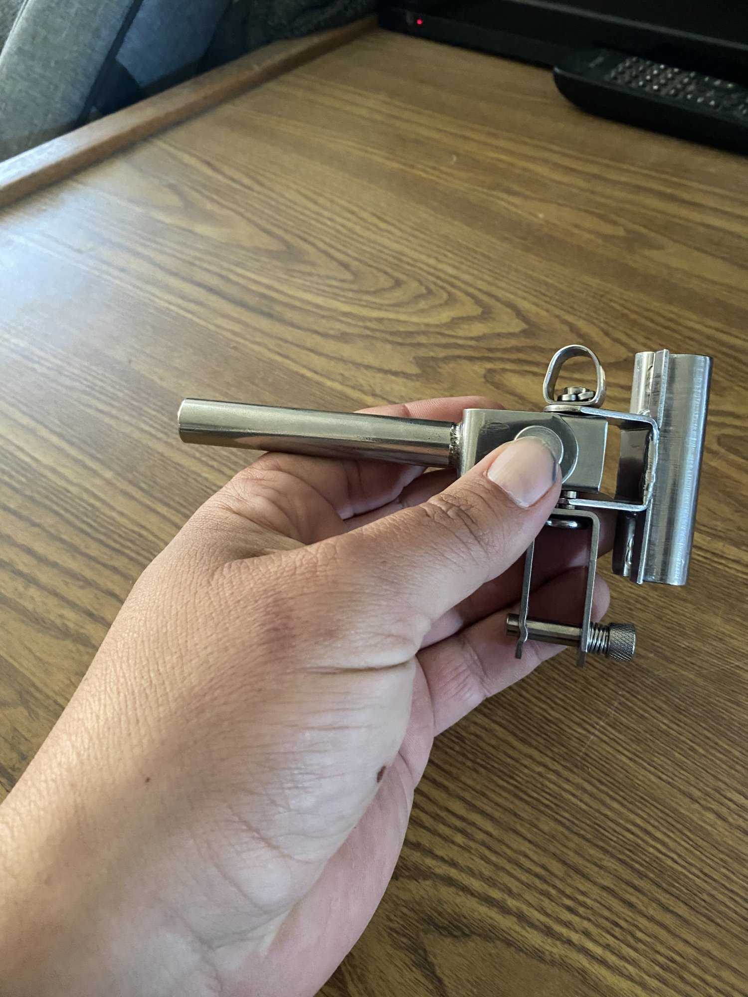

The goose is loose! so the gooseneck showed up, know my next task is attaching the boom to the gooseneck. the sliding part fits inside the track on my mast and slides nicely but how about the other end? what keeps it from sliding out of the boom? I think I must be missing something. I understand that that I will attach a line to the bottom end of the goose for the "holddown?" and the vang will keep the stern end down but it just seems like if a force pushes the boom apart from the mast it could just slide right off that pin.
