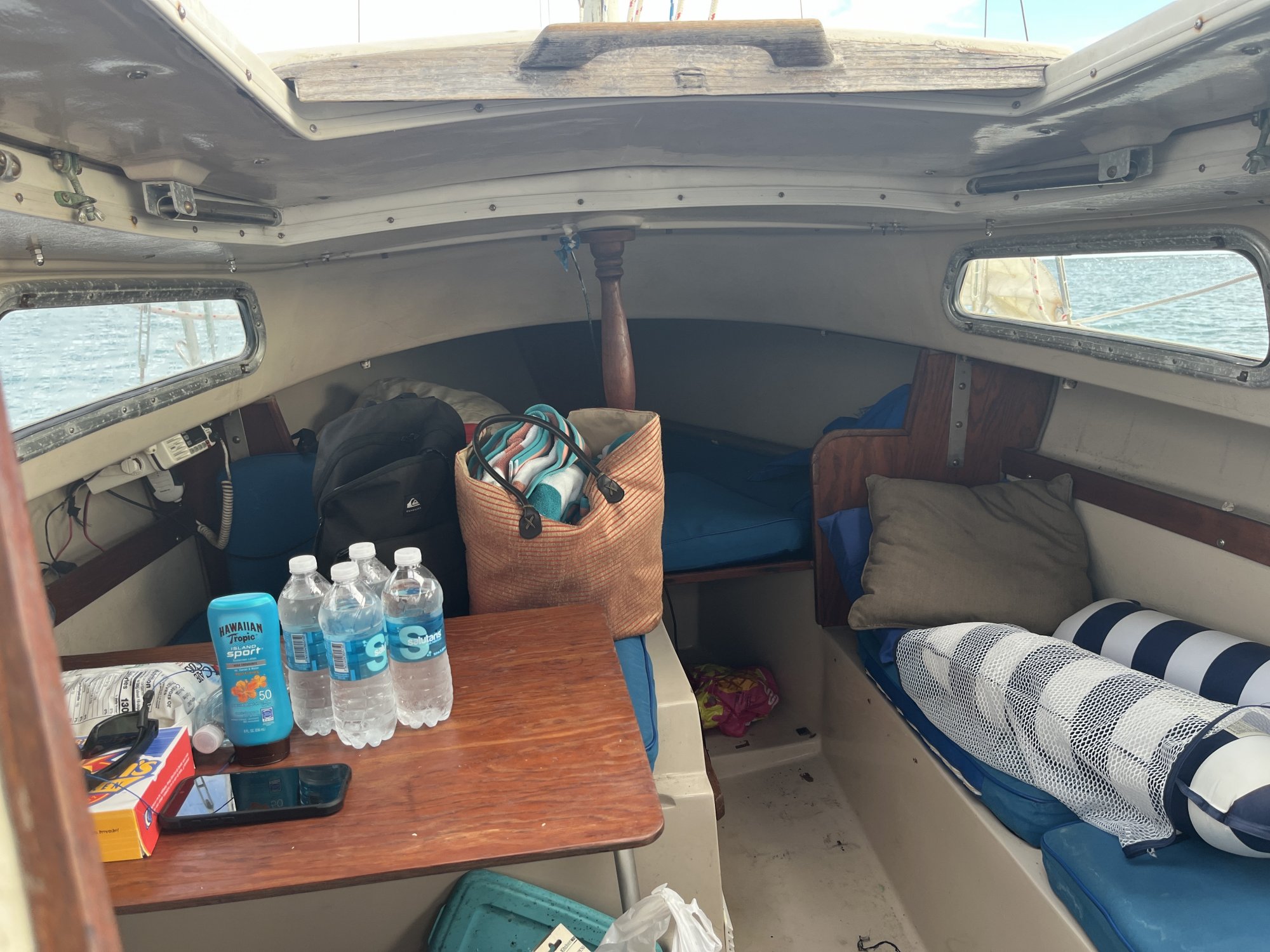

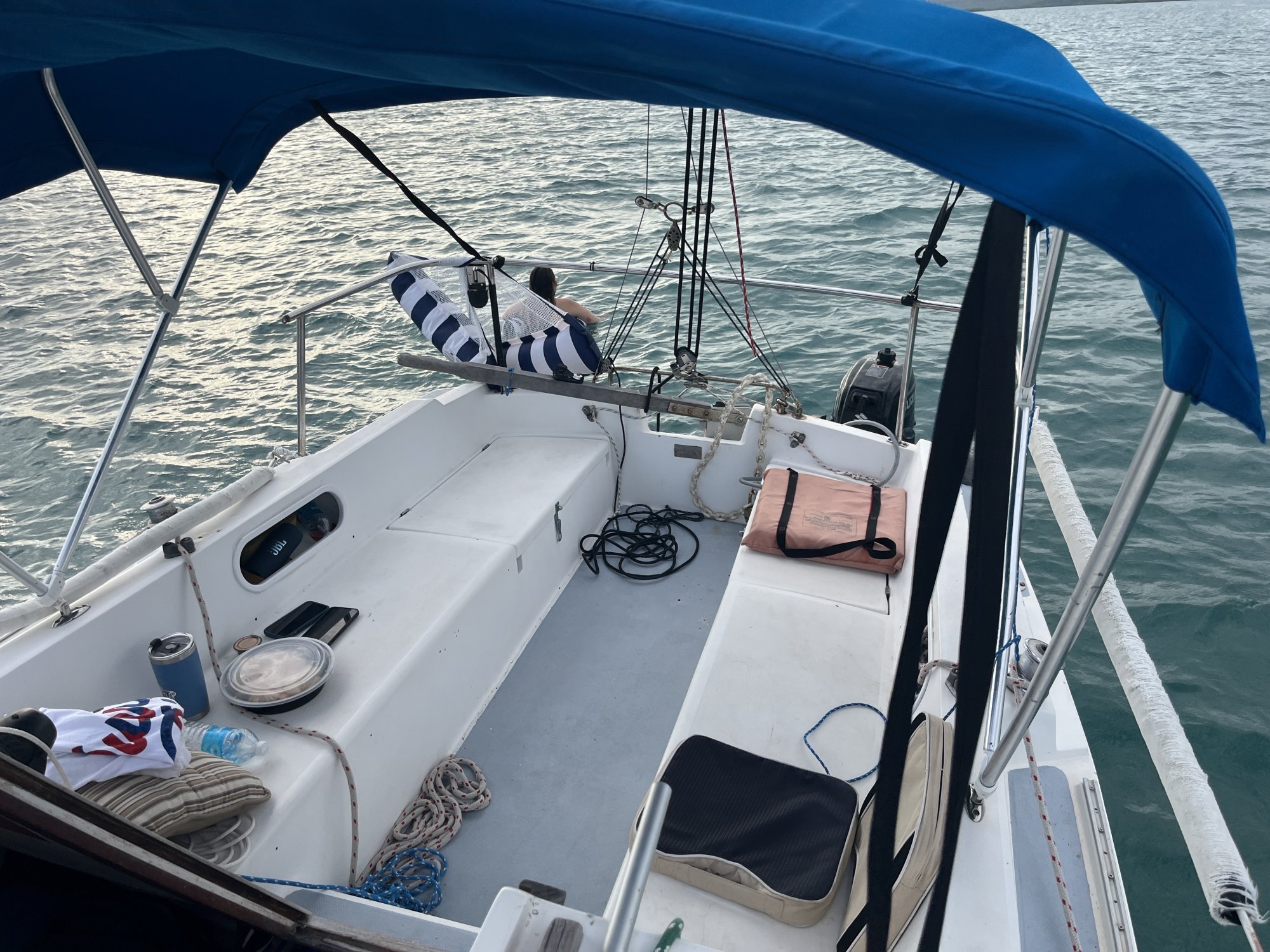

Main red flags (photos attached)

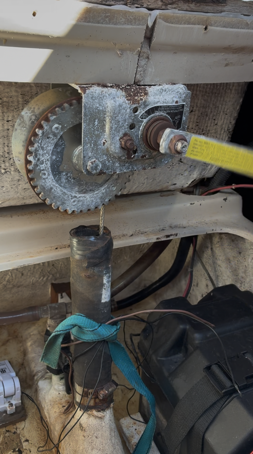

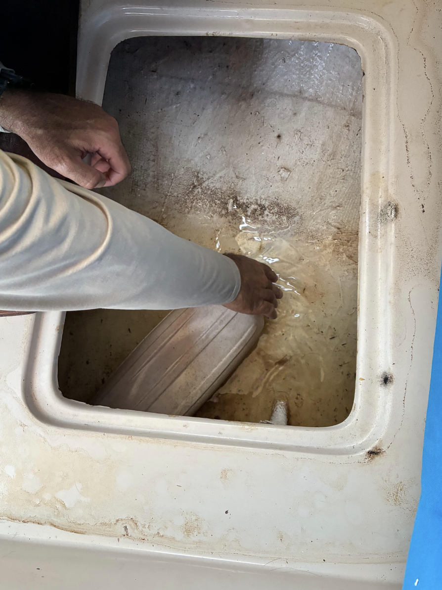

  1. Standing water in the compartment by the keel lock (I expected this area to be enclosed/dry).

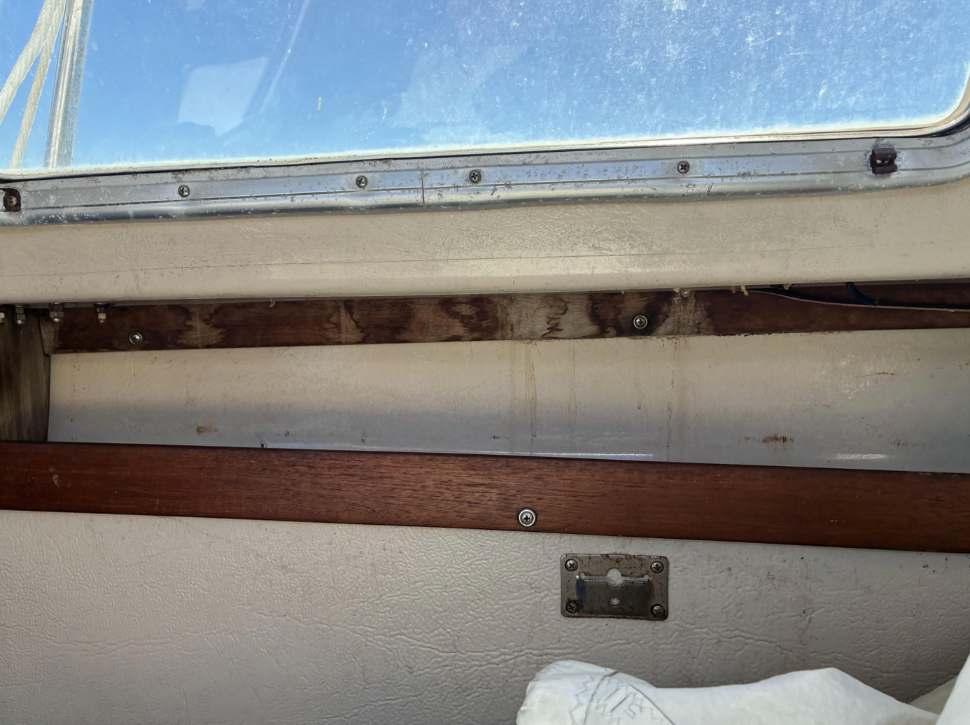

  2. Visible water damage/staining around the port aft portlight.
  3. Bilge area has corrosion + messy wiring; bilge pump works but float switch doesn’t (needs replacing).

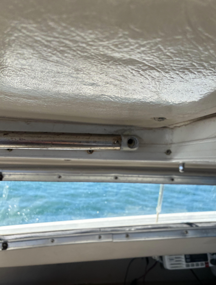

  4. Pop-top: hardware issue (missing screw) + seal looks aged.
Other notes (less critical, but adds up)

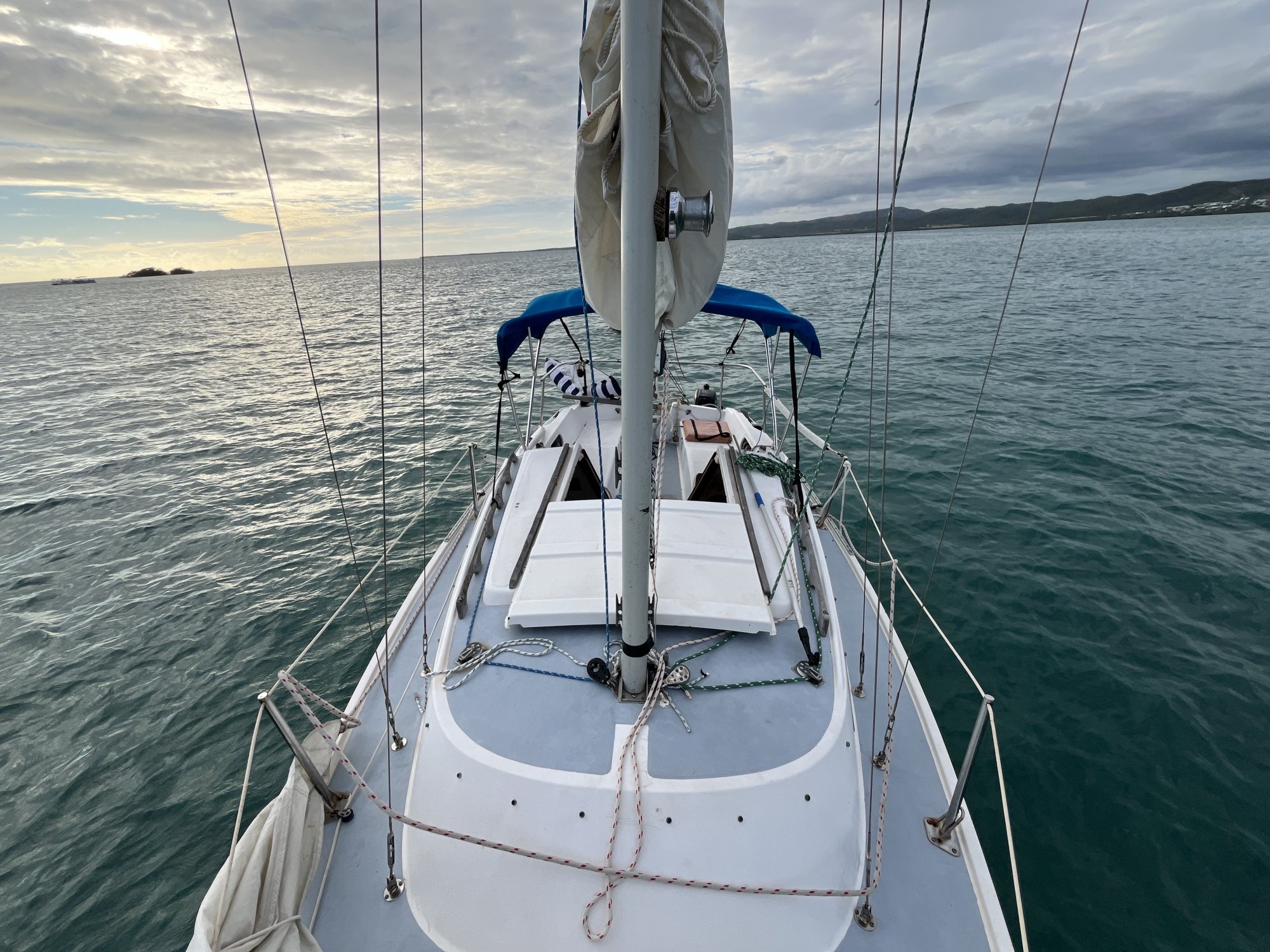

  • Deck tap test: mostly normal, but dull “thunk” near the lines-led-aft hardware (possible wet core vs backing/mod).
  • Main sail hoisted; seller says one batten missing.
  • Trailer looks usable but wiring was done DIY.
Questions
  1. Water in keel-lock compartment: common C22 quirk or walk-away? Most likely leak paths?
  2. Portlight water damage: usually just a reseal, or does this often mean core/rot nearby?
  3. Deck “thunk” near organizers: would you be concerned?
  4. Given these issues, what do we think about the $10k asking?
  5. What would you do — would you walk away? If not, what price would make you comfortable?
(Photos: port aft portlight damage, keel-lock compartment water, bilge corrosion, missing pop-top screw, interior, cockpit, deck, hull/rubrail shot)

A new trailer is probably $2000-4500 and the outboard is round $1500-2500. Boat appears to be in good condition but far from perfect. Is the boat itself worth $3000-6500? It's probably somewhere in that range. See where negotiations will take you.

That seems quite high to me. Here in Eastern NC that is a $3000-5000 boat. I bought a nice ODay 192 last year with new sails, decent Tohatsu 6 hp 4 stroke and trailer for $3500. And it seems like prices have come down since then. It seems to be a buyers market around here.

I'd walk away only because I'm too old to run. ;) that's a 3.5 K boat in Oregon as well

$10K is a lot for a 40 year old Catalina 22. How many Catalina 22s are there in PR? Are there many small cabin sailboats on the island? A limited supply may drive the prices higher than they are on the Mainland. It may be worth half that price. In the end it is worth what a buyer and seller agree upon.

Wow. What price would make me comfortable? I don't live in Puerto Rico so there is really no good way to answer that question. Your descriptions show the worst case scenarios of the boat. The original C-22's electrical system while fully functional, was a bird's nest of a mess. That issue can be easily made neater with a new switch panel and patient attention to detail while rewiring the panel. Issues that you pointed out do not detract from the great sailing characteristics of the C-22 design. I replaced my New Design's switch panel and mistakenly though that the mess I was replacing was the PO's idea of a neat installation and it turned out that I was replacing Catalina's version of a Bristol electrical install. Go figure.
The asking price is way too high based on the current continental USA market but based on your local market conditions, it may not be out of line. You can come stateside and get a reasonably well cared for pre-1986 C-22 for 3 to 5K or, a New Design for 4 to 8+ K ranging from OK to exceptional condition but then you'll need to add the cost of transport to Puerto Rico. In my opinion, the immediate expense will be if the current owner cannot provide providence of the standing rigging's age, to replace that with new rigging. With local winds ranging from 10 to 20 knots on average, I would make that my first upgrade/repair. You can sail on old sails until you need new, but keeping the mast up is pretty high up on the to do list.
Depending on how you will use the boat, based on your location, it may be wise to consider a more "Blue Water" design that a rather fantastic daysailer, which is exactly what a C-22 is. Just a thought.

If you end up buying the boat and want to repair the missing pop-top strut bolt, it can be tricky. On my C-22, anyway, the bolt is threaded into fiberglass. The threads on my boat were stripped. See Bolt for pop top support strut for a way to replace the bolt if the threads are stripped.
this detail about the bolt being threaded into the fiberglass was a HUGE help to my decision - thank you!
