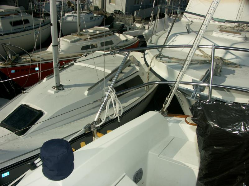

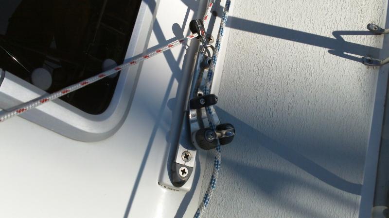

Be very careful when you install the new cars on the track. That piece of track they ship them with is to hold the little ball bearings in place while you slide it onto the track. Otherwise they fall out all over the place.
Not sure if you can see in the picture I posted, but I left my lines a little long and looped them back to the end of the car so if I needed to I could pull the car back. Just as good or better than the bungee cord.
Also don't go too thick on the line as you will find with this setup it is not all that hard to move the cars back when they are under load with the ball bearings.

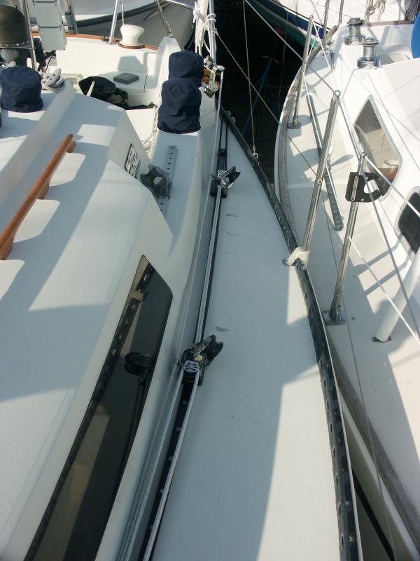

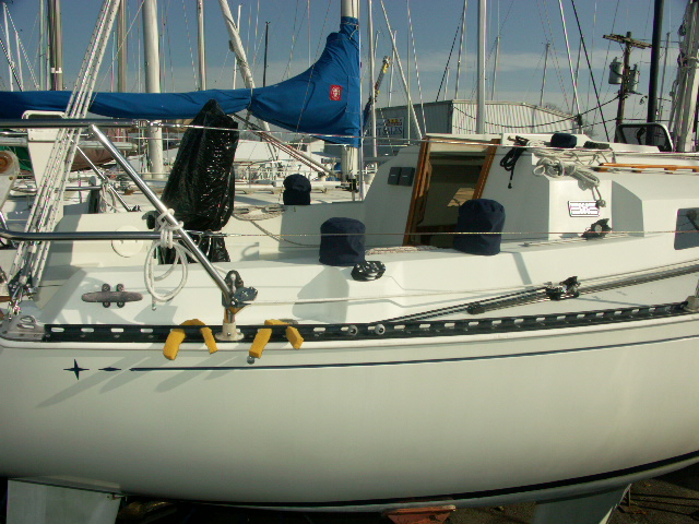

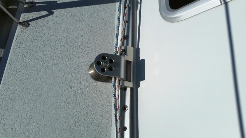

As far as the cam cleat sliders....... don't get them now.... just find a convenient location for a Vee cleat... that's all you need.
The problem with the slider cam cleats is that they are on the track which is not an optimal location.
I purchased the slide mounted cam cleats also...... but I didn't mount them on the same track as the EZ glide system. I mounted them on my inside track, which I rarely use, choosing to barber haul when needed.
Look at the pictures and you'll see that my cam cleat is mounted up on the coaming... very accessible and out of the way of the sheet and the shock cord return system.
Also note that I route my sheet straight back to a turning/foot block before leading to the winch. This allows the shock cord to pull the car backwards, with a little help from the small, line handle I use to help..... otherwise... if the sheet runs upward from the EZ glide car directly to the winch... the upward tension on the line makes moving the car backwards difficult.
If you have a fair run from the EZ glide car to the winch, backwards movement won't be much of a problem... but on the Catalina 27 the winch mount location compared to the track requires this modification.

I think mounting the control line cleat directly behind the car on the same track is about the most inconvenient place to put it.... unless the track is on the cabin top like some smaller craft... Sonic comest to mind... The control line should be easily accessible to the trimmer... because that is the person who will use it. In any event the line can easily be led to a convenient location... and to spend 50-70 bucks just to moiunt it on a track is a waste of money.... you need to rig up the system before you place the cleat... once that's done, it will be clear where the cleat should be.
If you run shiock cord to pull the car backwards the track mounted cleat will definitely interfere, even more so it you need to run the sheet to a foot/turning block for a fair lead to the winch.
If you take a look at some of the systems available from Ronstan and Harken you'll note that they all run their control lines away from the track system... to a location convenient to the trimmer,.. that's not wedged in behind the car with the sheet and return system.
Take a look at some of the systems in the link http://www.pyacht.com/Harken-Genoa-Trav-Diagrm.pdf notice that the control lines all direct away from the track towards a cleat. ALSO..... note the depiction of the jib sheet (blue line). In all cases, the sheet runs flat, as it exits the lead block.... it does not angle directly up to the winch. This is critical for the car to be move aft under load..... an upward angle from the moveable block to winch will inhibit it's ability to slide backwards under tension.....

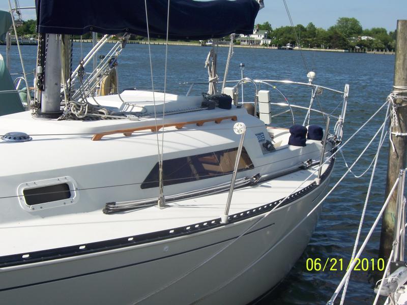

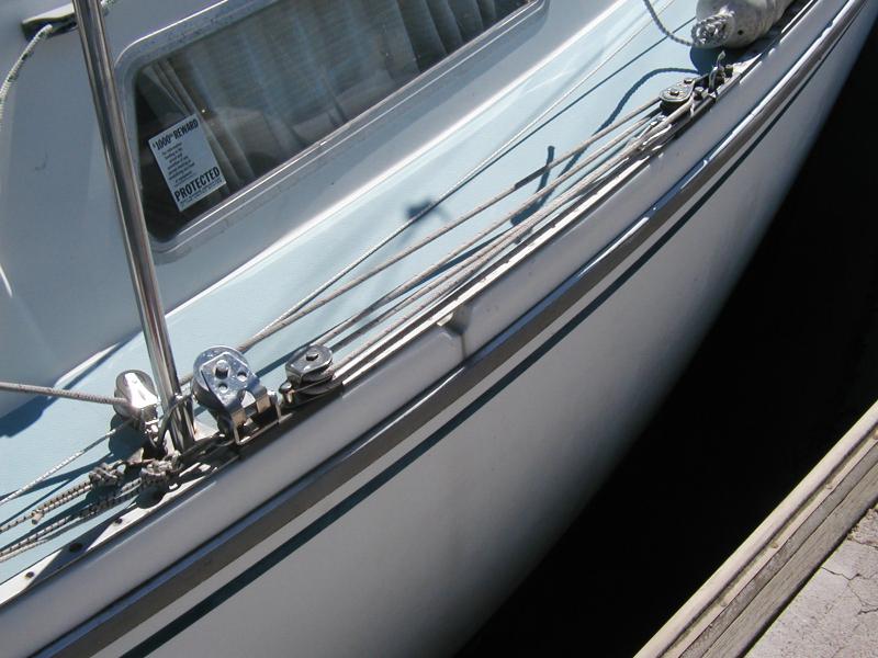

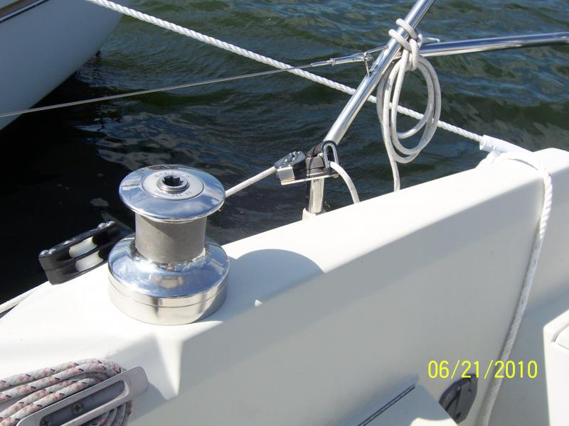

Some photos...
Took some pix when I was down at the boat. I rigged a small return line to pull the car aft because I found that I wanted it all the way aft when I run the genoa poled out when running or reaching in light air. Shock cord didn't cut it for that and left a mess on deck. The return line goes through a block affixed to the swivel cleat car and then just cleats off in a simple jam cleat attached to the cabin side.
