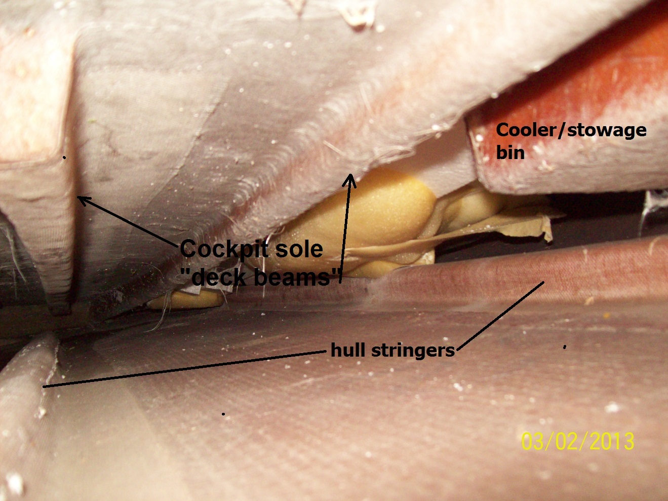

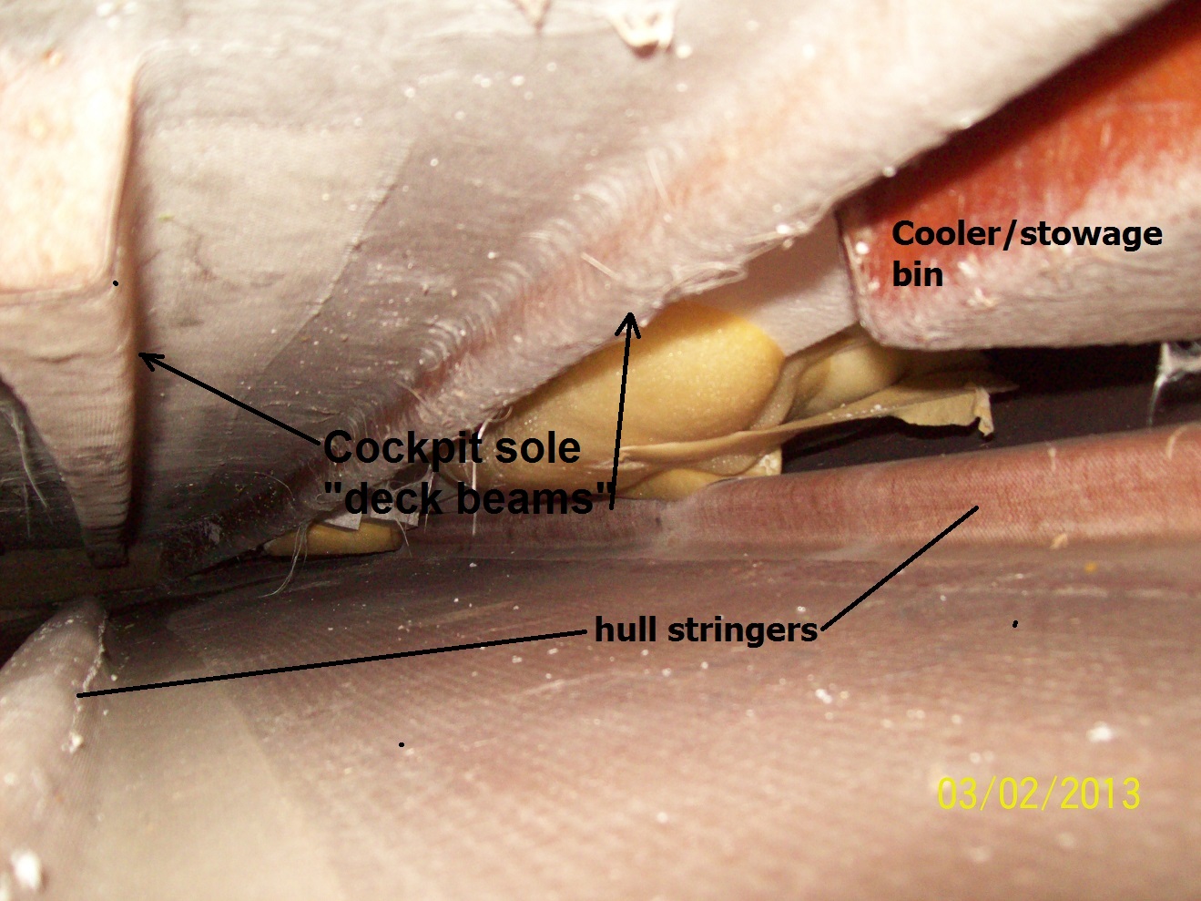

It is POSSIBLE that there isn't a core to the cockpit sole on the 19, although I might be surprised if there isn't. I thought the cockpit sole on my DS II was spongy and so planned to try to fix it the first Winter after I bought the boat. A cut a hole for an inspection port into the sole and was surprised to find that instead of a cored sole there were fiberglass covered foam "beams" to stiffen the sole (an I had cut right through the one down the centerline of the sole!). I installed a couple of plywood pieces to bridge the gap and still allow the inspection port. I would think that the O'DAY 19 would have a core in the cockpit sole, but maybe it also has the same setup as the DS II?
Sunbird, there is one fiberglass covered foam athwartships beam on the floor of the cockpit of the 19. I too have an inspection port just aft of the centerboard pennant cleat....allows me to pump out the bilge. There was balsa wood core that was wet around the inspection port so cropped that out and placed 3/8 inch plywood soaked in penetrating epoxy as a temporary measure until I tackle the job this winter.
The fiberglass foam beam does seem a little soft and depending on how things look may reinforce that beam or replace it. By the way, nice pic of the foam block under port seat.
