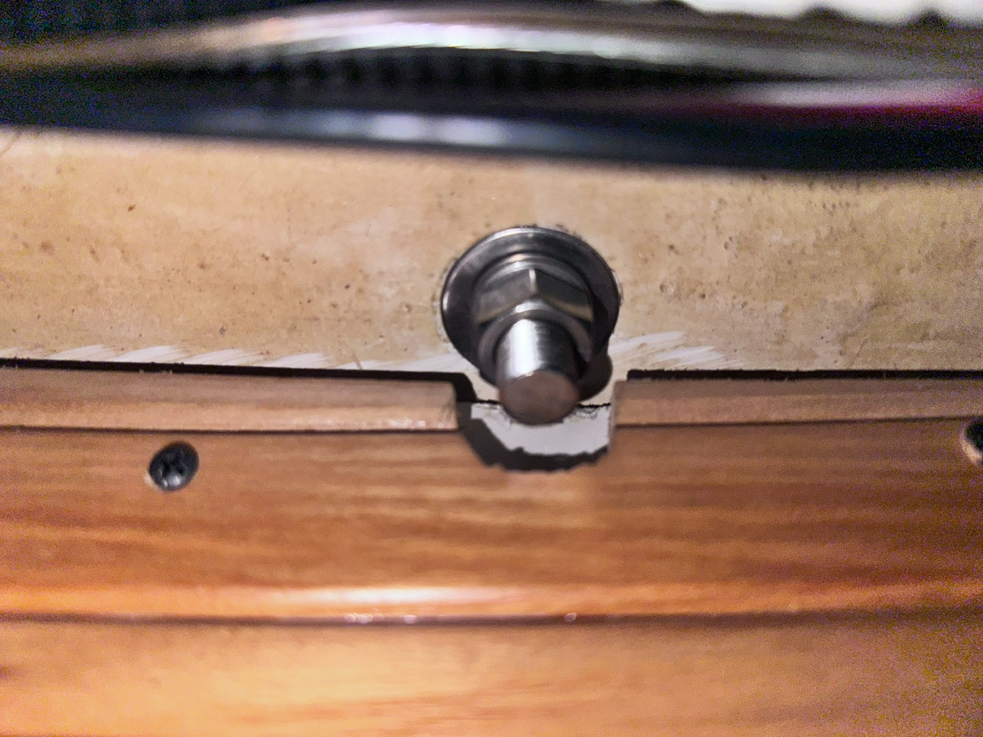

I'm have to remove some wood strips from the inside of my hull to access a stanchion bolt. What glue will hold the wood to the fiberglass but not have such a strong hold that it can't be removed in the future?

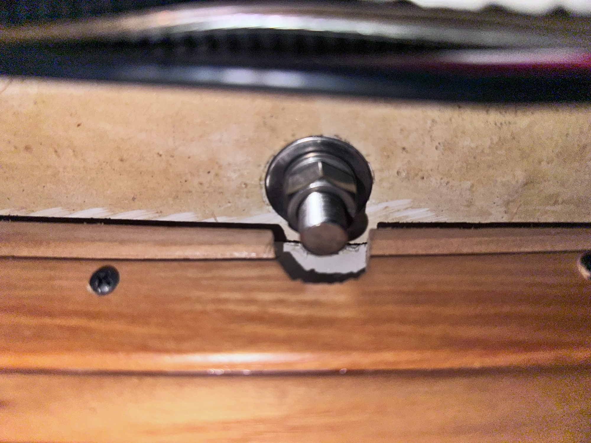

I noticed in a pic that there might be screws holding this strip on. Hopefully that's all that's holding this piece on
Have you removed these wood strips yet?
If not you may find that the strips are backed by fiberglass so that they are essentially one piece of wood.
