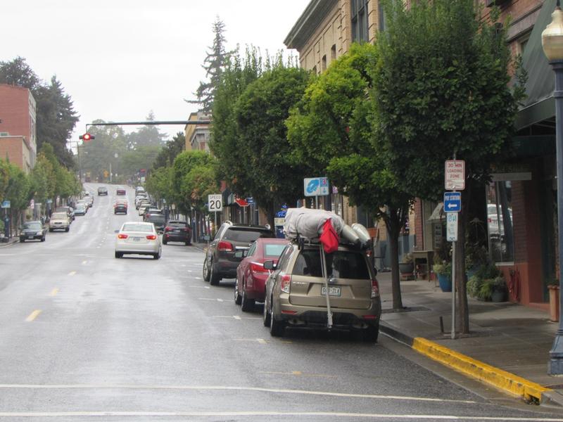

Subaru Forester data point..
I have a 2009 with the four speed auto and one time pulling an 800 pound trailer over the mountains in CO had the smell of over heated tranny fluid. So I added a cooler, no problem since.
This car will pull my Mac 26S full of water (ballast) up even a steep wet ramp no strain/ problem at all. That boat is probably 2700 pounds on the trailer and even with trailer brakes, no way would I run it on the highway (but I also have not tried this and also wont).
Im on a trip right now with the Hobie TI (18 foot trimaran) on the roof and just did 1500 miles at average of maybe 73 mph getting 22.5 MPG... The picture is from Hood River OR where it was nice to not have a trailer.
