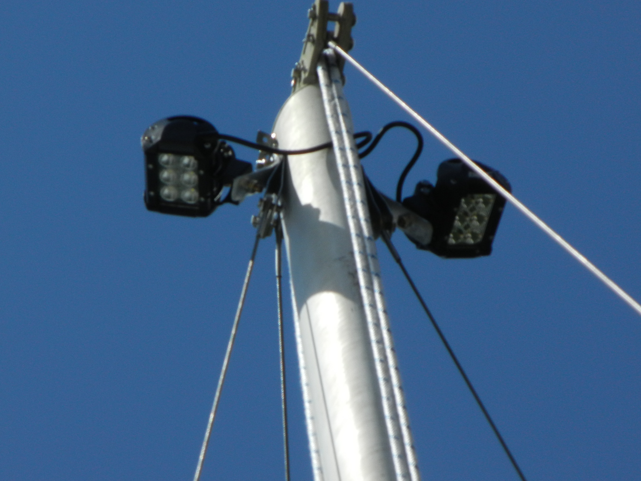

My son wanted to add Mast lights at the top of the mast. There was one existing mast light about halfway up the mast on our forty-year-old boat.
We made two aluminum brackets from flat stock scrap we had on hand, purchased two LED lights and a dimmer switch so we could adjust the brightness. We used the existing mast light circuit for the power source, but with the addition of the dimmer switch we can turn the new lights on or off independent of the existing mast light. These new lights do require that the breaker switch for the existing mast light be on. We would have the running lights on anyway, if anchored out on the lake.
The new lights work well. We can light up the boat and a bit of the surrounding water at night on full brightness or dim the light so the boat is visible to other boaters that might be out on the lake. This also provides a way to light up the slip at night. Hopefully, these lights will add some level of safety when we are anchored out on the lake at night.
All boat lighting has been changed out to use LED bulbs so the battery can power the lights for days before needing recharging. Even a small battery we can hold in our hand can power all the light for twenty-four hours. We plan to add a larger battery and a solar panel to charge it whenever the boat is in our slip, during sunlight hours.

Never seen that configuration. Usually people will install deck lighting on the spreaders. You don't leave the running light on when you're anchored, do you? Guess it doesn't make a lot difference on an inland lake. Anyway, nice touch.

Thank you, Joe. We just got our boat in the water so we have not anchored anywhere yet. During late fall and early spring boat traffic on the lake at night is at a minimum. Maybe a few fisherman coming back in at night or going out early in the morning.
During the high traffic season, Memorial Day through Labor Day, there are more boats out at night. My son thought if we decided to get the boat out at night sometime and anchor, being able to light up the boat might be a good idea.
We plan to do more sailing during the off season when it is cooler and we'll have the lake to ourselves, at least while we are learning how to sail. The lake has 476 miles of shoreline. It never freezes over so we can be out on the water most months of the year. A few power boat owners have not read the boating rules and may think they have the right of way over a sailboat. So we are trying to be cautious at night.
Once we have gained confidence in our ability to sail our boat, we'll sail during the peak boating season as well.

Well after that lake incident in northern California a few years back, where a drunk power boater ran over a sailboat at night... and ended up winning the lawsuit, I think I completely understand your son's thinking. If you're on a party lake.... the guys with the high powered boats can be a real menace.... although it seems that law enforcement is getting a lot better at citing drunken boaters...
I'd probably string the Christmas lights if I anchored on some of these lakes. Good luck... stay safe.
24,521
I've seen light like these on fishing boats. They are like daylight when fully charged. Used for working in foul seas. Not needed on most inland boat situations. But it is your boat and make the experience what you desire. I like trying to preserve my night vision if possible. Carry a couple of 1000 candle power flash lights that can be used as needed.

You sure you won't attract other boats like moths to a flame?? ;)
Having spent a lot of time aboard carriers, I would go with red lighting and protect night vision.

Thank you for your comments, JsSailem and Justin. Good point on saving night vision. We have small red LED lanterns we can hang on the boat.
On full bright we light up both the boat and water around it. We will experiment with the dimmer switch and see how the lights work out for us. They certainly work well when the boat is in the dock. We just got the boat in the water September 5th, so we have not been out on the water at night yet.
We plan to add a solar panel and charge controller on the boat to keep the battery charged. I'll post photos of that when we get it configured.

I would do the same but on the spreaders,I would like to see what my sails are doing
on a few night time trips.
