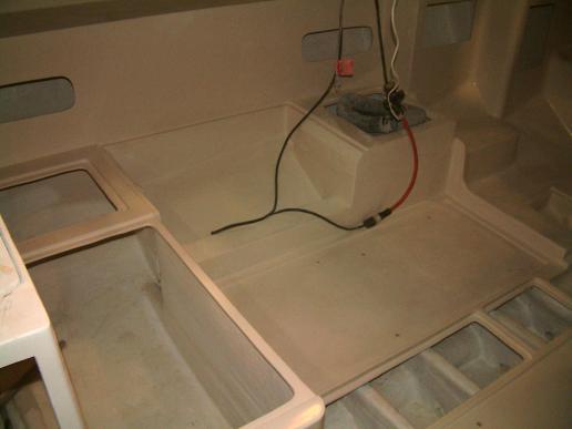

Tom and all, If we could find a good solution to the holding tank problem I do certainly want a bigger tank and I agree that there are many others that would. There is strength in numbers. When I visited the Catalina factory in Woodland Hills last week I made a case to Sharon Day VP Sales that the 36 should come with a larger tank - I agree with you that there are many that would be interested. I had previously been told through my dealer that Gerry the chief engineer had indicated Catalina did not currently offer such an option. Sharon indicated she would talk with Gerry again - he was at the Florida facility at the time. I looked at my Catalina which is currently in production and note that the current hull liner creates a saddle for the existing holding tank and I wonder that if cut whether it would weaken the stiffness of the hull - Catalina use the liners to provide strength. The attached picture shows the port settee area with the galley area to the left and the tank saddle top centre. I will follow-up with Catalina to-day - once they are at work out there. I am a slightly concerned about the addition of more tankage on the port side based on concerns of some C36 owners about a list to the port although another 15 gallons is only another 120 to 150 lb - don't know the density of the material fills the holding tank.... The best place for the tank is more towards the centre. You can see in the picture, there is lots of room under the aft dinette seat, which is more centred, but it is further from the head and I don't want to split up the tanks if it can be helped. Your solution was to put it in the forward port dinette space - and another alternate might well be the aft port dinette space - if there is not something else going there and if the existing hull liner can be cut without weakening the structure. It was clear from discussions with my dealer and my visit to Woodland Hills, that Catalina is a production facility and do not do special mods for owners. However they do have a customer orientation as proven by continual changes to provide improvements based on overall customer satisfaction. (over the last year several very useful improvements have been made). Hopefully I can tap into this on the strength of a wider customer interest.

Malcom, great picture. Never saw what my hull
looked like before all the trimmings. A few points. I would not worry about the port list. I think on the older C36's they might have had a slight port list. But I think it went the other way on the newer C36's. At least it did with my '99 C36MKII. I think it had to do with the 2 big 4D batteries they started adding on the Starboard side. So I think you'll be ok with that, in fact it might level things out a bit like it does on my boat.. I wouldn't jump and use that space just forward of the sink (aft dinette seat). Its valuable space and like you said, a bit too far away from the head. Lots of people use that asa good location for the A/C. I don't think you'll be able to put it in your alternate location "aft port dinette space" They put the macerator there and the Holding tank thru-hull, and the water valves, etc. I still think it would best utilizing the forward port dinette space, nothing is being used there. I understand your concerns that the hull liner creates a saddle for the existing holding tank and if you cut it whether it would weaken the stiffness of the hull. But I looked closely and a small cut out to extend the tank forward shouldn't make much of a difference. It would be great if they redesigned the the hull liner, but I think that would be a big thing to them. If and when you talk to Gerry, tell him you spoke to me (Tom Senator C36MKII technical Editor) and that I heard from a lot of people complaining about the size of the holding tank & have had a lot of requests from people asking how can they increase their holding tank size (which I have found out is not that easy to do.) Bottom line is 17 gallons is too little and most people complain that that is one of the biggest weakness's of the C36. You can also imply that there would be a very big aftermarket demand of the new holding tanks that we could advertise on the C36 website. http://www.catalina36.org/ You ARE going to join the C36 association aren't you? ;-)
