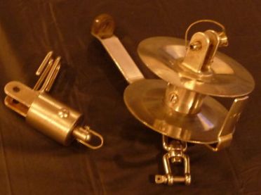

How would this be more load than the old Schaefer (no foil) roller furlers? Had these on both Chris Craft 35s and the GS41 I owned and sailed.
Of course these were old and beefy boats with rope/wire halyards. Is it because a storm sail would be more subject to shock loading?
Like this
Nov 8, 2010
11,386
Like this
Those never worked well. Way too hard to get correct luff tension. Indeed, Schaefer no longer sells those as jib furlers for bigger boats.
They now sell it as a 'free flying' furler, only for day sailers, and for off-wind sails on larger boats.
BTW, wire halyards were no stronger or offered less stretch than modern halyards.
In my actual experience they worked fine.
