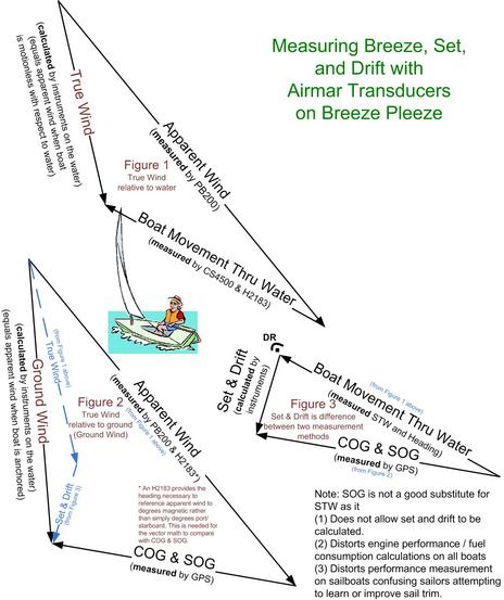

Ground wind is referenced to a fixed point on earth. Ground wind has a direction referenced to North.
Apparent and true wind are referenced to the boat. TWA has an angle referenced to the bow of the boat. TWS is referenced to the water.
A better terminolgy might be “water true wind speed” and angle. vs “ground wind speed” and ground-wind direction. They are different frames of reference and are useful in different ways.
If you use the gps with SOG and COG to calculate true wind angle and speed, you will get different numbers for “true” wind speed and angle for starboard vs port tack whenever there is a cross current . Using the paddle wheel’s speed through the water gives consistent results from tack to tack.
Sailors often want to know how close to the wind and how fast through the water they can go. For that you need the true water” wind direction and speed. sail boat performance is evaluated with water-relative wind speed and direction.
Current: with both a paddle wheel and gps you can calculate or estimate current, by comparing the SOG/cOG to the knot meter speed. If you are traveling around islands, where current direction and speed vary greatly, that information can add or subtract miles from how far you can cruise.
A knot meter can tell you if you’re pinching too high or footing too low. GPS doesn’t tell you that if there is any current.

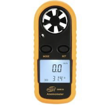

I don’t know if this would have value for you but there are inexpensive small handheld wind instruments.
I have carried one of these in my windsurfing bag for years. Part of windsurfing is picking the right size sail for the conditions, the little battery operated unit gives a reading to help me assess the situation at a site I am new to.

Thanks Joe well said :snooze: Dr Judy thanks for the diagrams and I think you're right about meteorologist not calling it true wind. I think they just call it wind then describe it well. If they happen to be an an airport meteorologist and tell you the wind at the surface they don't name it surface wind however the direction it is coming from is given relative to magnetic North rather than geographic North and speed in knots.

In my case, I have a Garmin DV44 at the helm and a Raymarine C80 under the dodger. The C80 outputs the wind sentence (and water speed) that I feed to the Garmin to show apparent, true and ground wind. As discussed above, the difference is simply apparent wind is what you measure, true wind is referenced to the water around you (using water speed from the paddle), ground wind is referenced to the surface of the earth (using the GPS information).
In practice, apparent wind direction is most stable and used by the autopilot after a good deal of averaging. Apparent wind speed is sometimes useful but typically, when sailing in swell, the mast moves with the waves and the indicated wind speed shows rapid swings. True wind is useful sometimes when steering downwind. True wind speed is often inaccurate because the paddle wheel has a high margin of error. Ground wind speed is the best indication of true wind speed because whatever it loses by not accounting for current it gains by the improved accuracy of using GPS speed. All wind measurements become better with increasing wind speed. At low wind speeds and with a swell, the combined errors from the paddle surfing down the waves, the mast swinging, etc. make wind steering by autopilot very difficult and often useless.

This has been an interesting discussion, and I do appreciate the feedback, but after I re-think my goals, I think my next step will be a small one. my first reaction when I read @Hunter216 post about using a hand held was to roll my eyes :huh:, as I've had a cheep handheld for a few years but the batteries always seem to be dead and I don't know that I trusted it's accuracy anyway. but then you just don't get high quality for $15.00 like back in the good old days:laugh:. So now that I really consider the options, and why I really wanted to know wind speeds in the first place, the suggestion actually makes a lot more sense for me.
I don't race, in any sanctioned way, so the main reason I'd want to know what the wind speed is, is so I know weather to be scared or not, and of course being able to brag on forums about sailing in XXX amount of winds with XXX gusts :laugh: . anyway... I just ordered a (hopefully) higher quality hand held device, and I'll try that for a wile and see how it works out. one other plus to this is that it can go from boat to boat with me. we've had our Mac 25 for 5-6 years now, but I've also owned 6-7 other boats over the past 6-7 years so... maybe when I find that illusive "perfect sailboat" then I'll get more permanent instrumentation for it :).
