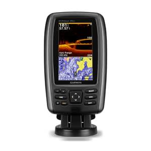

I've looked at the Garmin site, but don't see any accessory or referral to anything that I could add to my existing 43dv to give wind speeds. any recommendations? I'm not willing to spend a fortune but just looking at options. I need to get my manual out, but I'm sure even the small Garmin 43 communicates with other devices......... [edit] yup NMEA 0183 as well as NMEA 2000

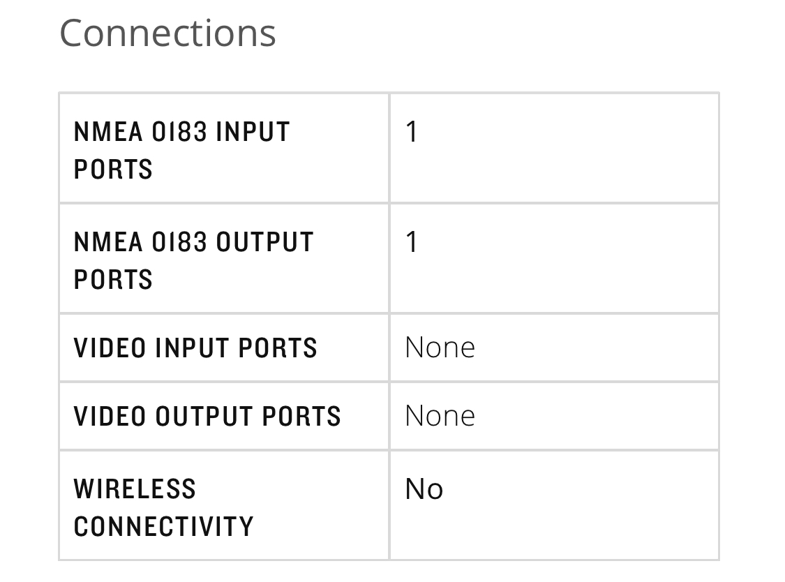

Before you purchase a wind instrument, cabling etc I thought I should raise a potential issue.
I found this in the spec sheet on the Garmin site
I don’t have any hands on experience with this device but the above implies the input connection would be used for the depth transducer.
I’m not sure you could have a depth transducer AND a wind instrument connected and concurrently transmitting data. Maybe that is accomplished through some switching component?

Sorry if I caused any confusion, however @RussC did mention 0183. This is the link to the specs that I was referencing. Looks to be a discontinued product.

After looking at the 2nd posting from hunter216 I did some more poking around on the garmin site. It looks like there may be different versions of the 43dv out there. Some with, some without the nmea2000. Have a look on the back of your unit And see if there are 2 or 3 inputs. If 2 you do not have the Nmea2000.
well.... that's disappointing. you are correct, as there are three places for plugs in the back of mine, but only two have connections in them. how many terminals does each protocol require? there are four terminals in each of the two ports.

Maybe a call to Garmin is in order as I don’t want to cause confusion. There should be a model and serial number on your device that will help.
I’m way out of my experience zone and like a broken clock am only right twice a day ;) but I’m guessing the input port is to connect a depth transducer, the output port is to connect to your VHF radio so the unit can transmit GPS information. Maybe there is a way to connect a wind speed instrument by either disconnecting the depth transducer or use some kind of A/B switch but even then I don’t know if the software on the device would display the data
The unit @twalker H260 referenced has the newer NMEA standard and multiple input capability.
