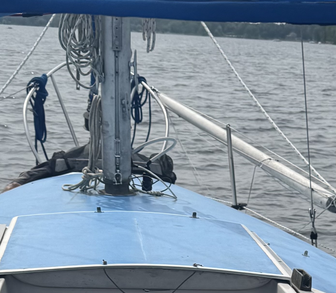

Ok the only picture I have is from the back of the mast, you kind of see the starboard side, all other pictures o have are from the dock which is port side

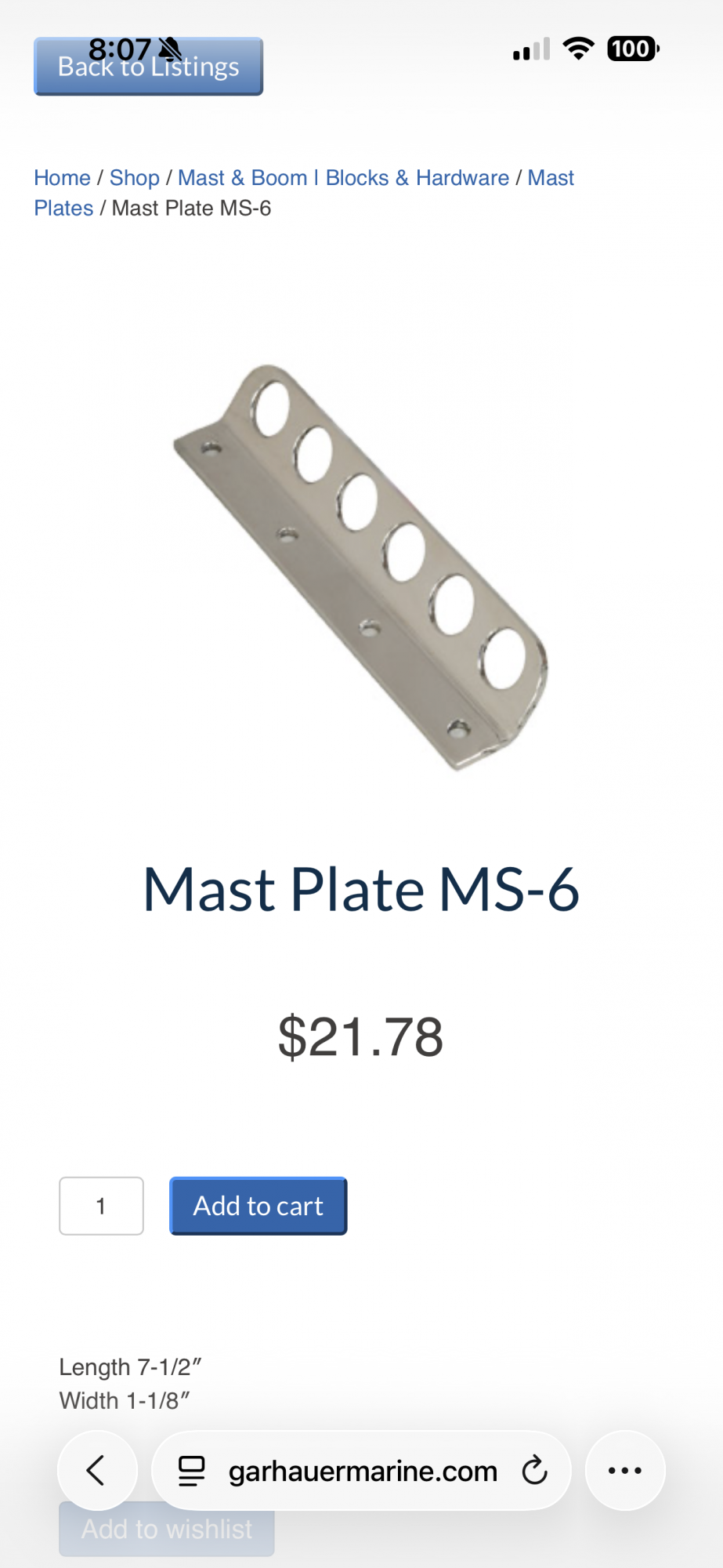

I did look at the Garhauer site today for plates, with my type of mast step, there are not many options, but I did find what I think would be good.
Maybe one on either side, not sure if needed but a possibility.
The price is good, not sure on shipping cost though, but easy to install as well

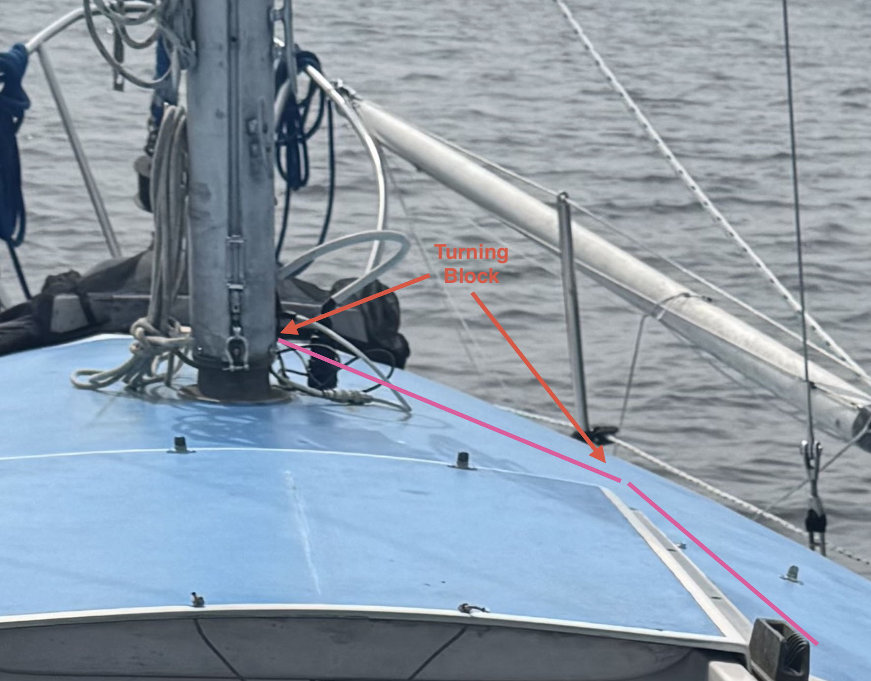

24,883
This is what I would do to address the issue. The turning block at the mast (#1) could be attached to a base collar or standing on the deck. Issue is to turn the line to match the angle of the on deck block (#2) with as little friction as possible.
Purple line is your Halyard.
The #2 turning block is a standard organizer block. It changes the halyard direction to your cockpit where you add the clutch you mentioned. Only issue is you have lines running on the deck that can present a tripping hazard. It is the compromise to going to the mast to make sail adjustments.

If you use anything that is mounted to the deck, it will be necessary to through bolt the mast plate or eye strap because there will be a lot of vertical force on the plate or strap.
