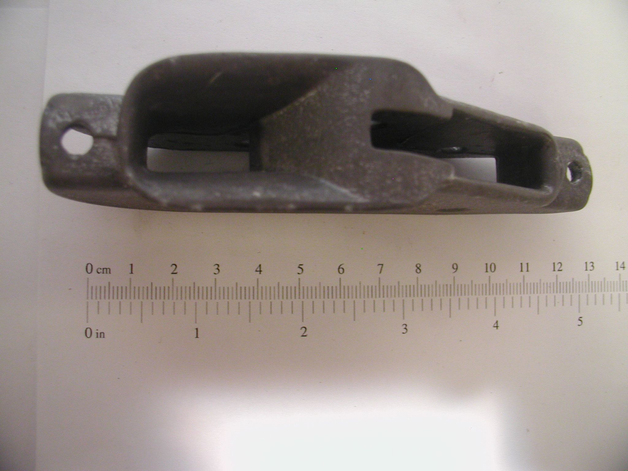

Maybe Dave would know, but most small Hunters I've seen use a combo-box at the forestay as shown below. This box has sheaves for both jib and spin built in as well as the attachment for the forestay. If this is the case on your boat, you simply need to cut a halyard exit in the mast.

The Hunter 20 is a fractional sloop and I want the spinnaker to attach to the mast as high up as I can get it. I don't remember my jib pulley looking like that when I was looking down the mast. If I remember correctly it was simple single pulley block. That would have been sweet had our boat been a masthead sloop and it had that block installed. That would have been too easy. I very seldom get the easy way...

My apology, you are correct. I had to look at picture but yes, the upper shrouds do attach at the same level as the forestay. If we go with a furler for the headsail it will have it's own internal halyard. So could we use the jib halyard for the chute? Would I have to modify it and make it exit the mast above the forestay?
Nov 8, 2010
11,386
Its not recommended at all. Ideally a spin halyard is ABOVE the forestay; it allows it to fly free without winding or chafing. Below it is asking for trouble.
You WOULD be able to re-purpose the jib halyard. If you place the new spin sheave within a foot of the forestay you'll be fine. Just check your forestay box first!
Apr 27, 2010
1,279
Hunter 23 Lake Wallenpaupack
My 23 does have a combo box like pictured by Jackdaw. It has a sheave in the upper section, just above the fitting for the forestay t-ball. I don't have any exit in the mast for an extra halyard, which is fine with me since I lack a spinnaker. The 22 may indeed have the same setup. After all, how much different is 1 foot?
