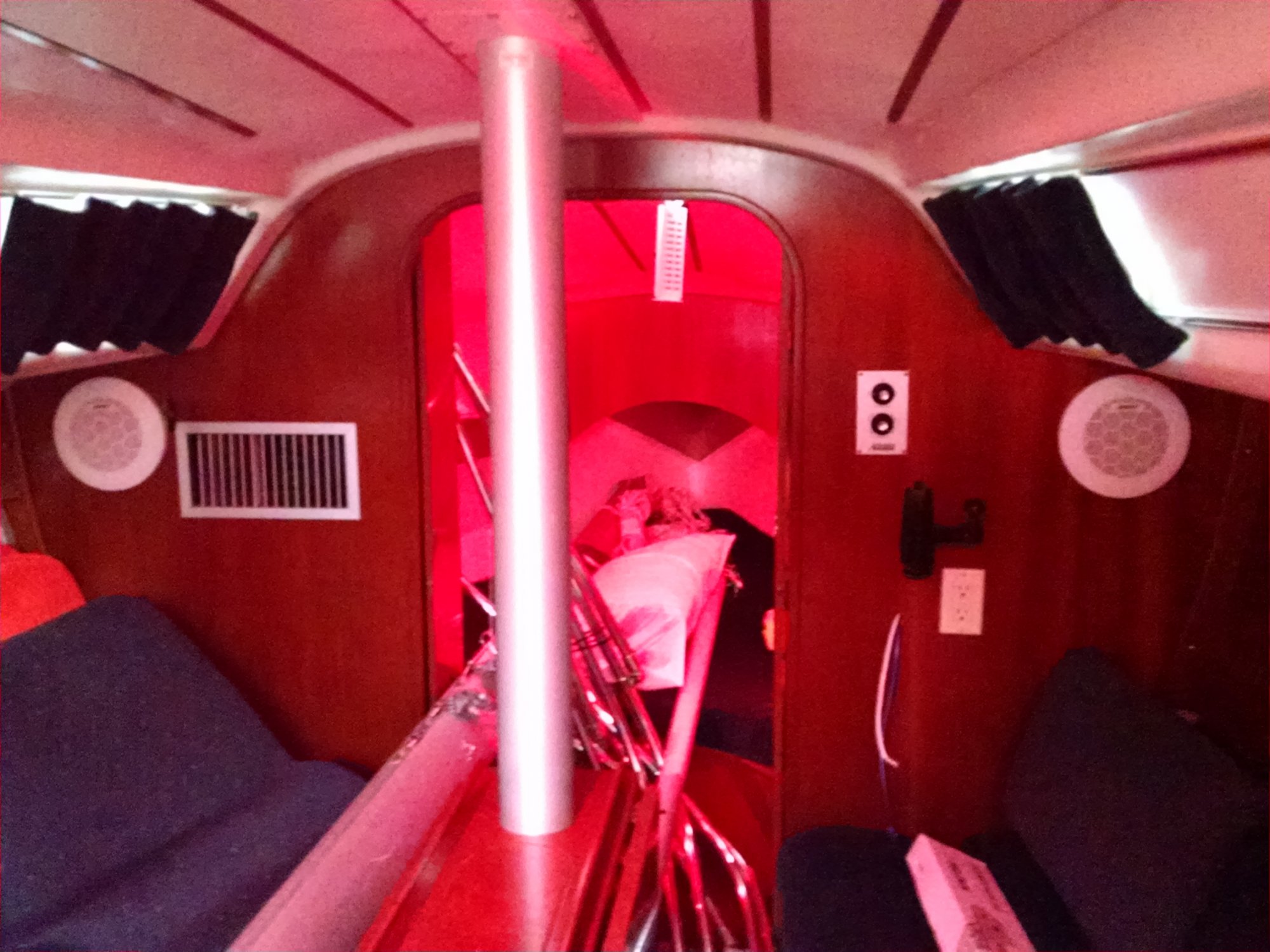

Go over and take a look at mine. I have the Bose speakers that have the back on them that serves as a sound chamber. Not sure they are still available but IMO they are great. Here are the two in the cabin, same units in the cockpit.

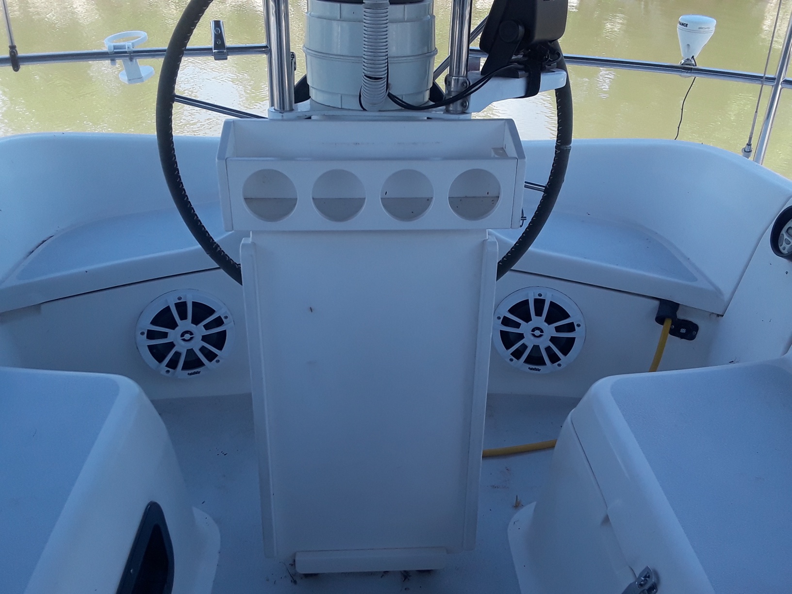

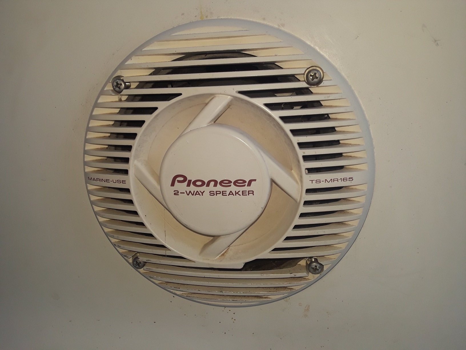

I wondered about enclosed backs. My speakers intrude into the aft lockers so they have decent sound chambers. I do wonder about water entry if the speakers were ever to give way. I have an open transom and we sail on a big pond, so I'm over thinking this. :facepalm:

New speakers are in and they sound great. I did not realize until I removed the old ones, how deteriorated the material supporting the cones was. We're talking almost nonexistent.
I still have to install a switch for the lighting but I touched them to 12v and they light up. I need to find a disco ball next !

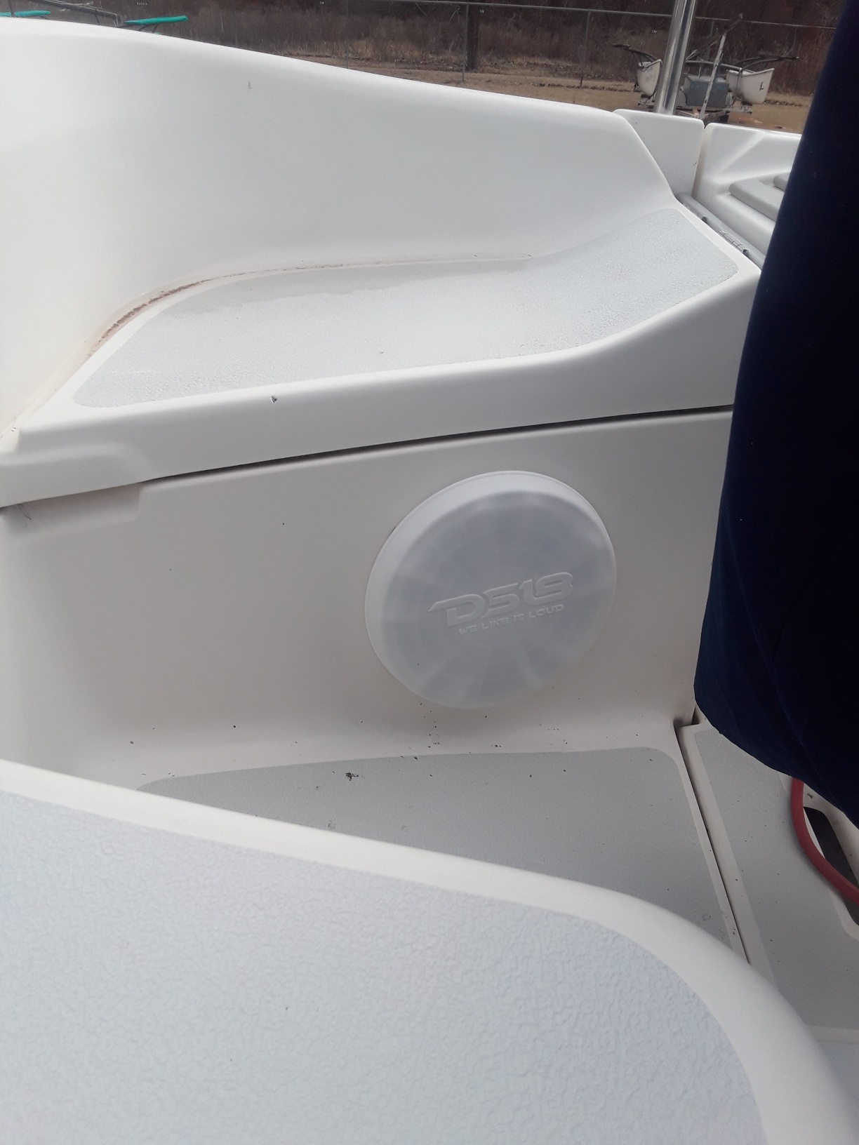

Latest update to my new cockpit speakers upgrade. I've been looking for ways to protect them from the elements. I found these 8" DS18 silicone covers at Hodges Marine. Hodges didn't have a spec on the diameter and the manufacturer would never respond. So for $20 shipped, I took a chance and they fit perfectly. They are so flexible, I still don't know what diameter they are actually, but they fit my 233mm diameter speakers.
My installation is complete. The remote control changes the colors. I just need to make a video and play some KC and the Sunshine band once I hang that mirror ball :dancing:
