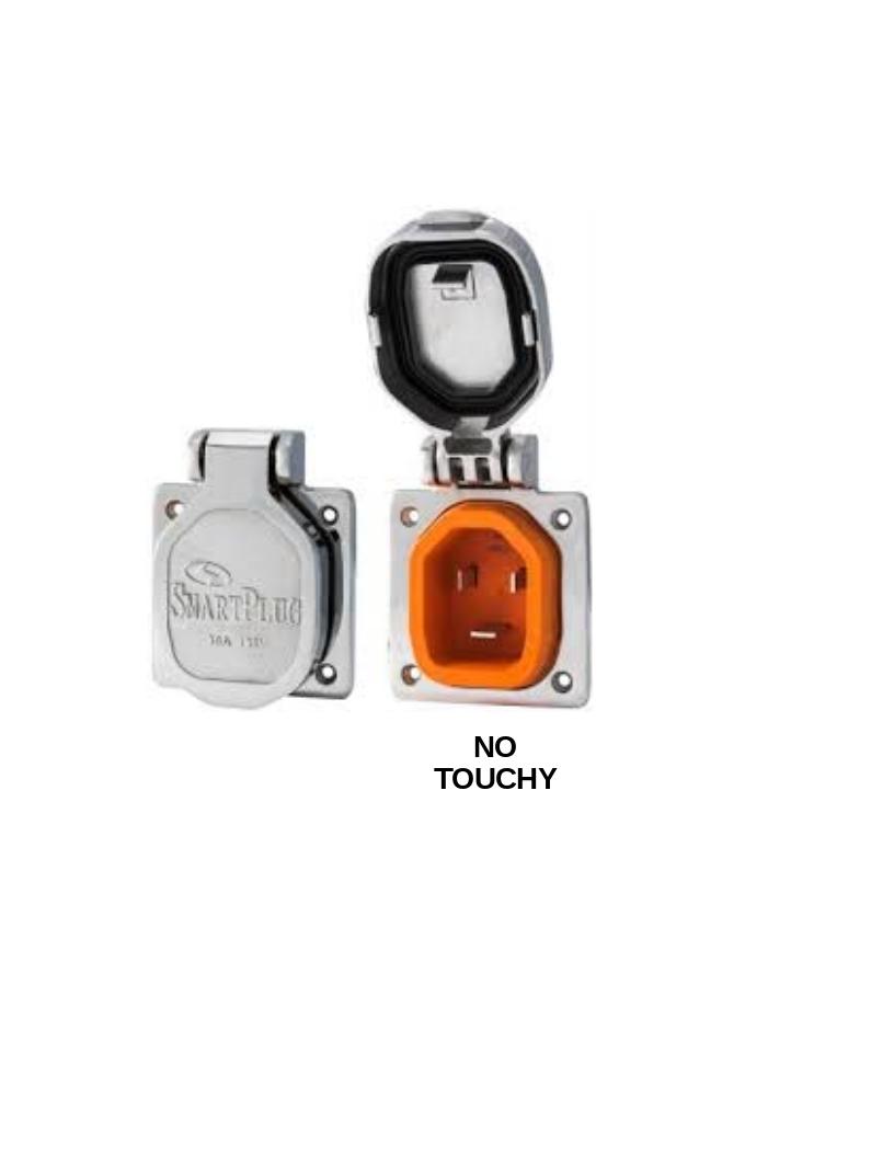

To be ABYC compliant, both inlets will need to have ECLIs installed. These can serve as the "on-switches" for the circuits. Also, the new inlet should have a galvanic isolator installed.
