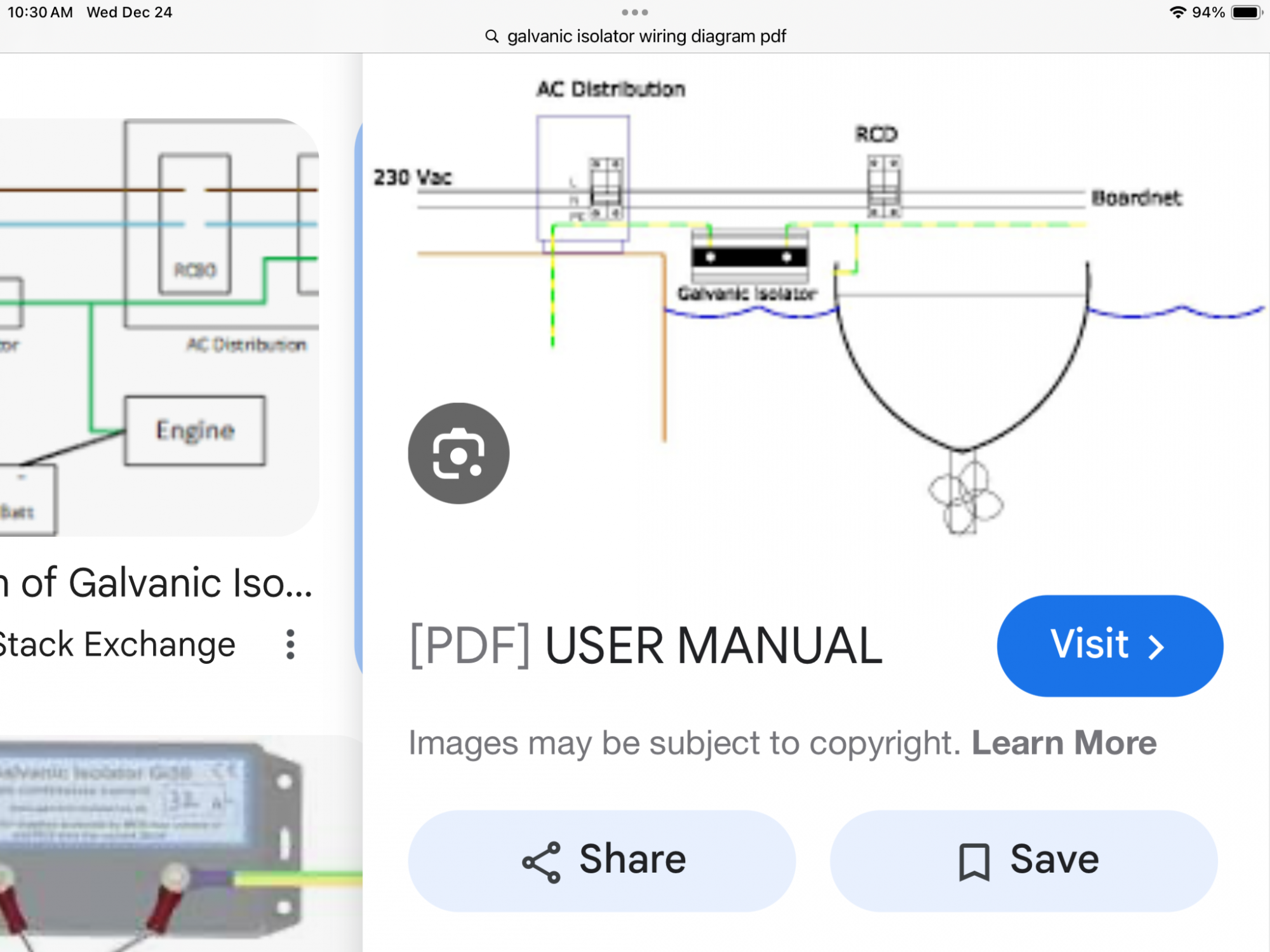

So after 30 amp inlet I an installing ELCI Main 30A Double Pole breaker. Green wire after inlet going directly to galvanic isolator and then where the green going?
And second set of questions after I install metal components of AC system, that contact with sea water, like through-hull, unit it self, sea strainer (also bronze in the webasto installation kit) how I understand I need to bond them. So I am bonding them to existing boat ground bus bar, or I have to create new ground bus bus using my green wire going from isolator. I think green after isolator have to meet with DC ground and that point

2) If in North America, then the grounds of BOTH shore power connectors go to the same galvanic isolator. That's it .... then the new hot/neutral go to their main panel in the cabin then on the AC. ....
power inlet ->> ELCI --> green wire to the same galvanic isolator as the other shore power connection
