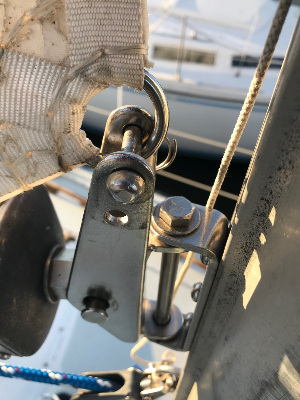

Hey guys, I just bought an 85 Catalina 30TR, and it looks like the previous owner never rigged the mainsail for reefing. The setup at the aft end of the boom is setup nicely with the two cars on the starboard side of the boom for jiffy reefing, but it looks like there is no real setup at the goose-neck for the tack. I have flying cringles on the mainsail luff so my thoughts are to install some reefing hooks, but I am not sure what the best/easiest method would be. Should I try and bolt them onto the open holes on the goose neck just below where the tack pin is installed (see attached picture). What kind would be best? Any advice would be appreciated!

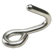

I ended up putting reefing hooks at the gooseneck, something like these:

Thanks, Greg! That looks like what I am looking to do. How did you install the hooks? Did you put them on the inside of the goose neck on the horizontal pin or something else?
Yes. On my gooseneck, I had a hole I could put a bolt or clevis pin though. In your photo, it looks like you use the spot the existing clevis pin is in (may need a longer pin).

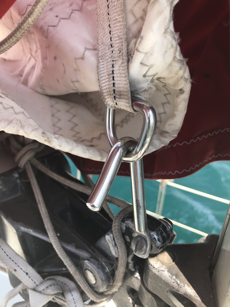

I took this today....
You can see the reef hook, bolted through a hole in the gooseneck. There is another hook on the other side, but it is hanging down.
Good luck with your project.
