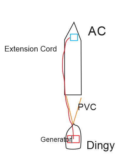

The summer is Florida is very warm. I would like to cool the boat in the afternoon. I have a window AC that I could set up on the bow hatch. I have a generator but am afraid of dying.
If I placed the generator in the dingy and attached the dingy to the stern of the boat with a pvc pipe from each corner to the dingy and ran an extension cord through the pvc pipe and plugged in the AC directly would I survive? The pvc pipes would be 10' long and I would be at anchor.
I would cover the generator if rain was coming. No cords would hit the water. Cool the boat in the afternoon and not sleep while the boat is being cooled.
I’d be pretty worried about the effects of the PVC pipes in powerboat wakes or a swell. Maybe there’s a way to secure it, but it feels to me like the pipes would chafe the dinghy, painter, or power cord.

Backfeeding through an outlet is not a good idea, besides it probably won't work on a gfci protected outlet. Just use the adapter to your shorepower inlet.

I think the PVC pipe idea is a bit goofy. I would just make a dinghy painter with a shore power cord lashed to it with just a little slack. Heck, you could probably just use the shore power cord as a painter, and seize it to to short lengths of line to tie it to the dinghy and to a cleat on the boat. There's very little stress on a painter while at anchor.

I have been doing this for the past 4 seasons although it is to recharge batteries not run AC. I do not use the pvc pipe to hold off and just let the dink trail behind on a 3' painter. This keeps the exhaust and vibration out of the boat and make the generator much quieter for me and my neighbors. I tie the generator so that it will stay in the center of the floor and not vibrate around. Point the exhaust away from the sides so that you do not burn the tubes.
Sound travels mostly "line-of-sight" so with it down below the top of the inflatable tubes, the sound travels out and upward rather than horizontally across the water.
And yes you should have a working CO detector.
