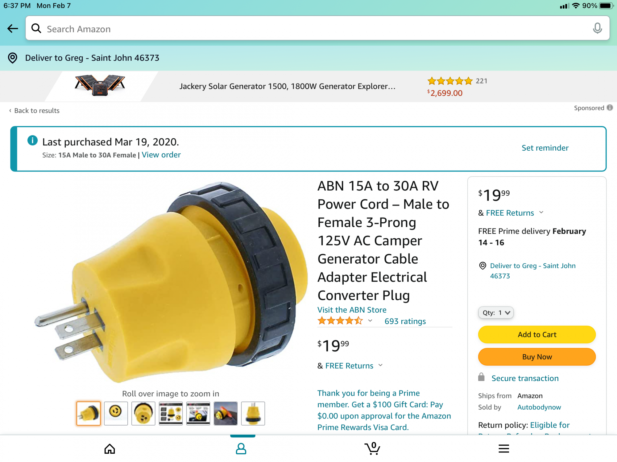

I have something similar that picked up on Amazon. I use it to run 110 to the boat when on the hard. I can run a few power tools in the 110 outlets (shop vac, etc) and keep the batteries charged. I can even run a small electric space heater when it is really cold.
As noted, you really need to be aware that with 15 or 20 amps, and running it through an extension cord, you can over load the cord, or trip the breaker for the power outlet (or the generator in this case).
I don’t leave the power on unless I am at the boat, and start with all of the AC circuits off. If I have the space heater on, I have to be careful what else I try to run. Usually I need to turn off the heater if I want to use the shop vac for example.
