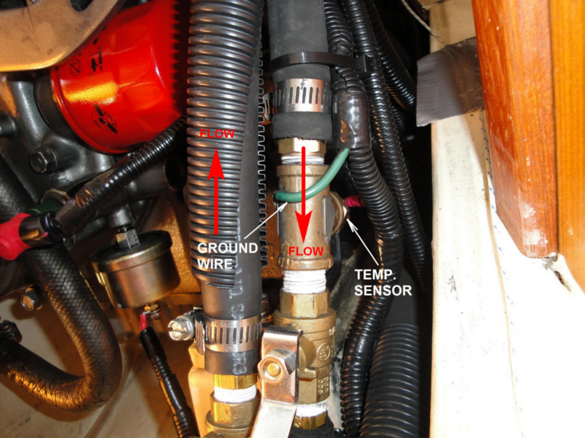

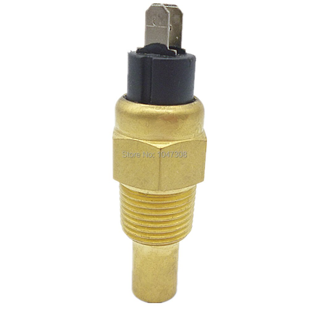

Do you have a second spot on your engine block to attach a Temp Sensor? On my Perkins I have 2 threaded spots to use a thermostat or Temp Sensor. One is set in the block near the pump which provides water temp for the gauge. The second is near the other end of the block, I put in a temp sensor that is set for 200º. This is triggers the ALARM.
They come in various sizes.

Do you have a hot water heater which uses engine water for the heating medium ?
If so, plug in a brass "T" and screw in a temperature Xmitter. You'll have to make a ground for the Xmitter.
