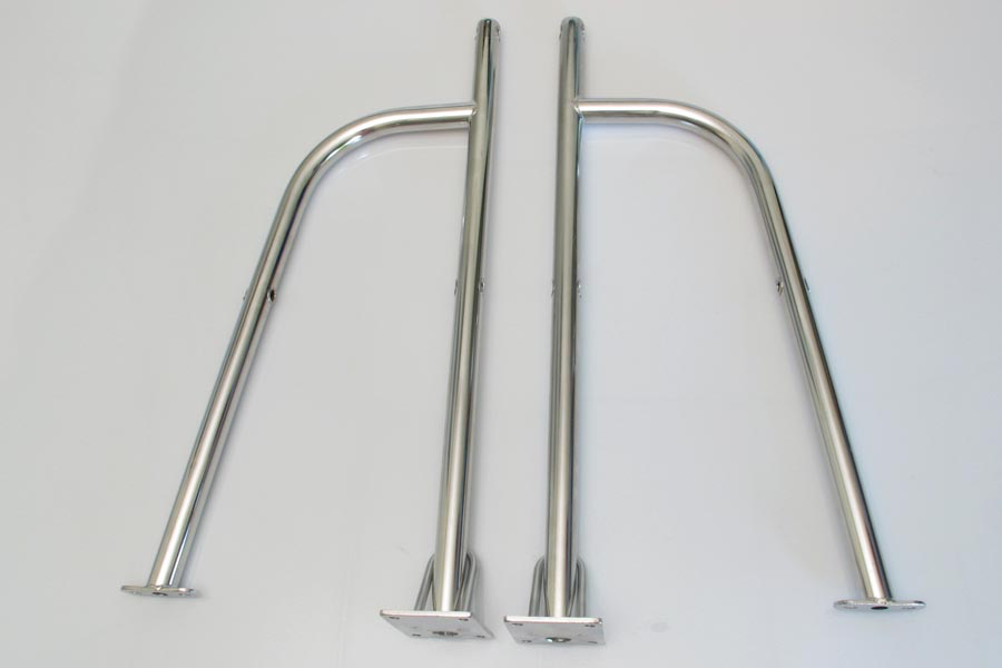

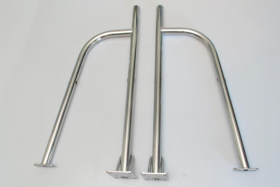

The lifeline gets terminated on either side of the gate. Since your going to be putting some stress on the lifelines you cannot just leave a single pole stanchion at the gate. It needs to be braced. Here is what a sample gate stantion looks like.
There are several variations to this basic design. I found mine from RailMakers of Everett WA. Mine use through bolts to attach the stanchion to the deck. The gate is between the 2 long vertical posts. The side posts act to brace the main post from bending.
You can use a pelican hook to latch the gate. The material can be wire, or as I did dyneema.
Take a look around your marina to see the various designs, then choose one that meets your needs.
