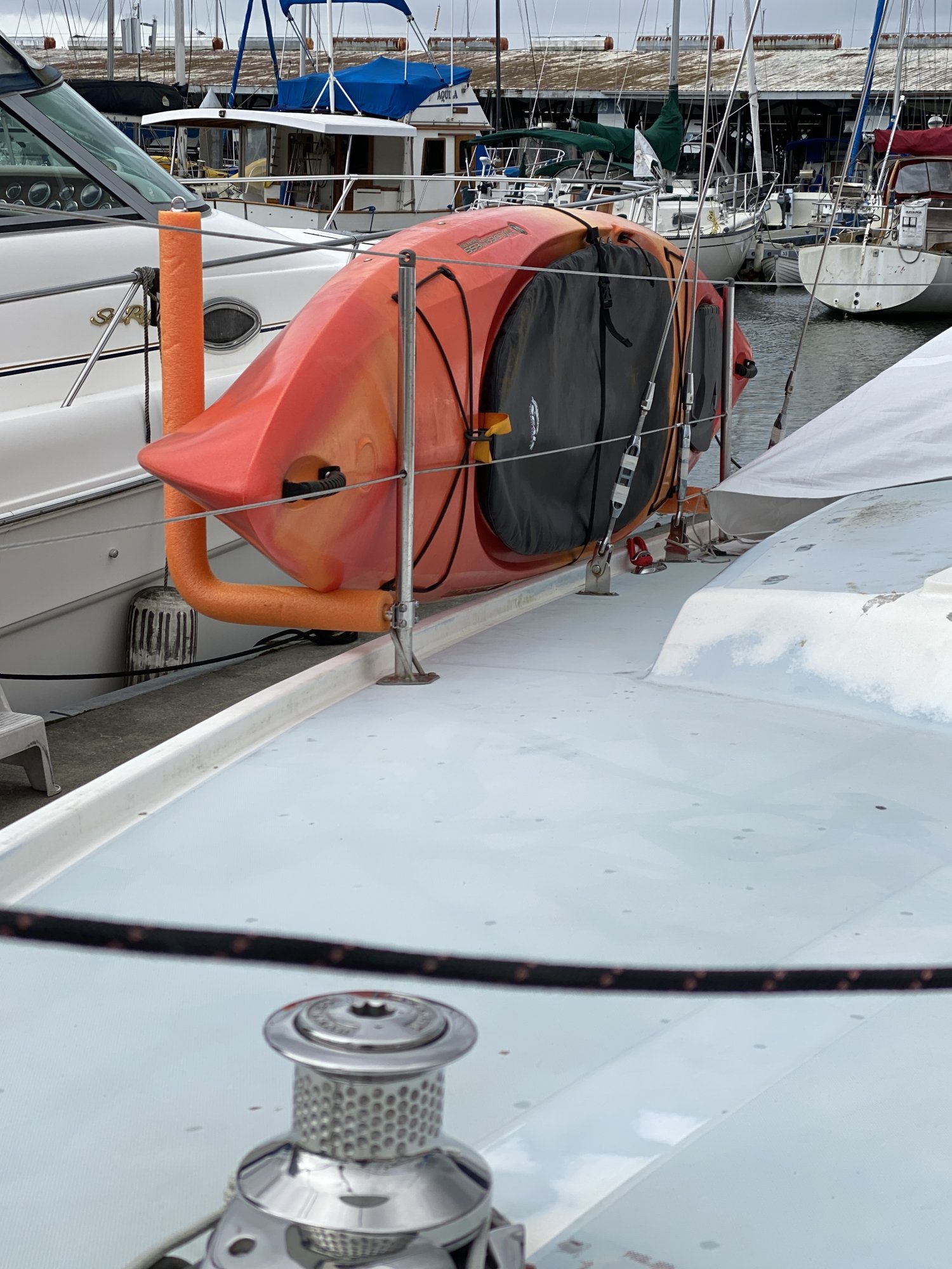

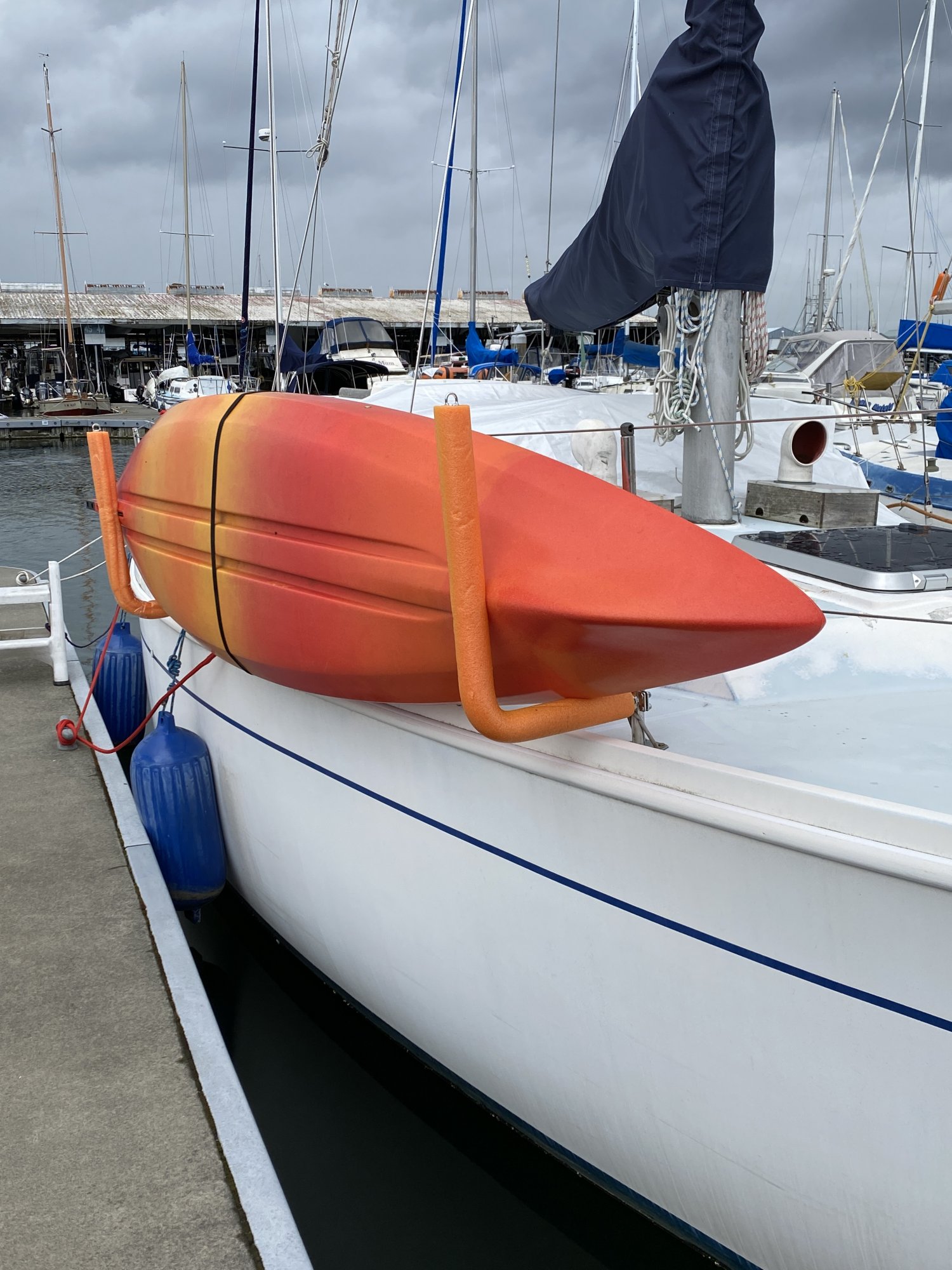

Moved the kayak up from the house. Installed a pair of holders to the starboard stanchions. Got them from Fisheries Supply. They are stainless1” tubes. Sturdy 4 bolt clamps to the stanchions at the base. I used a pair of swim noodles to provide cushion for the boat.
going to use the padeye loops on the top to tie the kayak to the stanchion base. Tomorrow I’ll be giving them a test to see how it works. Fingers crossed minimal affect on the boats sailing.

I frequently see those racks used on both motor vessels and sailboats. I believe if the kayak is very well secured you will not have any issues. I tried those exact ones with an inflatable kayak but could not get straps snitched down so that I was confident that the kayak would stay put. I was concerned that it would be one more thing to have to worry about if things got hairy.

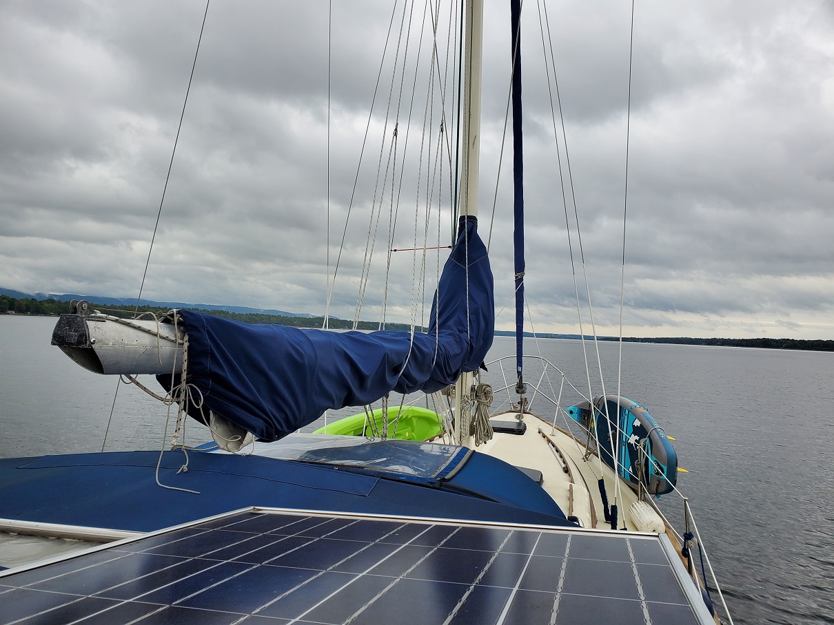

Looks good, let us know how it works out John, I may get a set of holders like that. I currently have the kayak inside the lifeline on port and I put the paddle board outside, resting on the cap rail, on starboard. It would be nice to clear up the foredeck a bit more and get the kayak outboard as well. One concern I have is jib sheets or mooring lines snagging on the supports.

We have the same carriers and have used them with the Pelican kayaks that we got from Costco, and now with a pair of Advanced Elements inflatables. We have been very happy with them. When we are not going to be needing them for a while, I loosen the clamps and pivot them back against the lifelines. I do notice that the kayaks add noticeably to our windage when docking in a crosswind.

I had the same on the last boat, and have em on the current boat too. I noticed upwind performance with a kayak loaded was affected on my 30 footer quite a bit. Current boat they're just used to store the inflatable kayak while in the slip. Underway, I deflate the kayak.
Plan on rebedding those stanchions more often. Carrying a kayak definitely caused some leakage. When I was carrying a kayak on a passage I'd run a line from the ring on the mast to the padeyes on top of the carriers to give more support.

Kayak worked fine in calm seas. Sailed in about 8 knots of wind off the aft beam. Genoa unfurled and furled with out any hiccups.
nice when I took the picture. Poured down rain the last 2 hours.
