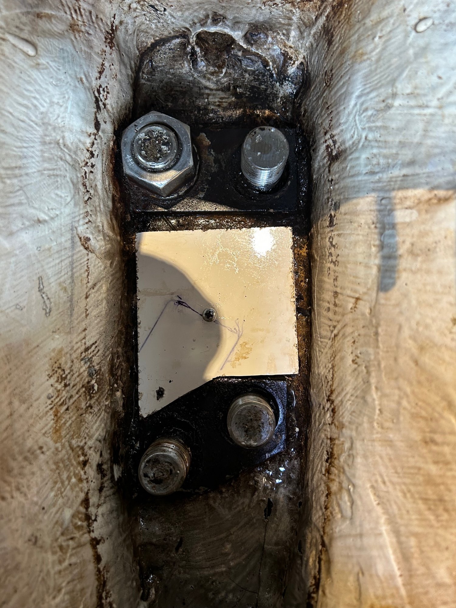

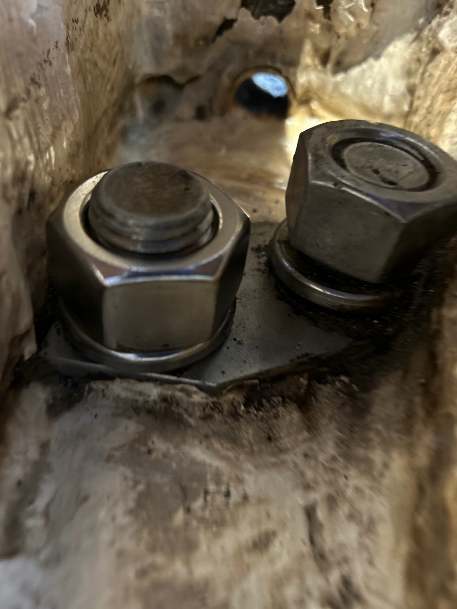

I have a diaghragm pump and the hose pick-up is at the low point so after pumping there is very little water remaining. I typically have a dry bilge based on the external environment. I typically have water from the A/C condensate, defrosting the fridge, or the leaky vent line from my forward water tank - all things that I could fix or modify. I'll have to admit that I'm a bit obsessive about drying the bilge every time I leave the boat. I typically wipe down the bilge with a rag to get every last bit of water. I get frustrated by the water that gets blocked by the plates.
The bottom photo shows the area that I would smooth out with epoxy. The top of the photo shows the lowest point in the sump where the hose pick-up is (not there in the photo). I wouldn't put any epoxy there because it is the low point. My intention is to just pour it high enough to be flush with the top of the plates so the water would flow just across and not be trapped.
The only thing that bothers me about the water sitting in there is because the fiberglass is typically uneven and the plates surely don't sit evenly, unless there is a bedding of material underneath the plates (which I'm pretty sure there is). My mind would be eased if I felt like the bolts were not exposed to latent water underneath the plates.

The middle fiberglass plate is where I mount the float switch. It is epoxied in place.

If you're going to fill this, gel coat might be a better option. First it is cheaper. Second, if it ever needed to be removed it would chip out more easily than epoxy. Third you could easily tint it, anyone for Hot Pink? Neon Green?

@Scott T-Bird thanks for the photos.
In my opinion, this is not a good idea to fill with especially epoxy. There are two fundamental problems:
1) It would be impossible to get a perfect seal - especially between the plates and your fill material. This could cause the creation of localized corrosion locations that would be invisible and more damaging than your current set-up. This could happen no matter what kind of "fill" you might choose to use.
2) If you needed to address this in the future - it would be really hard to remove that epoxy and then pull those plates.

Alright - I see what you're trying to do here and I'm getting gunshy. The glaring problem I see is that you're not going to have a good surface to bond the epoxy to where the sealant is potentially squeezing out around the keel bolt backing washers. I think there's a decent chance for water to get around that area, which isn't great. On top of that, it will make this area essentially uninspectable for water intrusion; also not great. You're kind of shooting yourself in the foot by trying to make a fair surface around the keel bolts/washers to drain water, but introducing joints between sealing materials that probably won't perform well over time. This is exactly what @dLj is saying. I think to do this right, unfortunately, you would need to drop the keel, or at least pry off the backing washers (which I wouldn't mess with to solve a nuisance problem like this), fair out the whole area, and reseal the bolts. Even then I think this project would take a fair bit of forthought and planning since you'd be potentially starting to get into how the keel bolts transfer force into the hull.
Epoxy is generally pretty workable with sanding/grinding tools, especially when it's modified with fillers. But in this case the geometry is so restrictive and you're dealing in such close proximity of the seal with the backing washers, I'm just not sure that it's wise to refair this area.
Consider putting the effort into rerouting condensate drains to shower boxes and maybe fixing that leak you spoke to? Your bilge won't be 100% dry still, but there will be a big improvement in how much water you take on down there over time.

I guess I'm going to be disagreeing with the group here on this one. I don't think there's anything wrong with filling this area with epoxy that's thickened with the right filler. This is done very often on the outside of hulls to fair various surfaces. It's even done to fair keel joints, and to make the seal between hull and keel joints.
Epoxy with filler is a pretty ideal material for something like this. It will stick tenaciously as long as the bonding surface is clean and prepared (sanded to give it tooth), which will keep any chance of cracking around the edge and water getting under the material down . It's unlikely that it will crack since epoxy generally has a higher tensile elongation than polyester resin-based GRP.
I did a little more research on this on the side, and it may be wise to call up West System, or the technical support line of whatever epoxy system you would use, and ask them about what filler to use in this application. A low-density filler that would make this easy to sand would 'probably' be OK, but I would double check since this area is under some stress and probably needs to breath a little bit. I would be very surprised if a naked epoxy ever cracked since its tensile elongation is probably 2x what the tensile elongation of the underlying GRP is, but once you start modifying the epoxy with filler it can make the epoxy more brittle. The key is striking a nice balance between pour consistency and sand-ability after it cures. Epoxy is very flexible in allowing you to come up with the best end material using different fillers and proportions of said fillers.
I have had a lot of great luck with West System's tech support staff. They have usually been very helpful and are very experiened in boat-specific applications.

Yeah, that's basically the reason I asked this question. It's not really a big deal. I would just like to make my periodic bilge clean-up a bit more satisfying. I'm not that concerned about creating a condition that may seal in a bit of moisture. In my mind, the moisture is latent around those joints anyway. I'm just trying to make it easier for the little bit of moisture to make its way to the low point. Gel coat could work just as well. But the amount is so small, the expense isn't a consideration.
@American_Mainsail mentioned thickened epoxy as a consideration. I have Thixo that can be applied and formed just as easily as caulk ...
I'm still mulling this over. It's not a high priority and I'm not trying to fix any damage.
Those photos really make the bilge look awful! I really want to clean it up a bit more and eventually apply some Bilge Kote!
