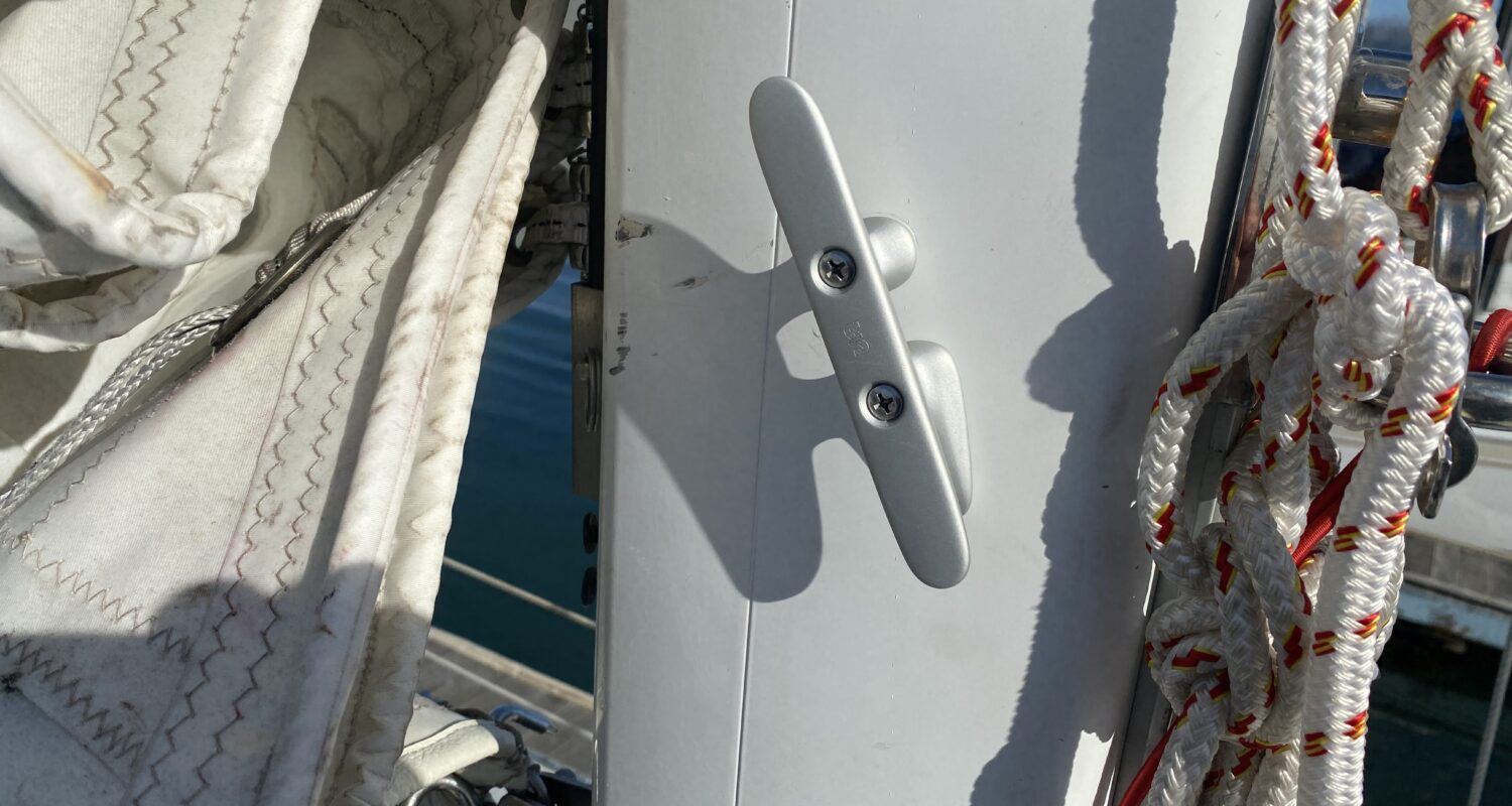

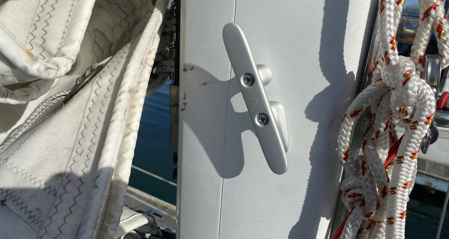

A wide based cleat like that will probably not match the round contour of the mast. Part of the base will be sticking out ready to chafe lines or hands and legs. You’ll need something narrower and/or shaped to match the rounded mast profile.
24,457
Something like these can work.
You can use screws or rivets to attache them. I prefer to drill and tap the hole for a screw.

The cleat you pictured is better suited for a mooring cleat, on the boat or dock. Dockside cleats are normally galvanized, whereas mooring cleats for the boat will usually be aluminum, or stainless steel. The open base design is preferred here. For a horn style mast cleat the smaller footprint design would be preferable. I like the resin composite type, horn with closed foot. But aluminum is good. The advantage of the horn cleat are price, narrow footprint and convenience for stowing the coiled line off the deck. For lines that eed adjusting more often there are other options, for instance I had a cam cleat on the mast of my Nacra to control the 2:1 jib halyard. You'll also see clutches on the mast when there's a winch involved.
To figure the right size, make sure there's room for the extra loop you'll slip over the horn to contain the coiled line.
