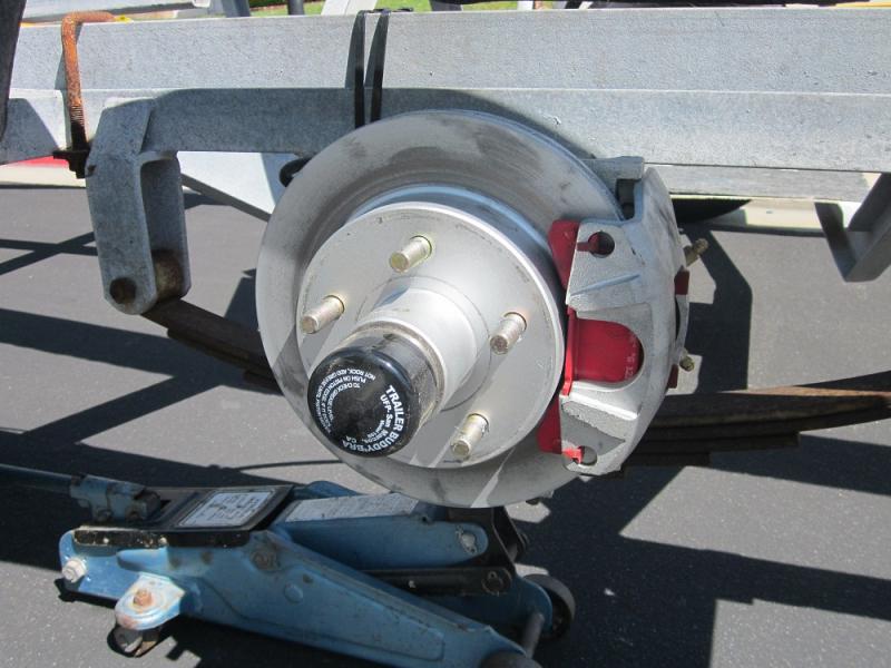

Earlier this year I needed to repair my surge shoe brake system on the trailer towing our C-22. I don't know anything about trailer brakes, so I went to a trailer repair shop that specializes in boat trailers. I too asked their opinion on going electric so I could apply some braking going down the mountains. I also questioned them about the pro's and con's of shoe brakes vs disc brakes. They recommended going with a disc brake system. One reason is that 95% of my trailer launching is in salt water. They also didn't recommend electric brakes on a boat trailer. They're not designed for constant dunking, and told me they would be a problem,(granted, it was their opinion, and I'm sure there are many happy boat trailers with electric brakes).
They installed stainless steel rotor/hubs with aluminum calipers, and a new surge hitch. They told me the aluminum calipers were cheaper than the stainless steel ones, and either way, in salt water, they need to be replaced every 6-8 years. It was almost as much to rebuild my old hitch and convert it to the disc application, so I went with a new hitch. One issue with disc brakes is that they work equally as well going reverse, as going forward. So they installed a solenoid valve that when I put the truck in reverse, the back-up light circuit energizes the solenoid and stops any hydraulic pressure from the brakes. It has worked flawless over pulling the boat around 6,000 miles this summer with an elevation change of minus 132'below sea level, to over 10,600' crossing the mountains in Colorado. I couldn't believe the difference from towing the boat before with no brakes. It was so much less braking required to stop us. My opinion, I really like my disc brake set-up.
Don
