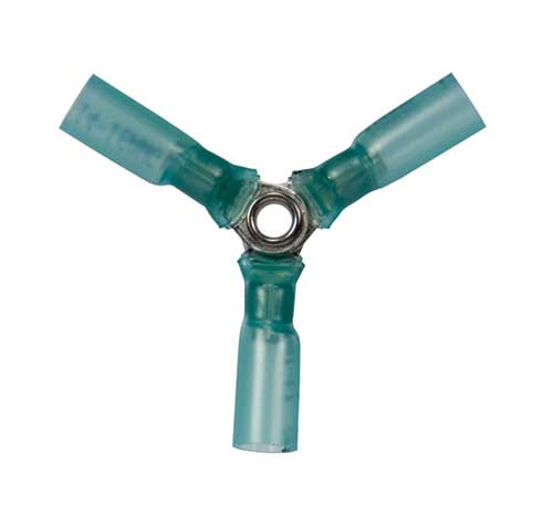

If you end up splicing into the wire, the best way is to use one of these heat-shrink 3-way connectors:
Actually one of the worst things. The reliance on the center hole to maintain continuity has been suspect for quite some time, and Maine Sail warns against using them. Find another way to do a 3 way splice...easy enough to do.

I stand corrected, thought they were the way but never used one myself. Though it sure beats the splices I've seen where people cut into the wire and tape it up.
