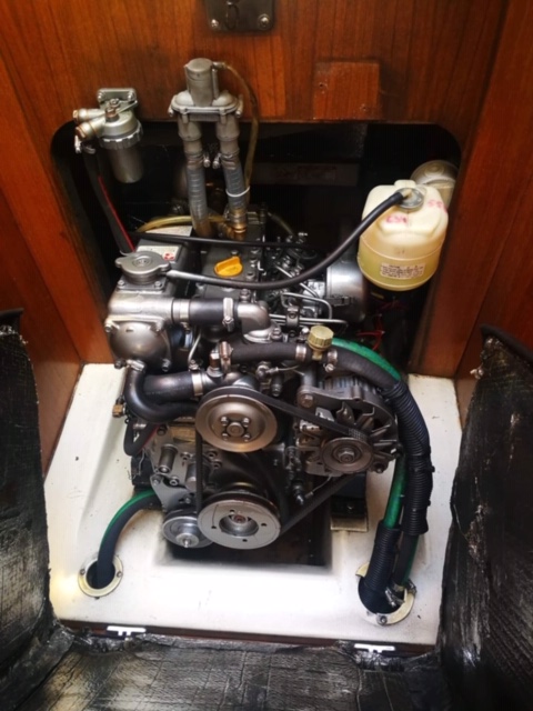

I had bleed problems too and thought about an electric fuel pump. I finally settled for an in line pear pump the same as on out outboards. Pump it three times and its done ;)
Then I learn't how to bleed the yanmar by opening the decompression levers. Its a doddle. I wired a push button to crank the engine on the side of the engine compartment. Open the 3 decompression levers. Then with a 10mm spanner open the bleed screw and crank the motor for about 3 to 5 seconds... the diesel spurts out so just reclose the bleed screw. Close the compression levers and just restart the engine :)
I've since installed the fuel filter in front of the engine compartment for easy access :)
You can see the starter button just behind the coolant tank. The fuel filter in front for easy access.

Secret Sail - Thank you for sharing the photo. The relocation of the fuel filter off the engine and on to the bulkhead is brilliant! Mine is down low on the starboard side of the engine requiring me to jam myself down into what little space I have in the galley to access it. The previous owner cut away part of the engine compartment to make it more accessible. Your solution is much more elegant and I am going to guess quieter when the engine is running.
