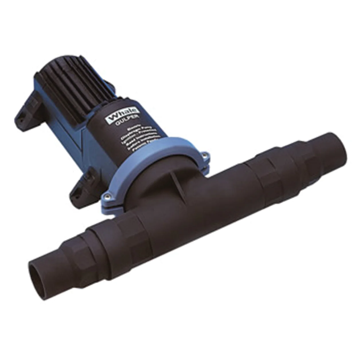

  • The RV valve makes me cringe if it is to stop raw water from entering the boat. I have seen those valves on RVs dribbling a bit of tank water as they drive down the interstate. I suspect you plan to use a standard through-hull valve to ensure that raw water is stopped at the hull. The RV valve would be between the through-hull valve and the tank. Not sure what will happen if something gets clogged on the lip of that vertical gate.
  • Reading @Peggie Hall HeadMistress information, she suggests that there is no need for a macerator as the toilet paper and human waste become dissolved in water when aged in the holding tank for a couple of days. You just need to manage what goes into the tank.
  • I have installed a Whale Gulper Toilet/Waste Pump, 12V to evacuate the effluent from the holding tank in open waters. 1780075946089.png
    • Ideal for emptying holding tanks and vacuum systems.
      • Non-choke valves are virtually unblockable
      • Can run dry without damage
      • No air locks - can pumps air/water mixture
      • Large single diaphragm pumps up to 18 litres (4.75 US gal) per minute
      • Rotatable head allows flexibility when installing in awkward locations
      • Self priming up to 3m (10 ft.)
You will need to have a way to show that the pump over the side plumbing is locked while in controlled waters.

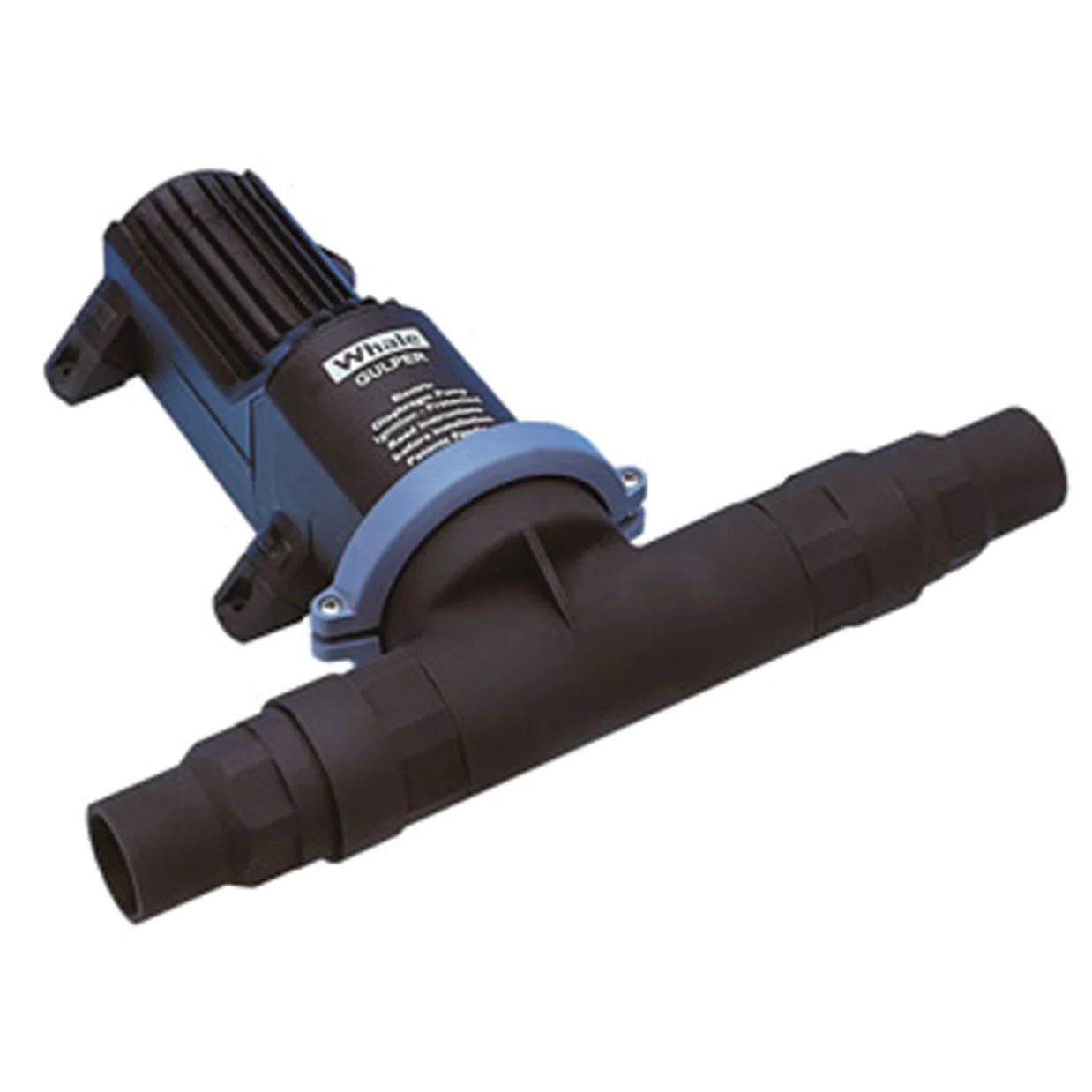

  • I have installed a Whale Gulper Toilet/Waste Pump, 12V to evacuate the effluent from the holding tank in open waters. View attachment 237949
  • RV 1½" gate valve would go between the tee from the tank and the macerator. The outlet from the macerator is a 1" hose and it would go to a standard Series 93 Marelon seacock.
  • Good point. I use Norflex Digester and it does an excellent job of breaking down the solids.
  • I will look at that pump. My understanding is that removing the handle on the valves is sufficient for the no discharge rule.
