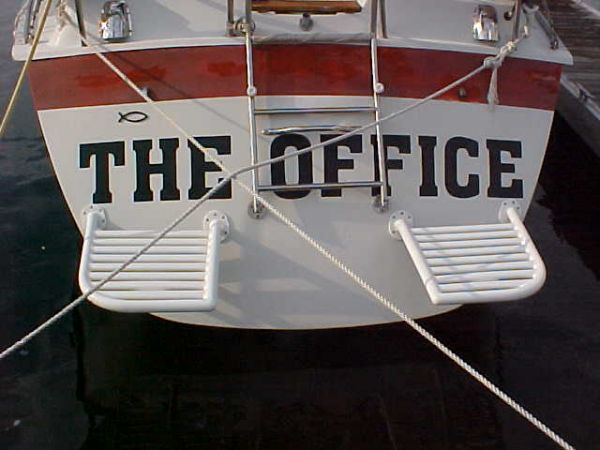

A friend added two metal swim steps outboard of where his ladder folded down. He found these acceptable although he wold have used stainless if he could have found them. I forget whether they were fold down/flip ups or fixed, IIRC they were fixed. Works for him at home in British Columbia and for their trip to Mexico.
http://c34.org/bbs/index.php/topic,4456.15.html

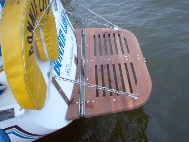

Here are two pix of different solutions to your question...
That teak platform is a monster! I'm thinking "dance floor" Wonder how much the owner spent on it.
Biggest issue for me is not getting in and out of the dinghy.... but can I get out of the water!!! Both need a fold down, weighted step ladder.

That teak one is on the back of a Hunter 31, which tapers toward the stern and inward to the waterline, same as my H34. I don't think its quite as big as it looks.
Also, when powered up, the sterns of these boats squat so I would expect that the platform is pretty close to the wave tops then.
