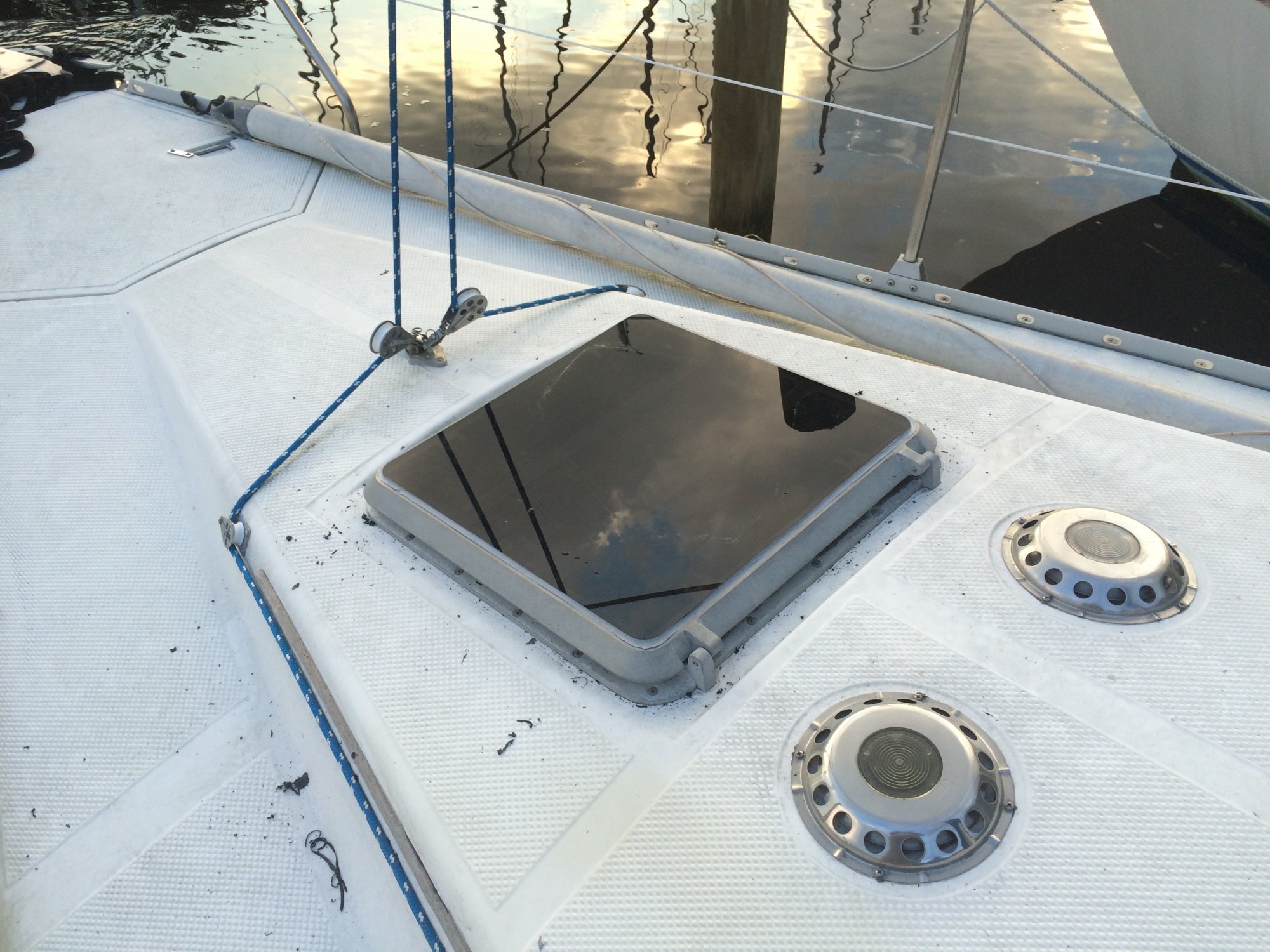

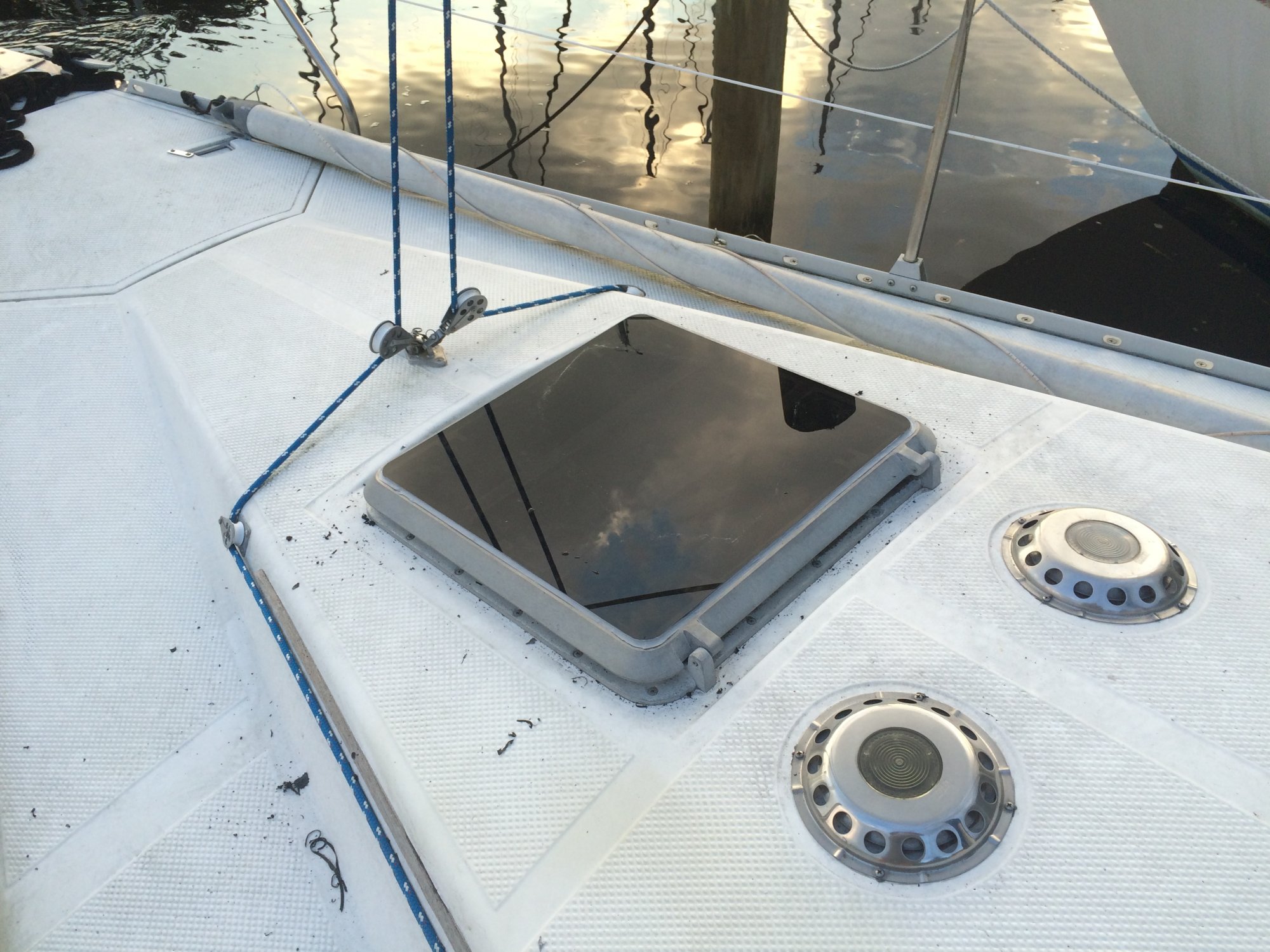

My PO installed a spinnaker pole downhaul point just forward of the front hatch. He also had a lightweight staysail that can be set inside the genoa in light air. The deck is not reinforced sufficiently for large loads on that pole downhaul point.. I have set the staysail in light air, using that point for the tack attachment. I have always thought that a deck reinforcement could be rigged from under the deck to the large pan in the vee berth to let this work for a heavy air small sail.. (storm staysail?) A piece of dynema could be rigged so that it could be removed when using the vee berth.. You can see from the vee berth picture where the liner was cut in order to put in the reinforcing plate .. I haven't done the reinforcement..
Jan 26, 2024
6
Hunter 34 Selby Bay
View attachment 222828View attachment 222829

I fly the light air sail from the pole uphaul (topping lift) which exits the mast just below the upper spreaders.. I don't think there would be a problem in the light air, but .. if set in heavier air, the spin halyard or the other genoa halyard would probably be better to avoid pumping.. Because of the natural bow in the mast, if the heavy air staysail were to be set in that same place on the mast, I think running backstays might be necessary. (mounted at the same level as the halyard attachment..). I have not done any load calculations, but that is kinda my gut feel.. If set from the spin halyard or a jib halyard , there'd be no problem.
Thanks again. I had also thought of using the pole topping lift as the upper end staysail attachment. I'm wondering if I use a wired luff on the sail, whether I can just raise the sail using the pole topping lift and do without a separate stay. I could use the spinnaker halyard to raise a sail on a temporarily fixed stay, but would this accomplish anything vs tensioning the wired luff? I figured some kind of running back stays would be necessary. Options would be to attach these to the genoa tracks or the toe rails. Any thoughts on that? I''ve also wondered if there is a way to rig a bridle of some kind to serve as the tack attachment point.
10,195
My light air staysail has a wire luff; I don’t have an extra stay . It sets well . The aft toenails would be fine for runners attachment.
a bridle could be made to work for the tack. First thought is running Dynema between toe rails with a hitch in the middle to attach the tack shackle. That would raise the tack a foot or so.

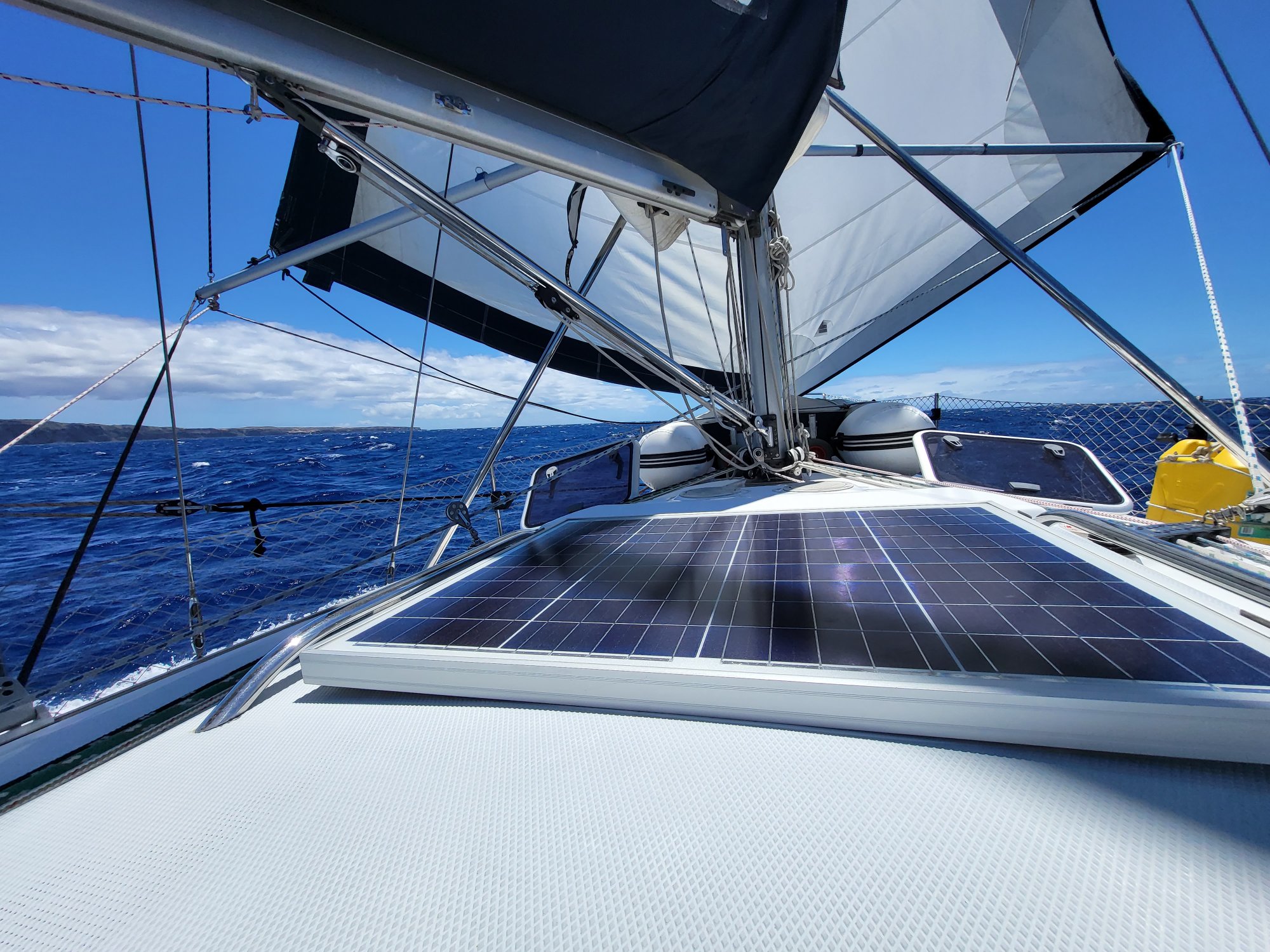

I did it on my 410. But there was an option on my series for it. Mast had a forestay attachment point, halyard exits and chainplate attachment point. There was also plenty more deck hardware needed for the 2 sheets and halyard.
With your 2 reef lines (I have 3) that should all run back to the cockpit you'll need extra rope clutches, deck organizer to line up the lines not to mention sheet hardware, double turning Block at winches.
Roller furling is the way to go.
I wouldn't be without it, but not sure if the 34 can be converted, my previous boat was a h34.
2 reefs in, small sail out only I happily scoot along in 30knots true wind.
Did a 5100nm Hawaii and back to CA this last summer, singlehanded with the set up.

The deck hardware and positions are kind on critical to make it work good.
While a super tight halyard on a sail may kind of work upwind any sag in tension during high wind will diminish pointing ability.
You really need a forestay at the aft edge of the anchor locker, it should be a bulkhead if I remember corectly.
You'll end up needing to mount the first sheet blocks up on the coachroof cabintop, probably where the screws are.
Then you'll need to run it somewhere....
The sheet blocks on the track are way too far outboard to use.
It ended up being an expensive upgrade to really do right. I wanted everything in place, ready to go. You just want to avoid going up on deck while sailing offshore
