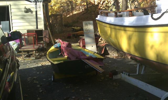

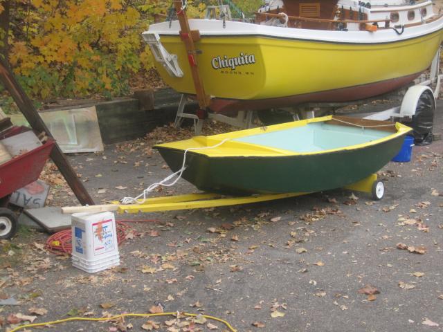

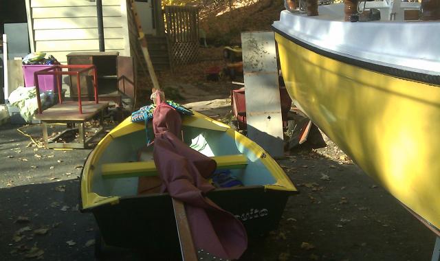

I recently acquired an older fiberglass El Toro sailing dinghy from Craigslist (for $95!) She needed a little paint but is structurally sound. I'll be using her as a sail trainer for my 10 year old and as a tender to Chiquita. I've had her out on the water just once (our boating season is about over.) She sails great; much better than the 8' Sinbad we had been using. The El Toro is also much more stable than the round bottom Sinbad. But she rows like a bowling ball.

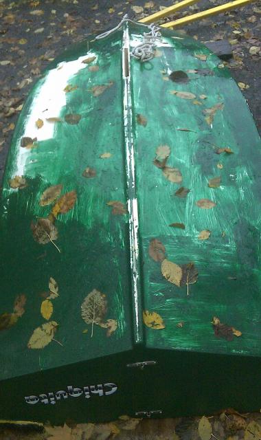

I wonder if adding a skeg would improve her rowing characteristics somewhat. How would I go about doing that? I was thinking about adhering a 3' X 5" triangular board to the bottom with epoxy--after grinding off the gel coat. But there is a lip/seam running the length of the boat where the two molded halves were fiberglassed together. This pretty much rules out the use of mechanical fasteners. The seam forms a (sort of) 1" X 3/4" keel. Should I mount the skeg directly on to this "keel" and add epoxy filets for strength? Or is the whole skeg idea not worth bothering with?
Also, as long as I have the epoxy out, what do you think of glassing a layer of carbon cloth to the bottom for wear protection? My method of launching the boat involves sliding her across the grass and then down a 10' wooden ramp.
