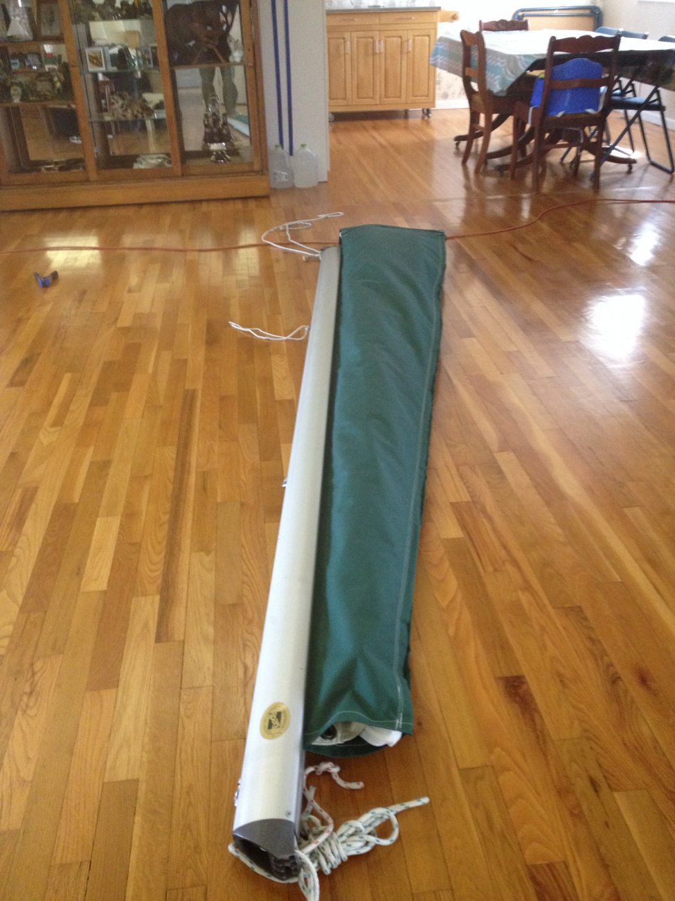

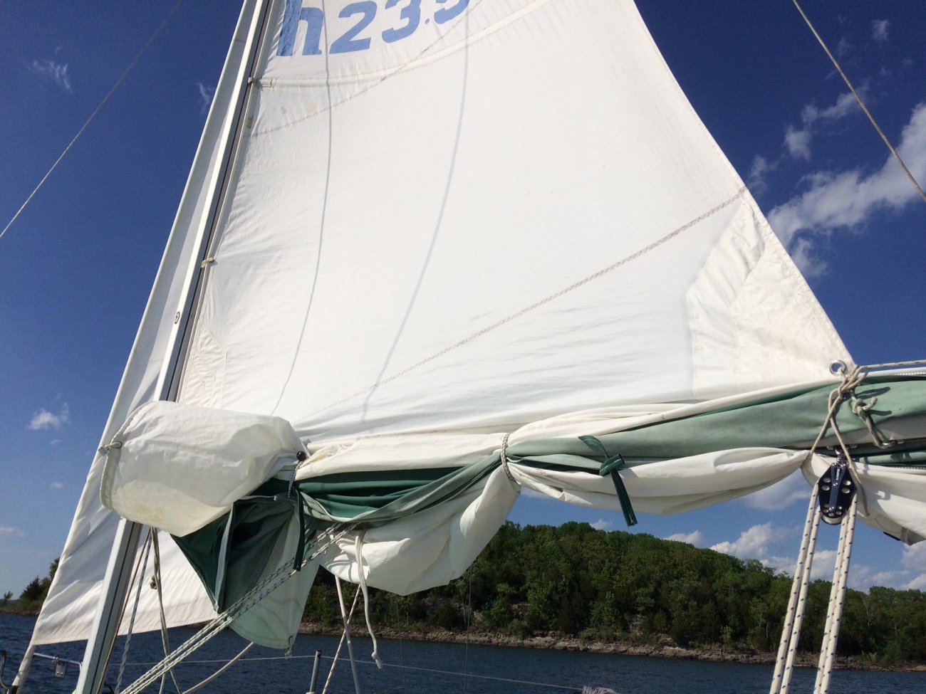

The subject of stack packs and lazy jacks has been raised a couple of times in this thread so allow me; if you please to also weigh in. I made a lazy jack system that I used for ones season and though I loved being able to capture the main when dropping, the rigging/un-rigging annually or more often was a pain. Lazy jacks integral to a stack pack would be even better but still the additional rigging issue. I'm with Dave on that issue. Still, if you're not un-stepping the mast frequently, you'll love lazy jacks.
So let me offer a compromise solution. I made a stack pack with no lazy jacks but with integral sail ties. I can flake the main from the rear and move forward tying it as I go. Then zip it up. When it comes time to trailer I release the sail slugs from the mast and remove the boom; sail and all, and store below. The out haul, reefing line, and topping lift all stay rigged in the boom. ( the topping lift boom portion clips to the mast portion with a leash clip,) The pack wraps around the bolt rope in the foot of the sail and slides into the boom. For a loose footed sail a bolt rope would be sewn into the bottom of the pack. After sailing the halyard gets moved to loops on the pack to support it.IMG_1382.JPG IMG_1391.JPG

Last year I had lazy lines and the boat needed a new mainsail cover so to me the obvious path was a stack pack, DK, I can't believe you are complaining about taking an extra 5 minutes to undo the lazy's,
So let me offer a compromise solution. I made a stack pack with no lazy jacks but with integral sail ties. I can flake the main from the rear and move forward tying it as I go. Then zip it up. When it comes time to trailer I release the sail slugs from the mast and remove the boom; sail and all, and store below. The out haul, reefing line, and topping lift all stay rigged in the boom. ( the topping lift boom portion clips to the mast portion with a leash clip,) The pack wraps around the bolt rope in the foot of the sail and slides into the boom. For a loose footed sail a bolt rope would be sewn into the bottom of the pack. After sailing the halyard gets moved to loops on the pack to support it.View attachment 163578 View attachment 163579
I've answered to this on the dedicated post to the subject "Stack Pack"
