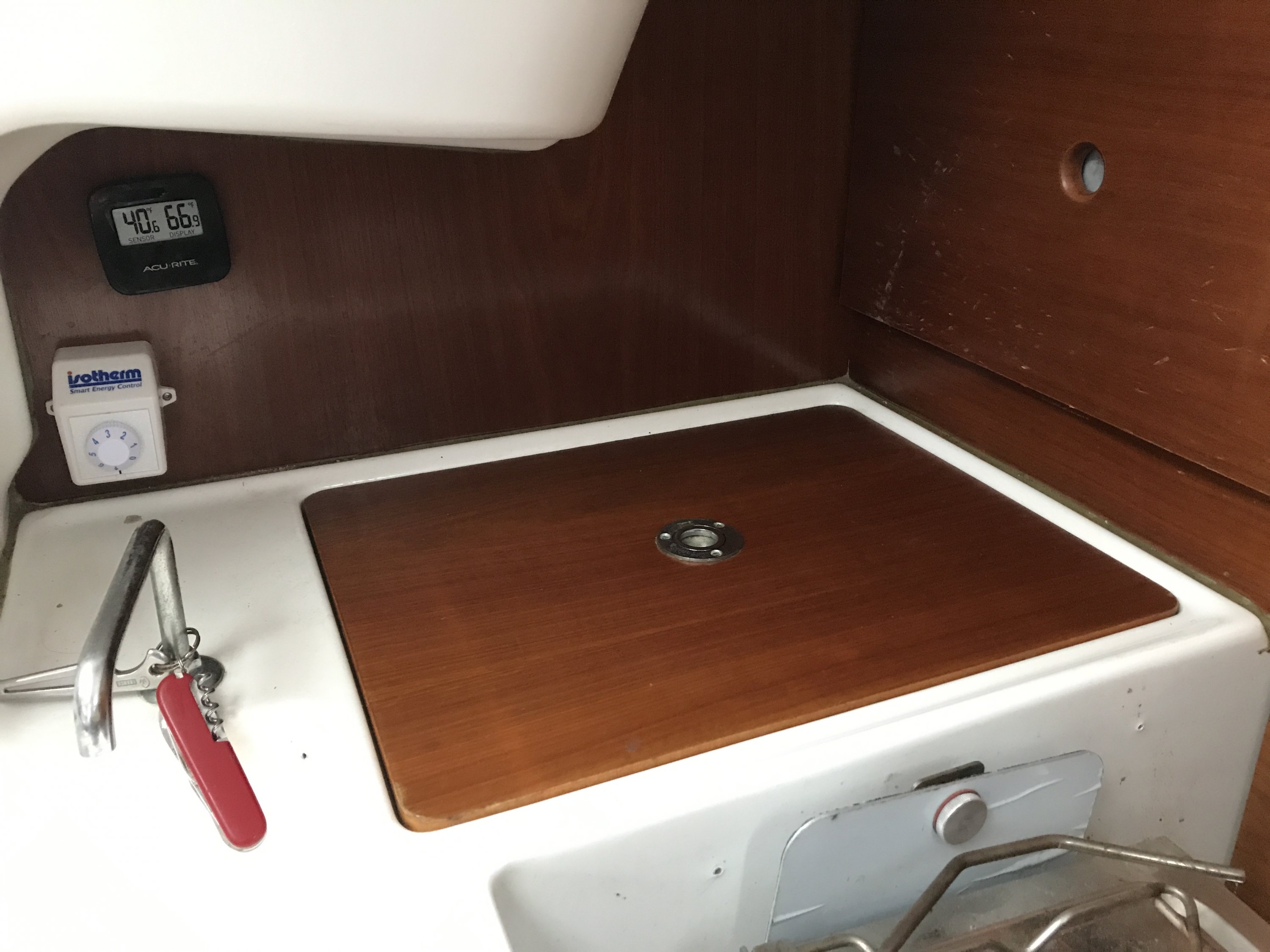

I would. I have a digital thermostat probe in the the ISEC sensor housing and it goes (along with the whole box I assume) to 34f while charging. After a day on the water sailing, it controls at 40.5F.

Does your unit have an evaporator or cold plate? It seems to me that this will make my evaporator work more like a cold plate but one thing that I wonder about is will still be able to keep frozen items inside the evaporator. Those of you will cold plate refers, do you have a freezer section or is everything at refer temps.
