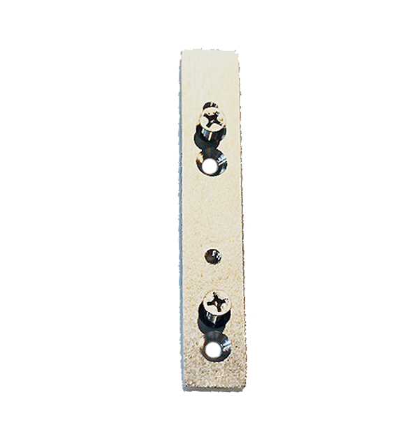

I ordered those plates from Garhauer after reading your post Ted. I never liked the clam cleat set up for my main sheets, they slipped too easily and I only ever used the starboard side sheet through the topside winch.
I ordered the plates and subsequent clutch. It cost about $200 for the 4 pieces with shipping from CA to NY.
I have a 1997 Catalina 380 and when I went to install the plates, they were a bit off. The holes to hold the bracket to the topside were just about 1mm out of alignment. I tried to bully the bolt but that wouldn't work as it would bind after about 1/4" of turning.
The bracket did come with 2 small 1/4" flat head screws that are about 5/8" long. So I could use the original longer screw on the back side and then the small screw for the front. This worked just fine. All I had to do was go buy 2 new shorter screws for the clutches. Unfortunately, the ship's store near me only had oval head screws so I had to add a locking washer to make them tight.

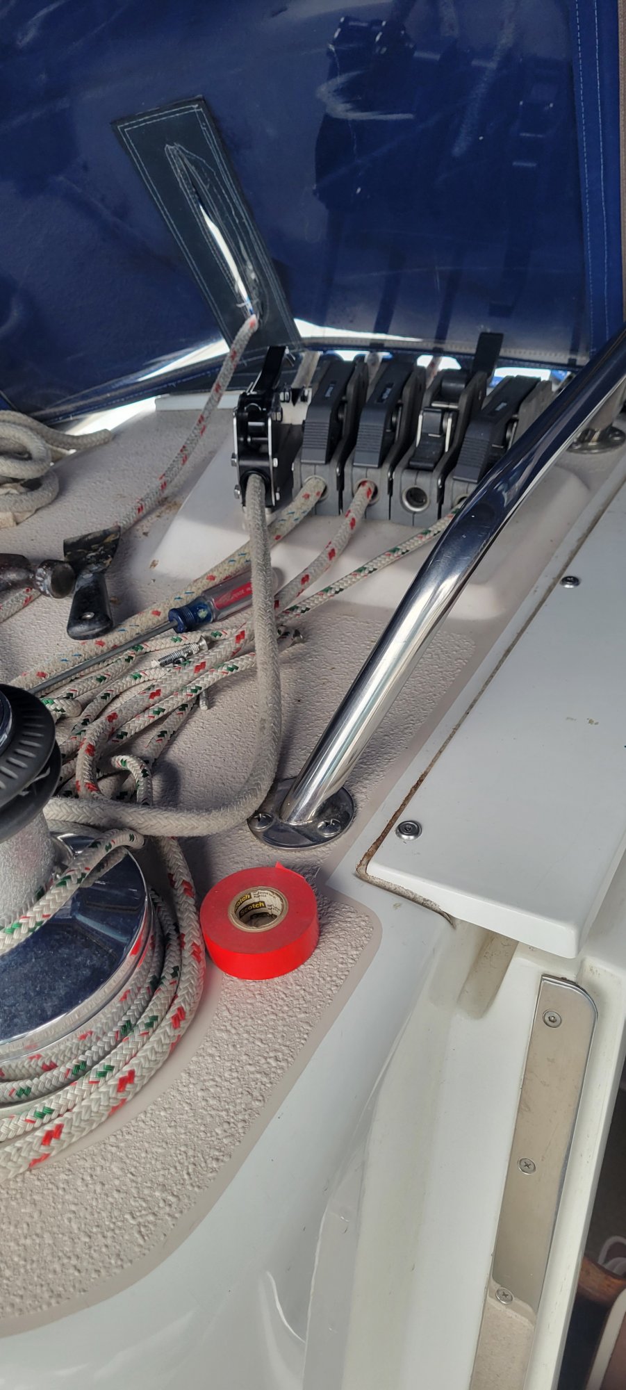

Once done, it was a bit of a chore to feed the sheet through. They are very large in diameter (not sure what, easily 3/4"?). I found that disengaging the clutch all the way and then prying the back of the clutch up allowed me to feed the sheet through very quickly....trial and error!
I feel there is now way too much line for this set up. Since I have clutches, there is no need for the line to reach all the way to the cockpit wheel. I'll have to play with it once I get the boat in the water.
