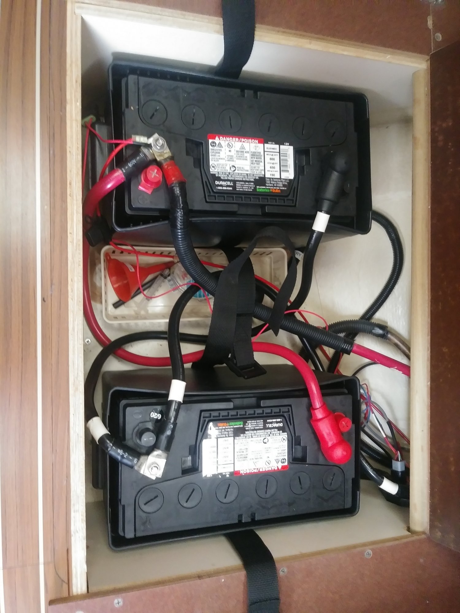

I recently went through the analysis for upgrading my house bank on my 05 Hunter 33. My first choice was the 6v golf cart batteries, but after much time measuring, I concluded that the height was just too tight to fit safely.
In the end I installed two size 31 true deep cycle batteries for the house bank and nothing for the start bank. I use the house bank to start my Yanmar. For emergencies I have a separate portable start/jump battery pack.
My local Costco doesn't carry the size 31 true deep cycle batteries. I got a similar price at Batteries Plus on Duracell SLI31MDC with a rebate.
This gives me 210 ah for about $230.

Are they wired as 1 bank?
Greg
buddy0
Sep 17, 2014
50
Hunter 33 Oriental, NC
Hi Greg. Yes I wired them as one bank.
I have nothing on #2 bank now.
I also have solar panels wired into that bank.
