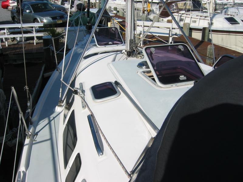

I’m with quadrille38 on this one. Keep it simple. Our 2000 H340 came from the factory with a bow pulpit, three stantions fitted with double life-lines and a stern pulpit (pushpit). The factory installed a “gate” (actually just an opening) between the aft most stantion and the stern pulpit with a simple pelican hook arrangement – no extra braces, etc. – to facilitate boarding the boat near the stern from the side and into the cockpit. We keep our boat in a marina – bow in – and have to board near the bow because of our short finger piers. We installed a second “gate” between the first and second stations by simply cutting the lifeline and installing a pelican hook on each life line. We used a set of gate stops to keep the aft portion of the life line in-place while the gate was open. I believe that we only need the strength and protection of the intact lifeline while sailing and that is when the pelican hooks are used to connect the open ends of the lifelines. You can see our open section or “gate” in the picture below (oops!, the lifelines are hanging in the water for this picture). I think our local rigging shop charged us about $100 apiece to cut and install a quality pelican hook in each lifeline. We have been using this arrangement for well over ten years. If you feel compelled, I’m sure you could add a stantion brace before and after your gate.
