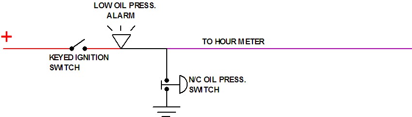

In the past, I have used an electronic relay off the low oil pressure alarm circuit to supply power to a 12V fan. Electronic relay, because it had a 2 mA draw. If the fan had been put across the circuit directly:
1. the oil alarm would always be activated because the fan would act as a ground.
2. the fan would not run because the alarm has too much resistance.
I know, "Big Deal" so much for my case. But here's my point: check out the amperage draw on your electronic hour meter when placed across your 12V battery using a multimeter. If it's only a few mA, you should be able to pull power from your oil pressure circuit without sounding the "low oil pressure" alarm.
I know you know this, but I'll mention it anyway: tap into the oil pressure circuit AHEAD of the pressure switch or you'll be on the ground side.

It's not how much current the meter draws, but a question of "will the amount affect the low oil pressure alarm" ?
Here's a piece of my drawing for the 12V exhaust fan for the engine compartment:

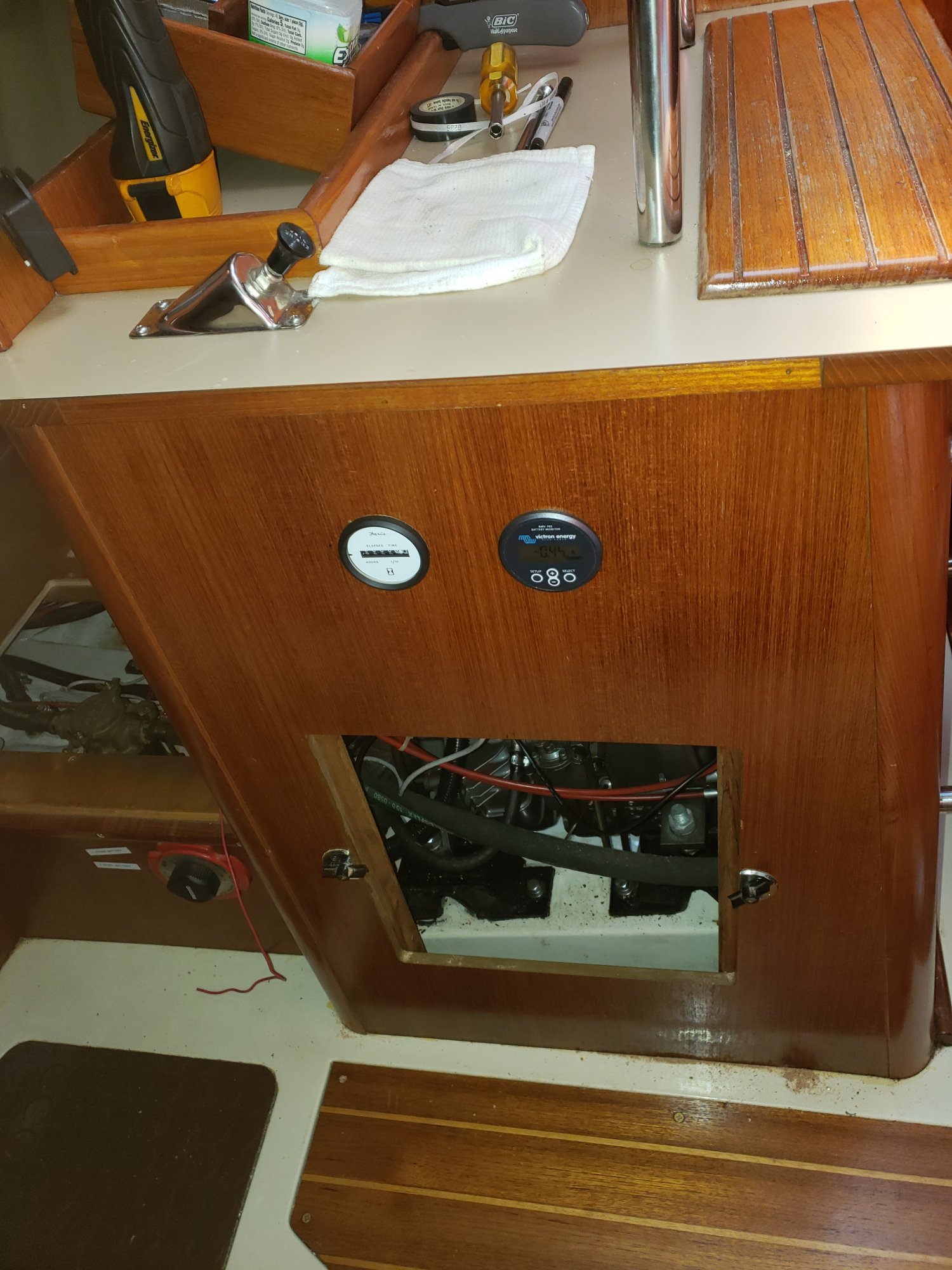

Thanks everyone for your feed back. I'm leaning towards the oil pressure idea. I mounted the meter in a hole that was in the motor housing. There was a fuel gauge that no longer worked and the hole was perfect.
I;ll let you know what I find...

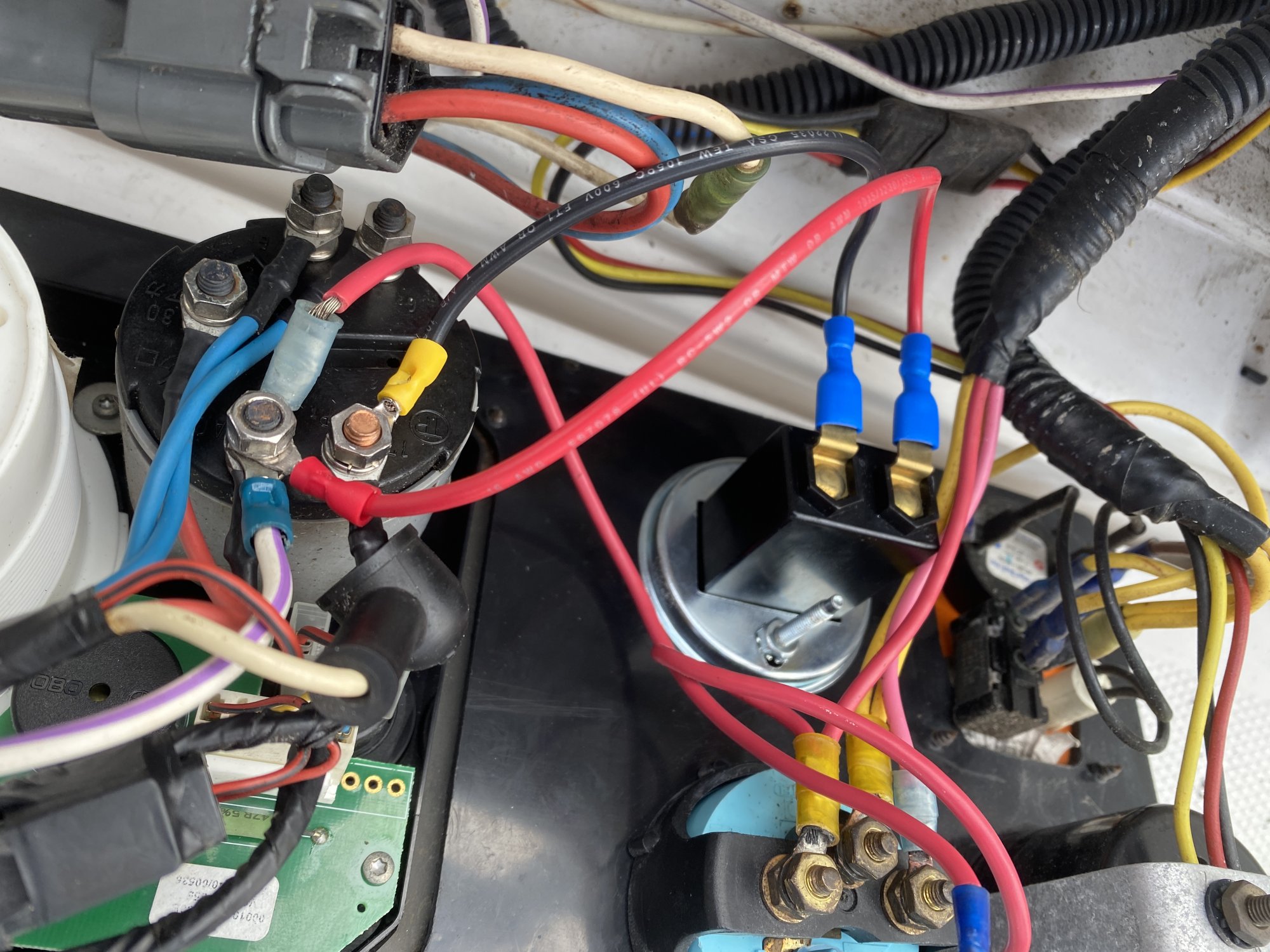

I have a 2004 Yanmar 3JH4E with the simple Yanmar panel. There is a provision for an alarm light for “water in sail drive”. Since my boat came with shaft drive, I located the wiring for this in the engine compartment and used that wire for the hour meter.

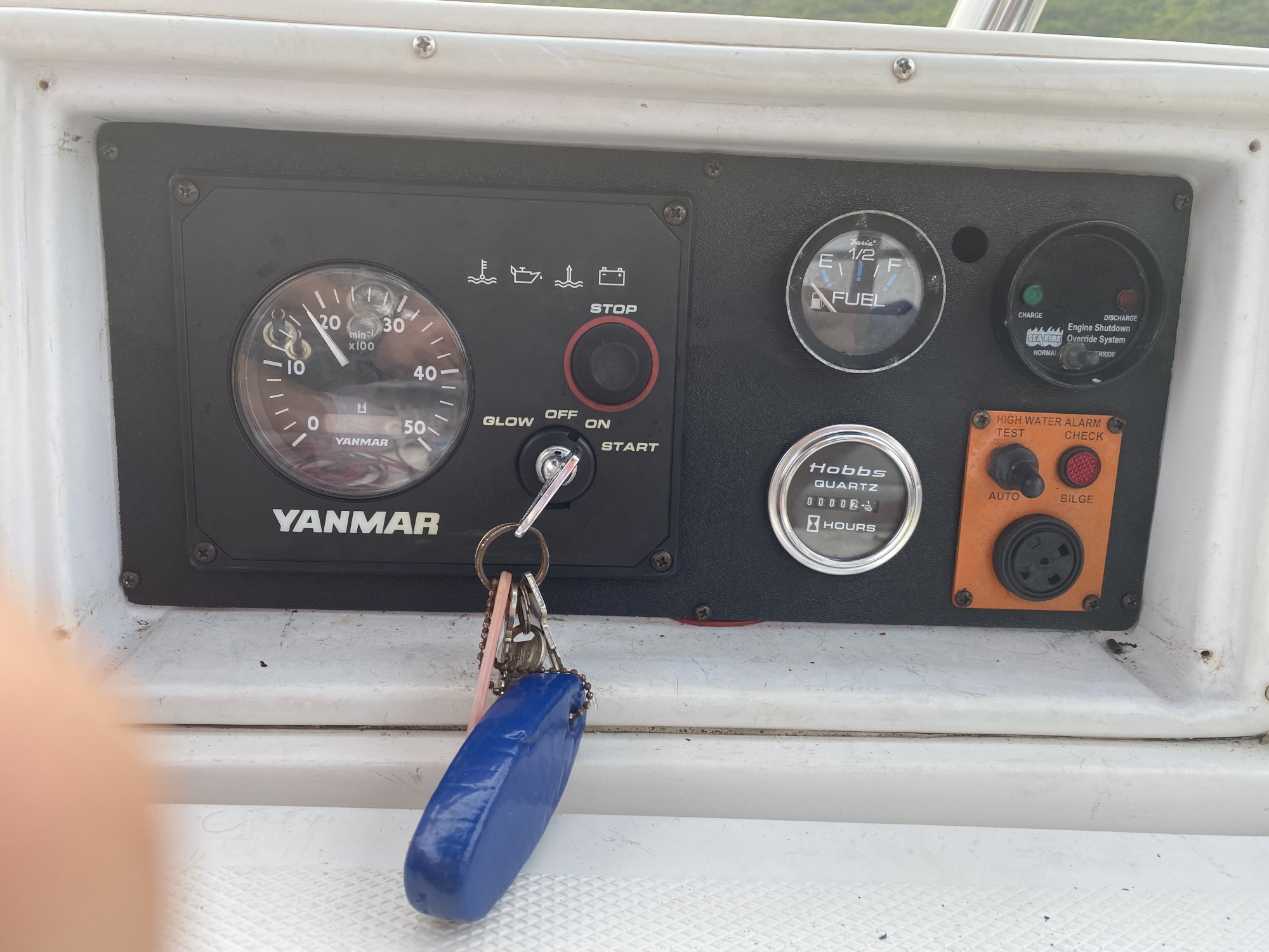

Here’s the setup on our hunter 33 - Hobbs meter connected to run switch
8,050
Beneteau 323 Annapolis MD
Aw, come on, Woof. All the rest looks so good, fix that insulation on that red wire/connecter.
24,949
Ron with the eagle eye for possible corrosion potentially shorting experience.
Acceptable Woof response. And you may never have noticed it. But now it is identified.
If it corrodes and shorts out the boat, or starts a small Fire :yikes:, who is it on?:cool:
Aug 21, 2015
15
Hunter 33 Hong Kong
Seriously, you gotta be kidding? You didn’t notice the multitude of exposed contacts by design. No I didn’t notice the tiny section of exposed 12v wire but I’m not going to lose any sleep over it..
