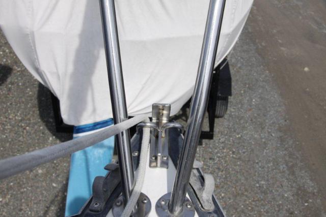

Hi folks,
I am about to spend the money on a roller furling and am unsure about the position of the lower drum unit and its proximity to the stainless steel bow pulpit.
- should the drum be installed above the tubing, and if so so king of an extension will be required?
- Any tips from someone that has completed this before.?
Jun 9, 2008
1,857
- -- -Bayfield
