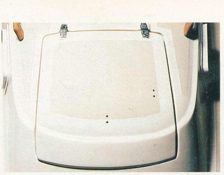

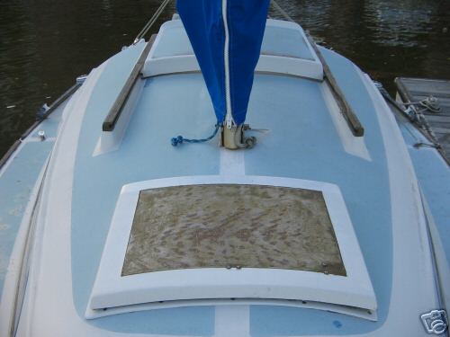

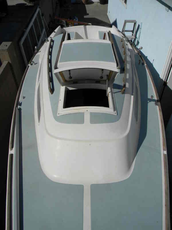

For the 1972 model the hatch was an option and was fiberglass with a fiberglass frame that was screwed to the top of the cabin over a cut-out hole. No real problem with adding an "after-market" generic hatch to a curved section of cabin top, except you will need to construct a frame to adapt the flat hatch frame to the curve. Most, if not all aftermarket hatches are pretty much flat and even the slightest bend to their frames will cause a poor fit and leaking.
You could give Rudy Nickerson at D&R Marine a call (508) 644-3001 he was the Parts Dept Manager at O'DAY (1973-89) and now runs a little shop supplying parts to O'DAY owners. However, he will not still have the molds for that old forward hatch for the 22 (or if he does.. I'd be VERY surprised!) but he may have some good advice for installing a newer hatch and maybe a better price than other suppliers.
The later (1977-83) models of the 22 had a nice flush-fitting forward hatch, but not really practical to try to retrofit that to your 1972 without major surgery to the cabin top.
You might get lucky and find soemone with a 1972-76 22 with the optional hatch and willing to make a mold for you..... labor intensive.... but should be easier to fit?
If it were my boat, I'd just find a suitable new (or used from a marine consignment/surplus shop) modern hatch and build a level base for it on hte cabin top. Not a sleek as the originals... but easier!
I've included pics of the original optional hatch (outside-closed, inside, and outside-open) plus a 1977-83 example.

That's great information as usual Sunbird. Boy that original hatch sure looks sweet. I understand what you are saying about making a frame that would allow a flat hatch to be installed. I looked into opening port holes but they are really expensive and it seems like just more places for leaks. Here it is not even summer yet and I can tell it is going to get really stuffy in that cabin so I think it would be worth the effort to add a hatch for ventilation. That vent looks to be about 25" square or something like that. A used hatch would be acceptable of course if it is in descent shape. Thanks so much. I plan to launch next week for the first time. Everything is ready but I am still fretting a bit over the actual launch ( the ramp angle etc.). I found two places to tie up as long as I want so future trips will not be a problem this summer. It's been a long cold winter getting her ready what with having to beef up the transom and replace a bunch of stuff. Wish me luck! Thanks again for all your help.
