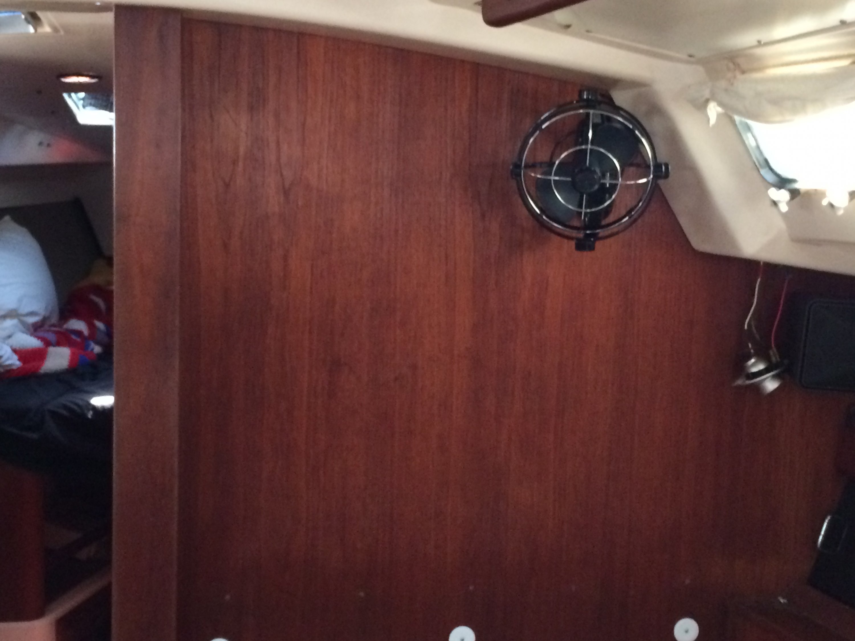

This spring I added a third cabin fan to our boat. Since this was in the aft cabin and a long ways from the dedicated fan wiring for the two fans forward in the boat, I installed a small terminal strip so it could share voltage with a nearby reading light. I have all "Hella" brand fans -very low amperage and good air flow. When the temp got over 80 inside a few weeks ago on vacation it really helped with sleeping at night. I used the little tinned "bridge" jumper pieces on the strip. With a cover on it, it's a tidy installation, if I do say so. :)
