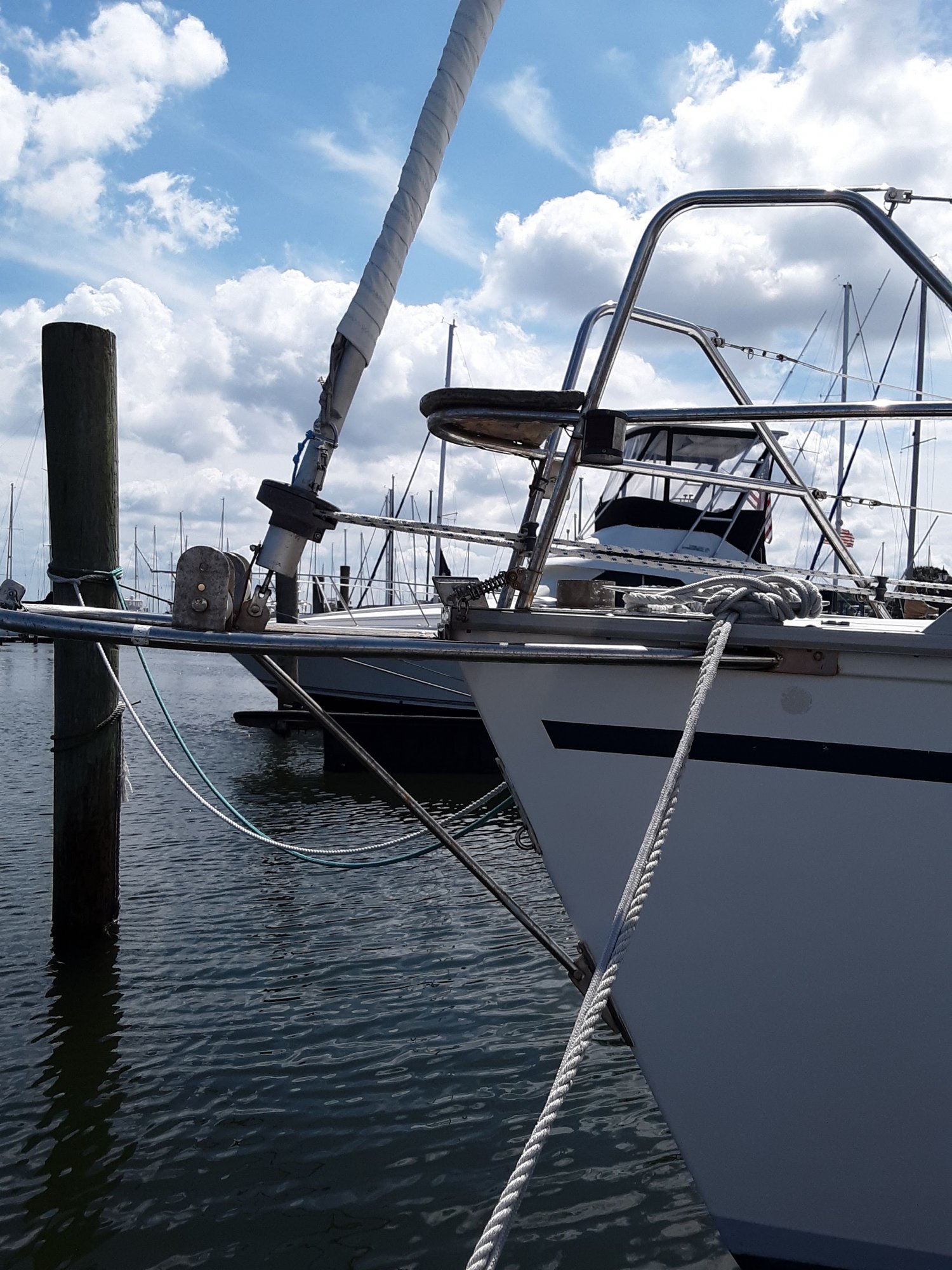

I would like to add a Bow platform to my 1984 H27, similar to what's pictured. Has anyone done this ? I would prefer to have a one made stainless tubing with wood center fill, but would consider a solid wood platform Anything in particular I should pay attention to ?

How you are going to secure the protuberance off the bow to the boat. Note we are not always sailing in calm waters. As the wind picks up and the waves start to form, think about the biggest person you know then double or quadruple that persons strength. He is trying to lift and wave your boat around by that sprit you are building.
How you connect the sprit and engineer the strength into that sprit is critical to the bow staying on the front of your boat.
Consider the backing plates, the fasteners, how all these will influence the way you use the compartments of your bow. Will the structure be sound in all four directions? What will happen to the bow should you contact the dock with the additional protuberance?
It is a slippery slope. Hope you are going to get a benefit out of this modification.
