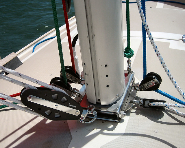

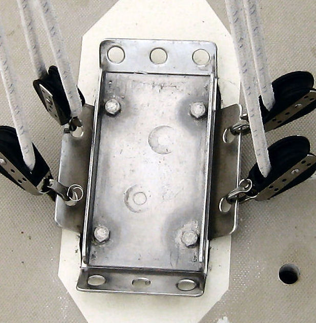

I have a Kenyon hinged tabernacle with a utility plate under it. The plate has tabs with holes in them for mounting sheaves, a vang, or a Cunningham.
I had a tab on the back of my plate in which I used to attach my boom vang to, but it interfered with my mast raising so I cut it off.
I really haven't gotten around to making up something permanent yet, so what I have be doing for the bottom of the mast vang attachment is using a short piece or 1/4" braid and tying it to the rear holes in the outer tabs.

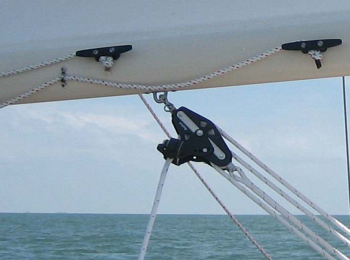

This may be a dumb question, but one thing I'm wondering is whether the vang is best with the cleat up at the boom or down at the mast step. I've seen pics of it both ways- below is one with the cleat near the boom.

I like the cleated end aft on the boom. Easy to access.
My boat didn't come with a vang so I installed an organizer plate at the base of the mast and an internally mounted pad eye on the boom.

That looks really neat Rich. I had to cut the back tab off my organizer plate. I hated having to do it but it was interfering with letting my mast lay down into my stern pulpit mast crutch. I'll come up with something more permanent to use other than a short braid line tied to the rear holes on the plate's side tabs.
